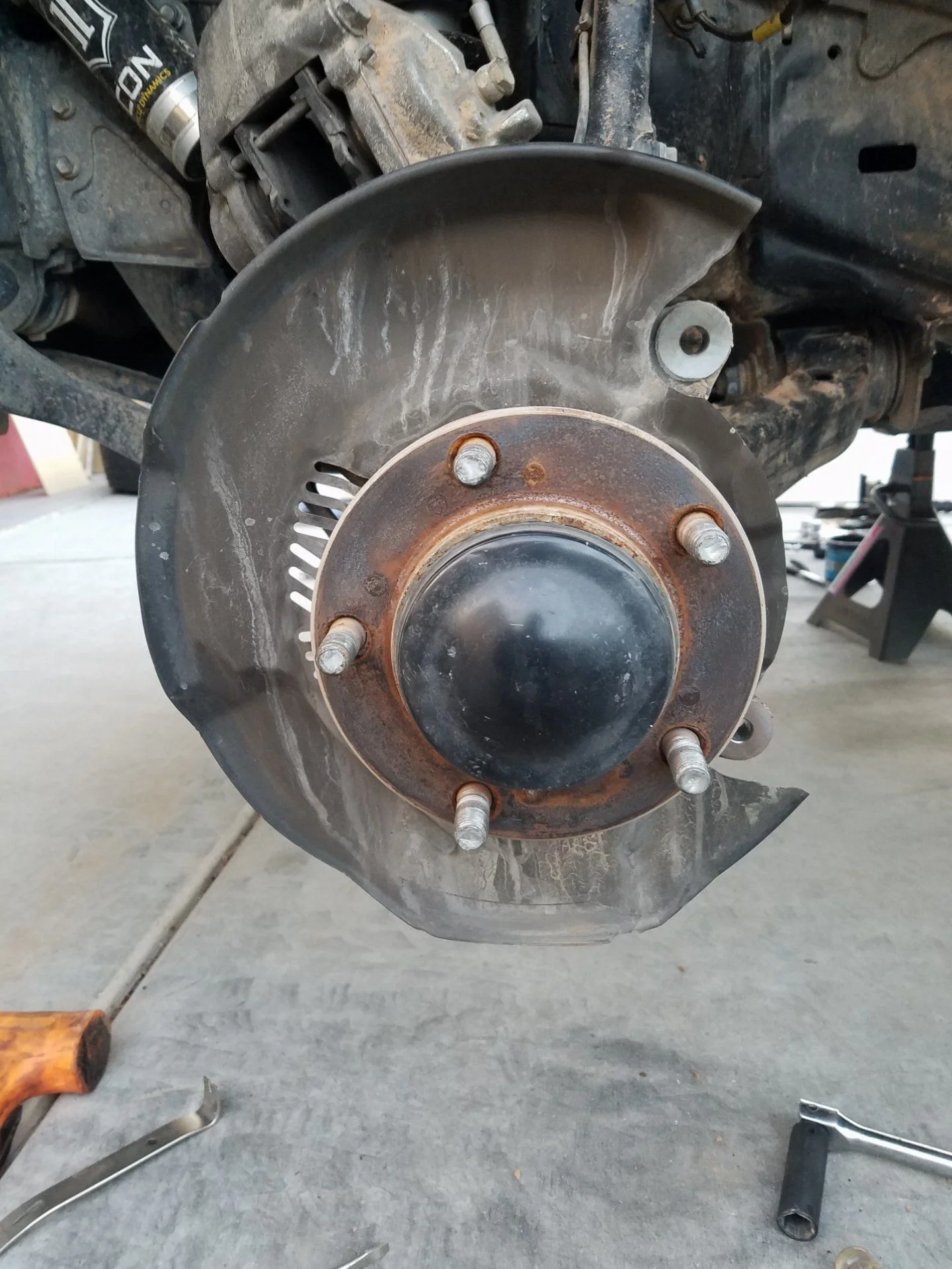

I just finished up a brake job this past week with new hoses front and rear. Typically, oem is the only route I go, but I've had good luck with Bosch rotors in the past so I went with those. For pads, Brembo ceramic pads. Honestly it was more of an impulse purchase on the pads. As far as hoses, I did oem in the rear and Stop Tech stainless lines up front. As others have mentioned, brake pedal feel on a 200 is not exactly inspiring. All of this and a brake flush, soft brake pedal is gone! As soon as you step of the brake pedal it's nice and firm.
