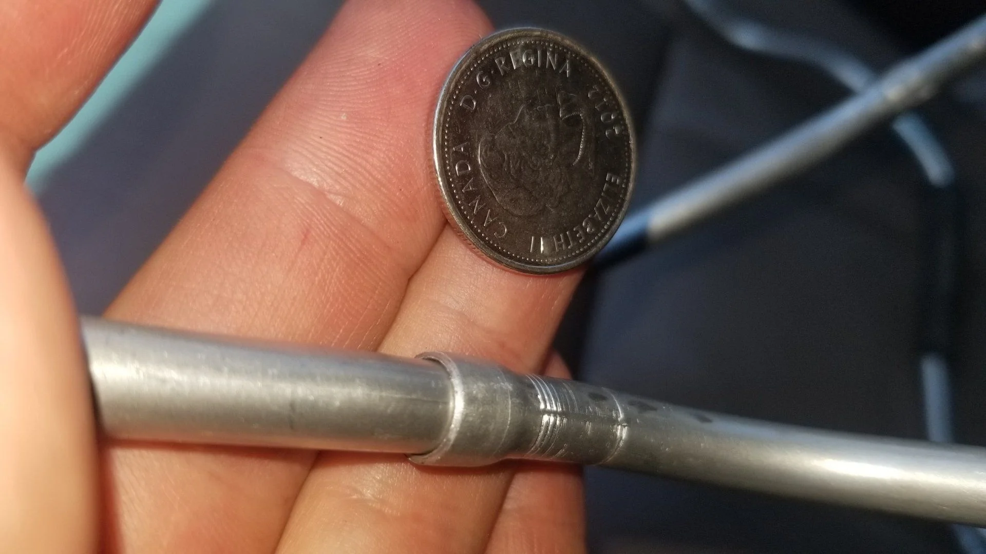

So this brings me to to my question. Is there anything wrong with putting an inverted double flare on the ends, and using a union (with 2 flare nuts) to join the lines? The union is much skinnier than the compression fitting so it shouldn't cause any interference issues. I checked and the aluminum line flares easily and flare looks great. This type of joint works great on brake lines that see up to 2000psi, so i dont see why it wouldnt hold on A/C line that will only see 200-250psi. I have done some research online and i cant find any evidence of people doing this type of repair on automotive A/C's. Is there a reason why?
Joint and the failed TIG weld:
Double flare on a test piece

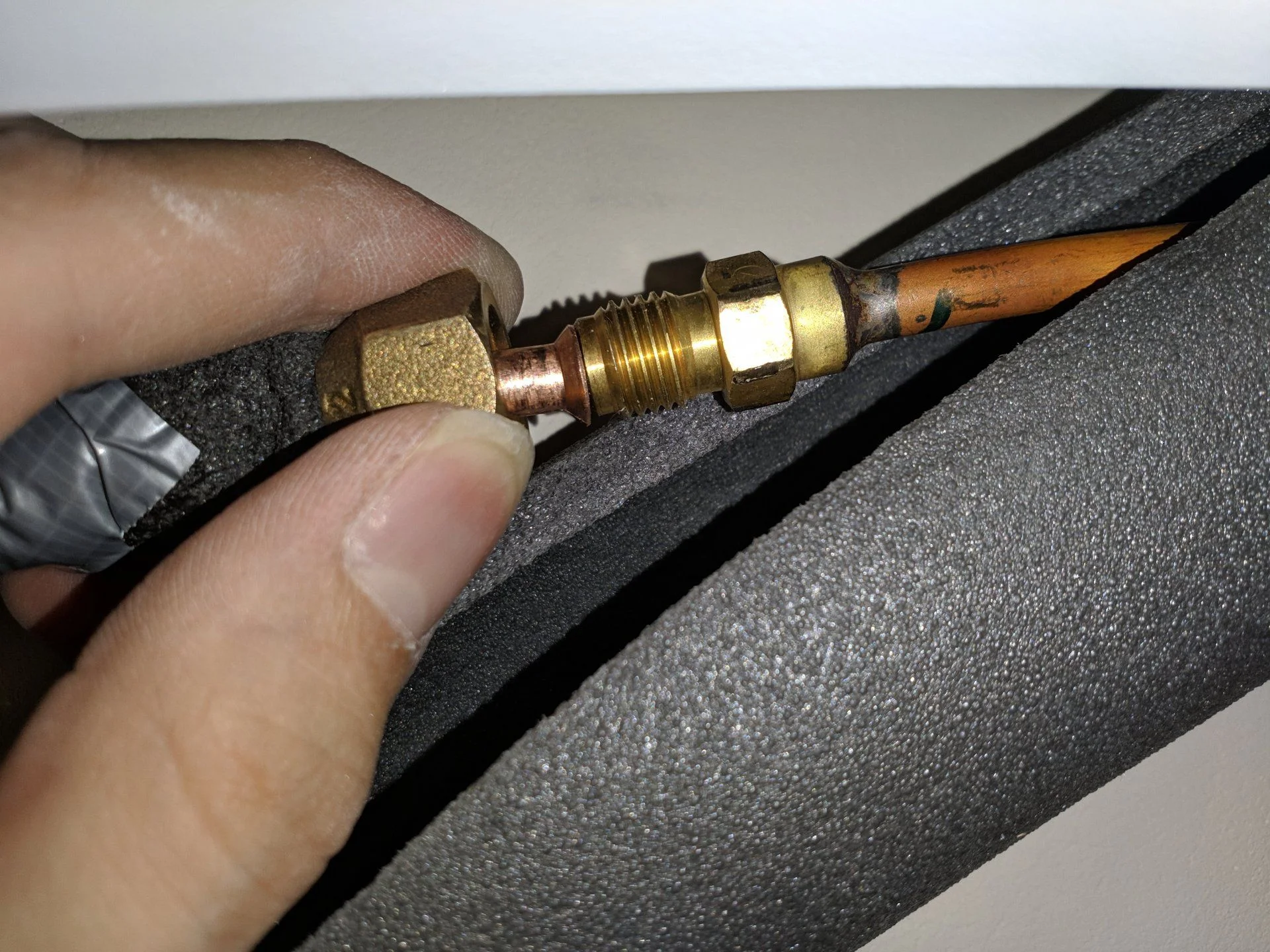

I connected my home conditioner with this. It was already pre-installed from factory, so I just made copper line (low/High)
I have seen HVAC guys use flare fittings on home A/C's, but for some reason i have never seen them used on Automotive A/C's. Im not sure why. That's what i want to find out... Perhaps copper lines work better with flare fittings than aluminum lines. Or maybe it has to do with the vibrations.

I've looked at compression fittings such as these, but as i said in the original post - one of the joints has to be in a very narrow place where a bulky compression fitting just won't fit. The double flare union that i want to try is skinnier and will clear, barely. So this brings me back to my original question - will it work?
I mean there must be some reason why A/C guys dont use this type of joint on cars and go with very expensive compression fittings instead. I just wanna know that reason is.
