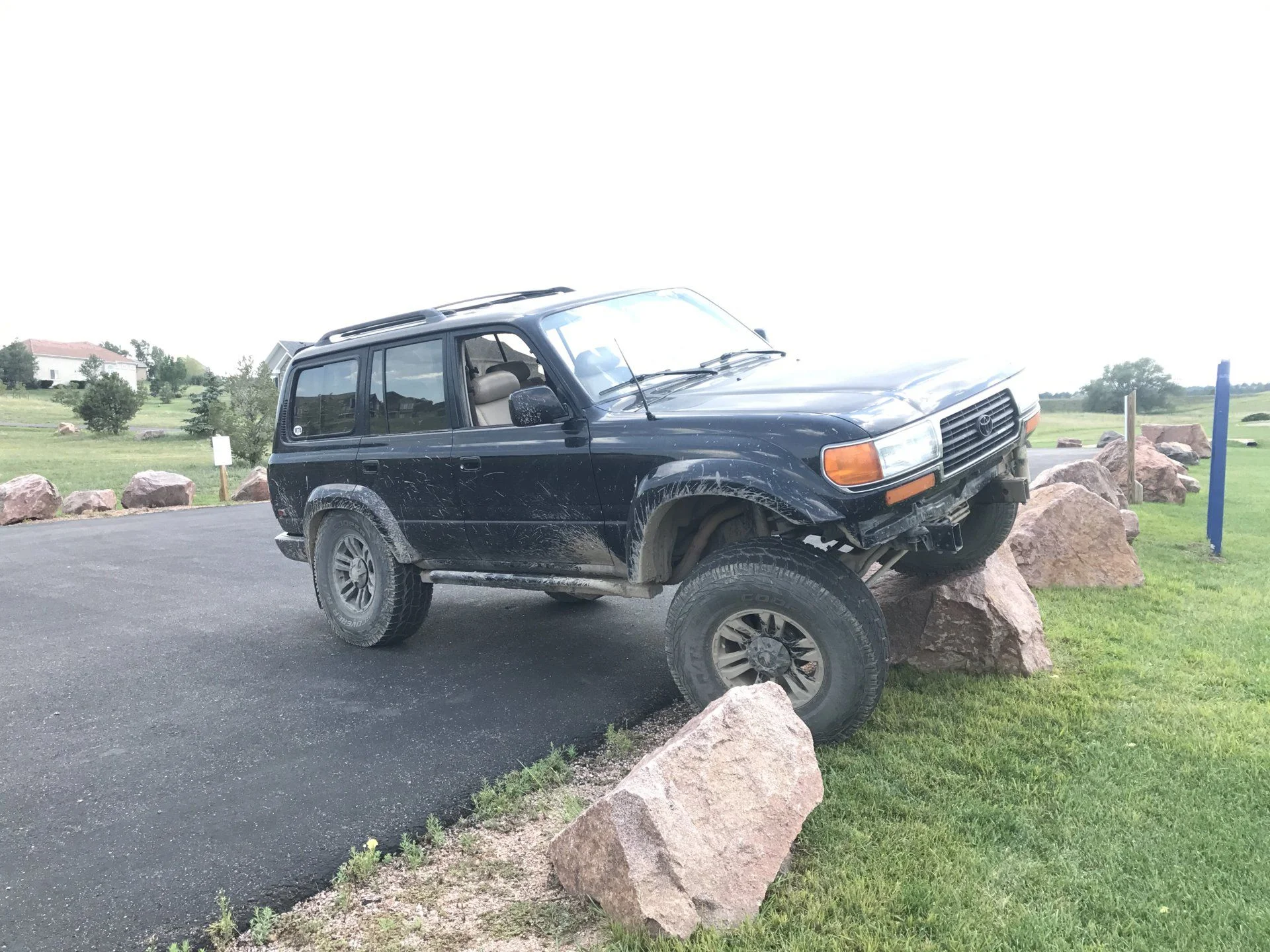

37x12.5x1
Attached a pic of how it rubs up front
