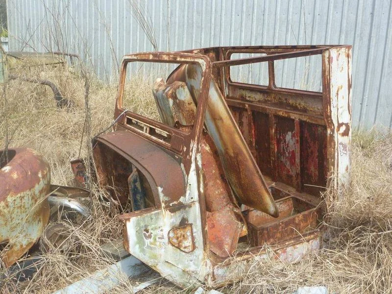

Found this 45 cab. What you see is what you get, but I think it is rare enough to give it some extra thought. So, I posted over in the 40 section and understand it is probably pre '64. I've never seen one of these fixed top, short cab 45's here in Australia before. Trucks this early are super rare here. So, before I go any further with this:
Question 1: Can anyone ID the exact year from what you see?
Question 2: Will any early doors fit, or do these short cabs use different doors? I don't think it comes with any doors and would need to find some.
Question 3: I'm 6'5" tall and I have read these short cabs can be a tight squeeze. Would this be a big problem? How much shorter are they than say the '82 FJ45 ute I used to own?
Question 4: Is the chassis these sit on the same as any later years or are they a different beast altogether?
Thanks, Lup. :)

63. I think the 64 had a bolt in plate where the w/s hinge is and early 63 have the welded in one.
Early doors might fit, but I think there might be a minor difference in the window frame. I'd have to look. FHT doors also had 'siucide' window vents.
I'm 6' even and it's very, very tight. I believe the number is three inches tighter than a removable top.
The chassis is the same except for the rear cab mounts. The removable top is right on the front hanger for the rear spring. The fixed top is a little forward
Nice piece of art. U will not fit in the cab. Sell it to someone about 5' 10.
Sent from my phone using IH8MUD
I didn't realize you were in Australia. It very well could earlier than 63. In the US 63 to 67 were the only years we pickups. A few had 62 production date. I believe the picked started even earlier in other markets like Australia. The hort wheel base ended 65 or 66. Those would be the easiest to work with. Possible to make a tray style using a troops frame. Something you could find over there. Other than the back of the cab the front would mount the same as any 40 series. You could do some custom work and stretch the cab or keep it as is then sell it after your finished. I right at 6' and my 45 with the removable isn't not something I would use on long trips.
Looking at the photo, it appears the windshield is one piece with the cowl which would make it very early very rare probably 61-62? Later they had plates bolting the windshield to the cowl where hinges would bolt in and once the tops were removable, they had hinges. The SWB and LV share the same frame, not sure about the rear cab mounts though. At 6'5" you would be crammed in there pretty tight. Hopefully Whitey will chime in here and shed some light.

So.... I picked her up this afternoon. Still has the vin tag too: 1962 fj45. I think I will start a new thread in the 25 section because she is so early after I take a bunch of pics tomorrow.

Hey mate, good job on being persistant and saving another rare 45. Tony you are spot on with the hinge detail and the year, very few of these early fixed top 45s exist. I have some rear sliders and weatherstrip for that truck! Pay for shipping and they are yours!! Cheers m8!

Well, to do this uncommon cab justice, I think I wan't to recreate a stock vehicle as faithfully as money and available parts permit. I'm going to need a donor frame for starters. Also missing front clip but it did come with hood and lid. Correct doors will be a problem. Bed will probably have to be fabricated from scratch I think although the few pics of these I have seen in Australia have flat top beds and not the styleside rounded beds the USA SWB 45s have - I like the look of those.
Parts availablity will probably mean mixing and matching early stuff a bit. It may never pass the purists test but I want the essence to be faithful.

Based on another thread, your truck is likely in the first 2,000 45's built.

I actually have the correct doors as well, but shipping would be a killer! I will get a quote on the sliders and rubber on the slowest boat to oz!:beer: You will likely have to shorten an fj45 lwb frame from 116 down to 104, oh uh those are inches!! AT least you can find them in wrecking yards!
