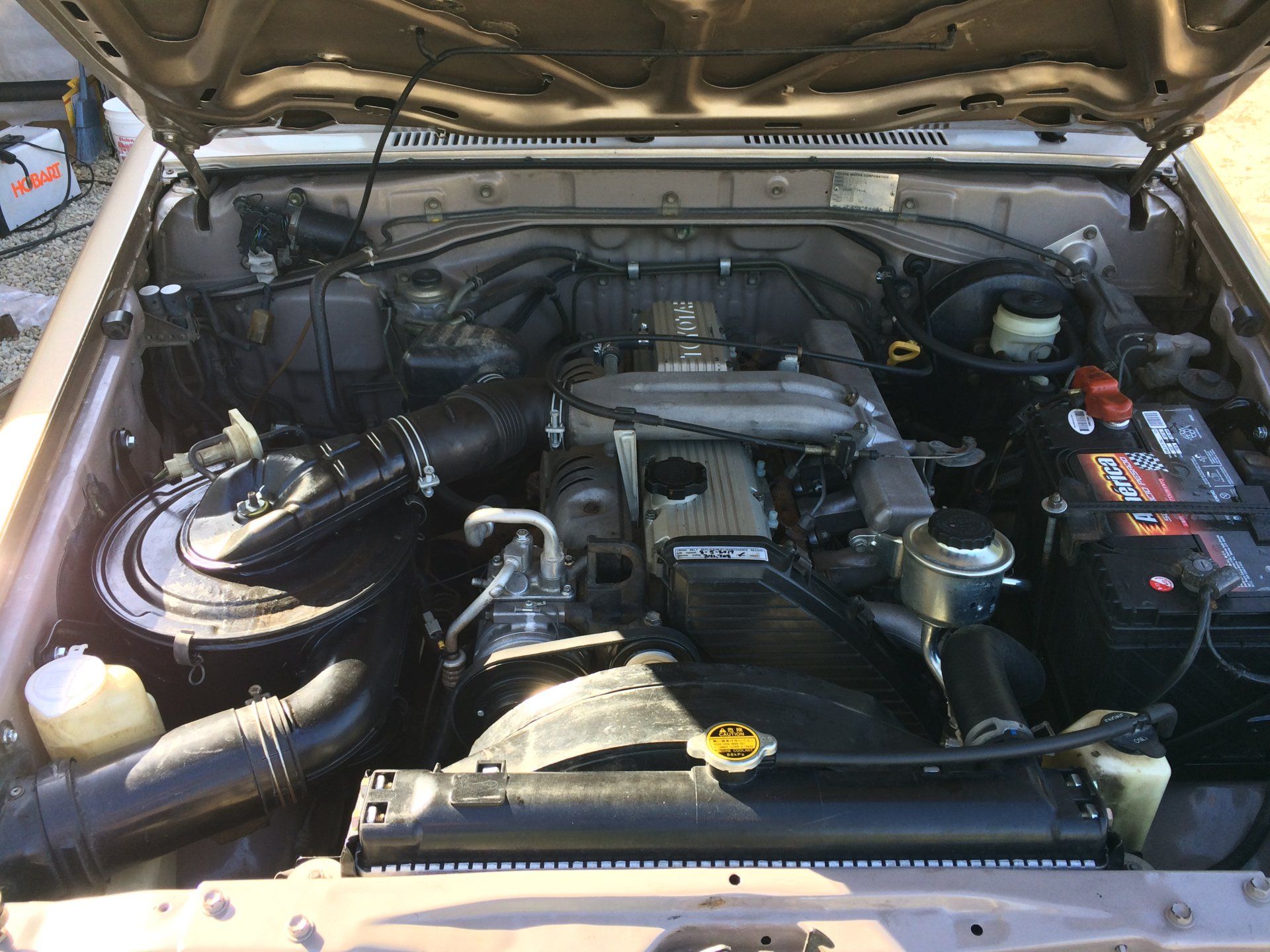

Put in Rotella 15w-40, new filter, and changed out both oil pressure relief valves. I installed a new intake manifold gasket and valve cover gasket as well. I had Castrol CRB 15w-40 in it before. Took it for a 25 mile drive this evening, it seems to like the Rotella. The Rotella is what I have ran in previous diesels but in Latin America the Castrol was the best I could get.
The Cruiser is happy! :grinpimp:

How do you know your engine likes a different oil ? I would have thought Castrol would make oil as good as any other .
Technically I don't.
It does sound great though with the Rotella in it. It revs super smooth & idles nice and quiet so it seems to like the Rotella.

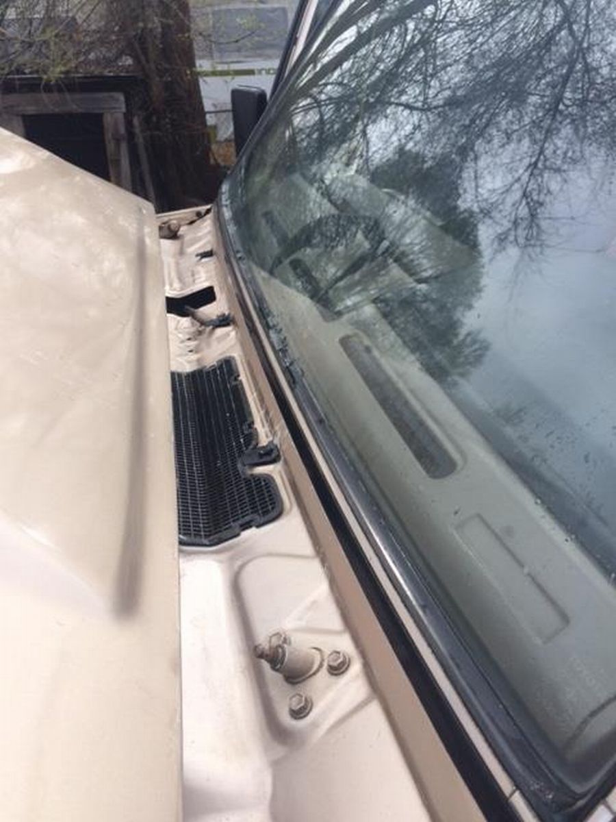

I have had some rattles in my truck. The console was one but it has been fixed. The cowl was another. So I installed all new clips and a new seal and this rattle is gone.
Another place I had rattles were the door windows when the windows were down. So I replaced the runs as well as the inner & outer window wiper weather strips. No more rattle now and it is super nice, like new.
That was the last of them, no more noisy rattles on this truck! All I can hear now is the stereo or the rumble of the diesel.
Hello,
Engine operating temperature, idle speed and noise indicate whether an engine likes oil or not.
Engine temperature can drop some 4 F / 2.22 C with a good oil.
Noise may go down 2 to 5 dB, but this is tricky to measure on a diesel engine.
Idle speed increase varies from engine to engine.
All of the above results from less friction between engine components.
Juan
