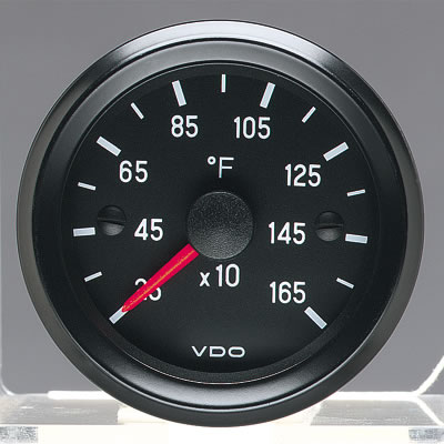

I've read a lot about 3b overheating and how much the stock heat gauges are crap. I've also read a lot on this forum that the add of a pyrometer is a must.
Therefor, before I go out there on my own looking for a pyrometer, wich one is the best?
I guess I'd mount it right under the radio with additional switches I could install later on.
Wich one do you suggest I go out for, and where could I get it?
On the internet perhaps?
Any websites anything would help.
Thank you
Matt
I run Autometer gauges, I have tried others but always come back to autometer gauges. Here are a few things to look for even with autometere guages. Buying the multiguage cheap pack (yup autometere does have those) you are wasting your money this is the cheap line and they are not that great. For the most part you get what you pay for with gauges. Depending on if you are running 24v or 12v you should check to see witch pyro you are buying there are some that still require 12 volts to run the guage on the pyro and others do not require 12v, I have found that ones that do require 12 for the pyro are more responsive and seem to be a little more accurate. I also make sure to look at the face of the guage and range it works in, there is no point in getting a boost gauge that go all the way to 50lbs when you will not go past 15lbs, better off to get one that goes to 20 or 25 that way the increments are easier to see and more detailed for your application. The same is true for temp gauge, on the 3B or any diesel you are going to be working in the 170-240 range where a gasser would be more 165-220 (just and example here) so get the gauge accordingly. Oil pressure is the same for 3B you want something that will go low as well as high maybe 10lbs up to 80lbs. Lastely my advice would be don't go cheap on aftermarket gauges spend a little extra if you can and buy the better gauges :)

a pyro reacts much quicker than an elec water gauge, you can litteraly be i the 1200F for minutes before the water gauge even moves...
damage could already been done...
cheers
