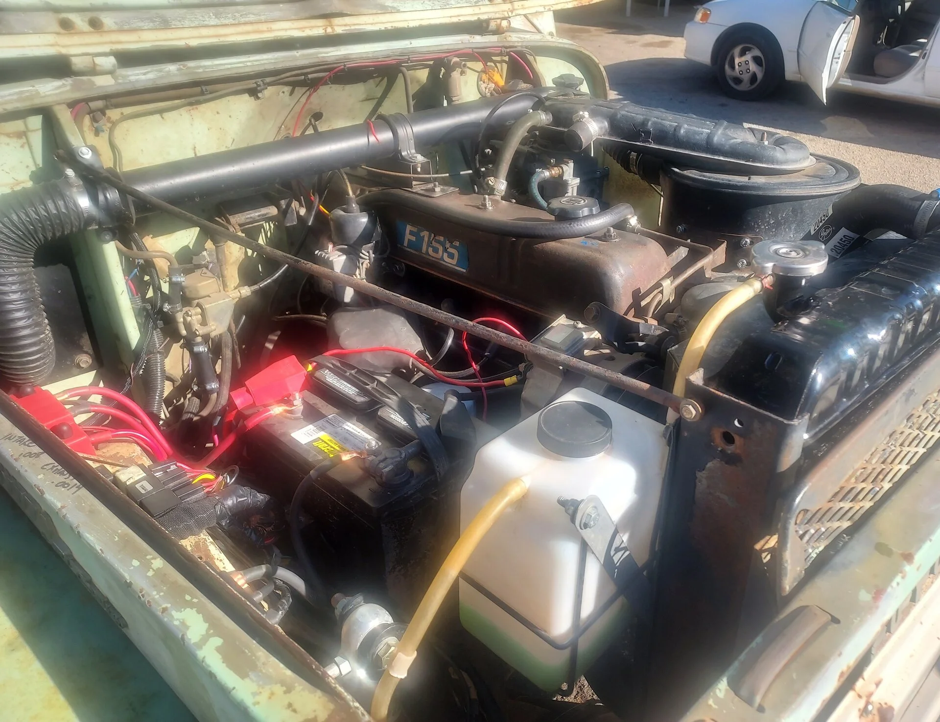

You may want to consider a sealed battery that can't leak battery acid in case of a roll or flop. Also, I don't see a battery hold down.
Its a Ruffstuff battery tray I took the top hold down off while I'm working on it. During the race I have my good Blue top Optima battery.

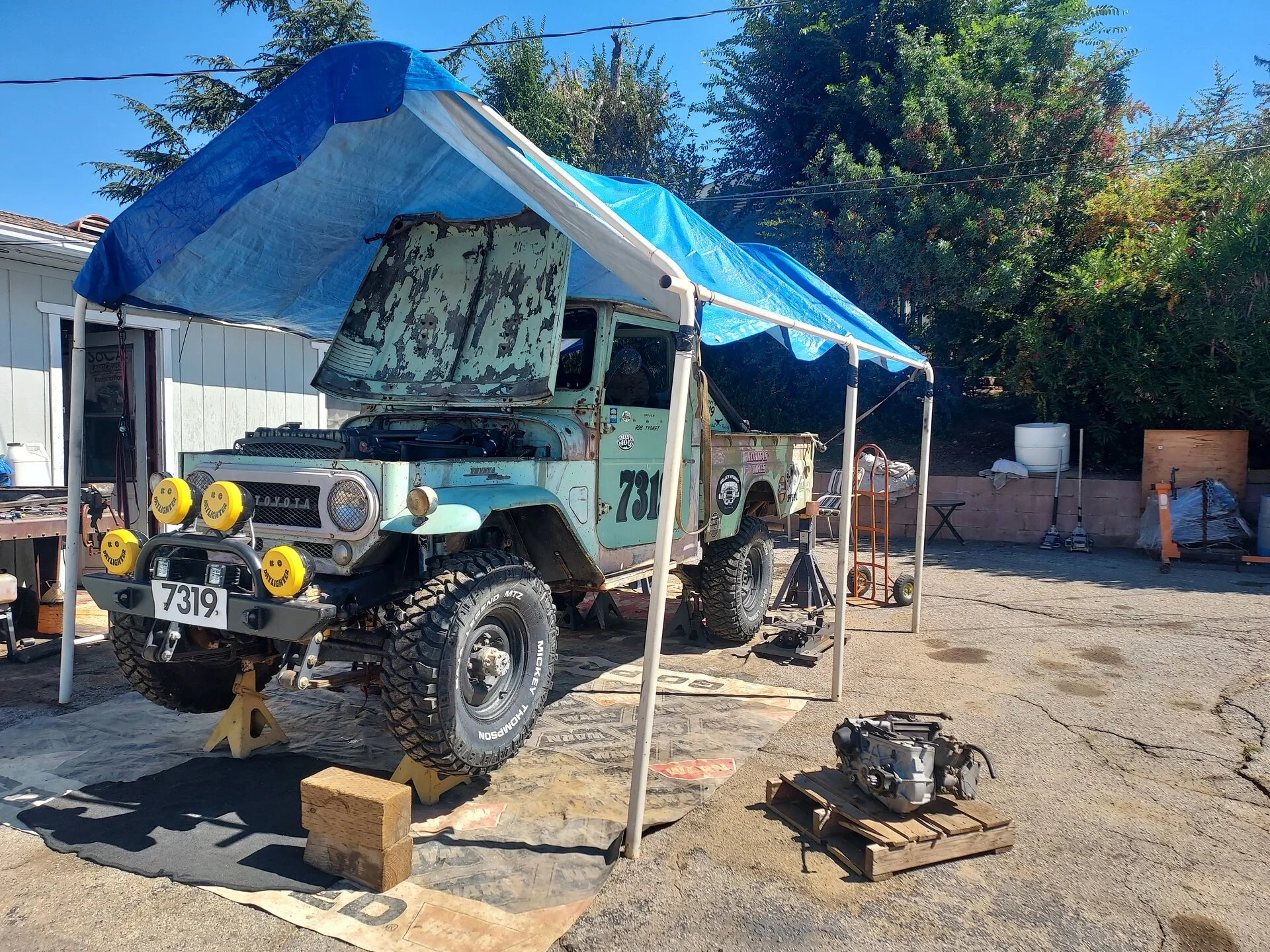

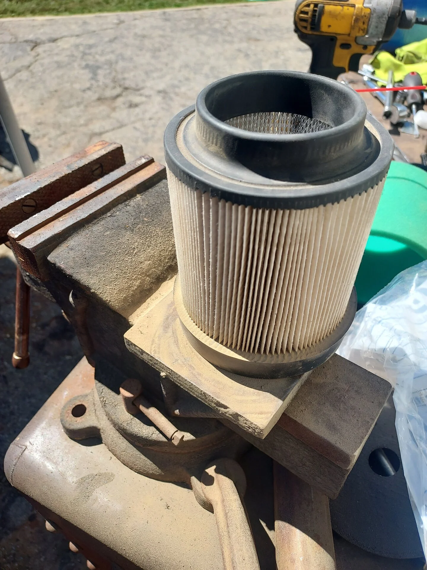

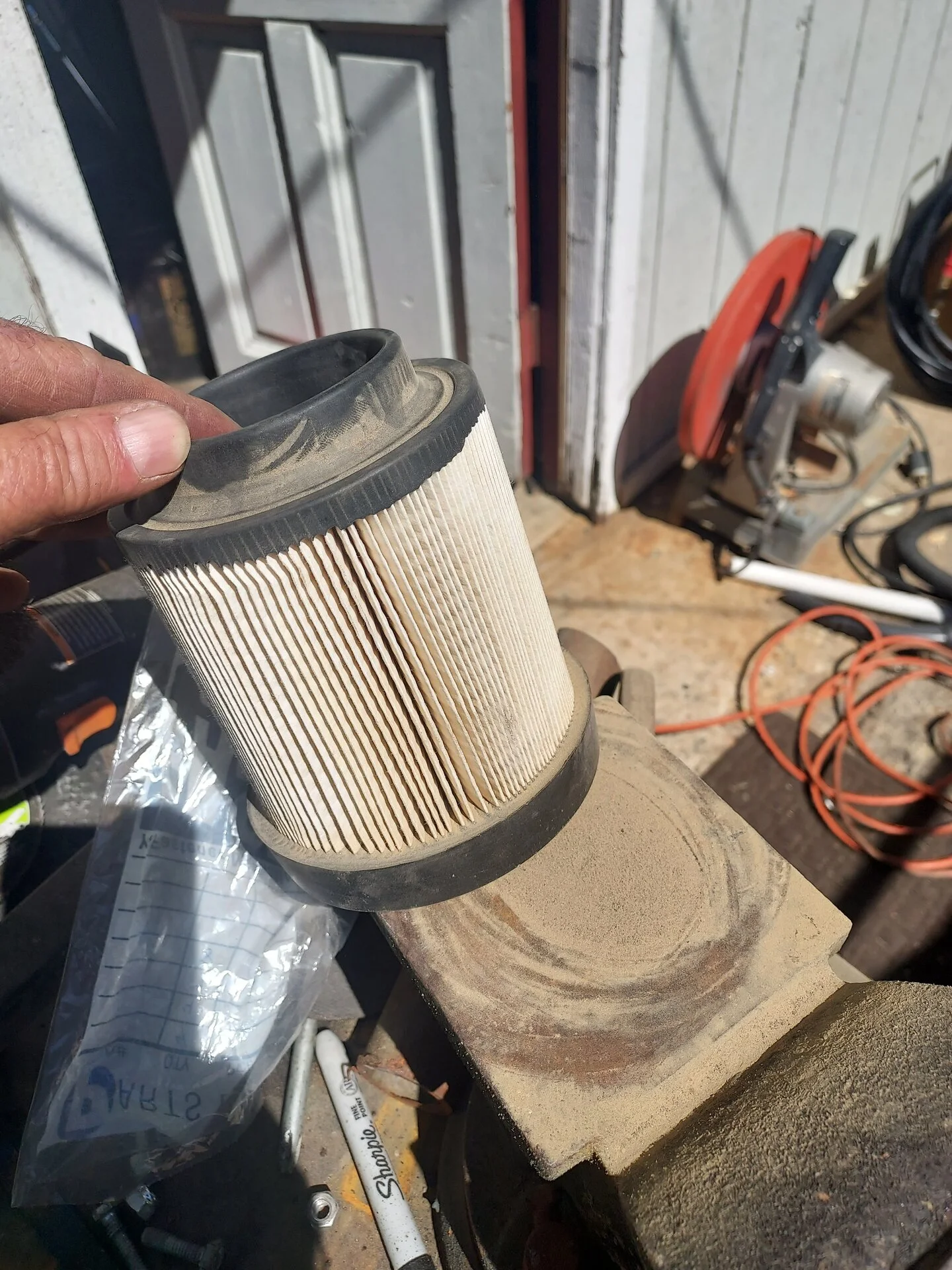

Finished everything on the motor. Runs fantastic. Friday some of the guys are coming over and we can get the trans and T case installed. I got around to pulling the in cab air filter. I am really glad I installed this So in the future we will keep at least two at each pit and every stop it will get changed.

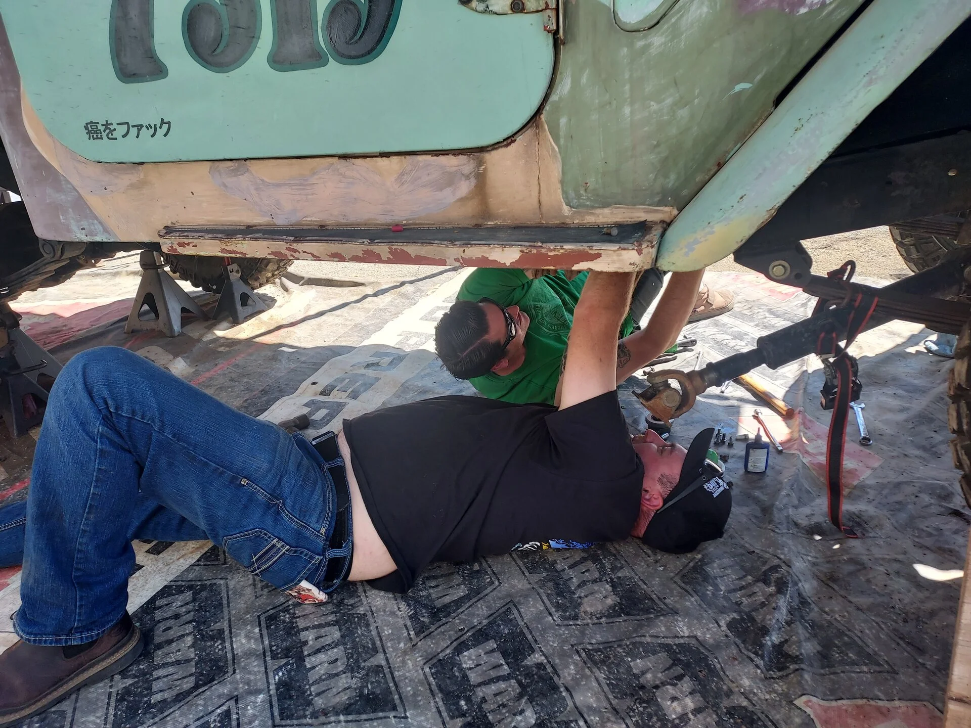

Had a Great weekend. Some of the guys came over last Friday before he Off Road Expo and helped me get the trans and T case installed. Everything is coming together and I shoud be ready for our first shock tune October 21st. Saturday we had a KOH Rookie weekend at the Off Road expo lots of workshops and vendors ( as you can see LOL ) I should have the 45 driving again by tomorrow then Sunday get the new Deaver springs installed. I was invited to co drive for Mick Henson a fellow Rusty Nail team mate at the Nationals in Lake Havasu October 27th. We have a plan to pre run in the 45 and get some exposure plus this would be a major shake down run then run the race in his 1985 Toyota Mini truck

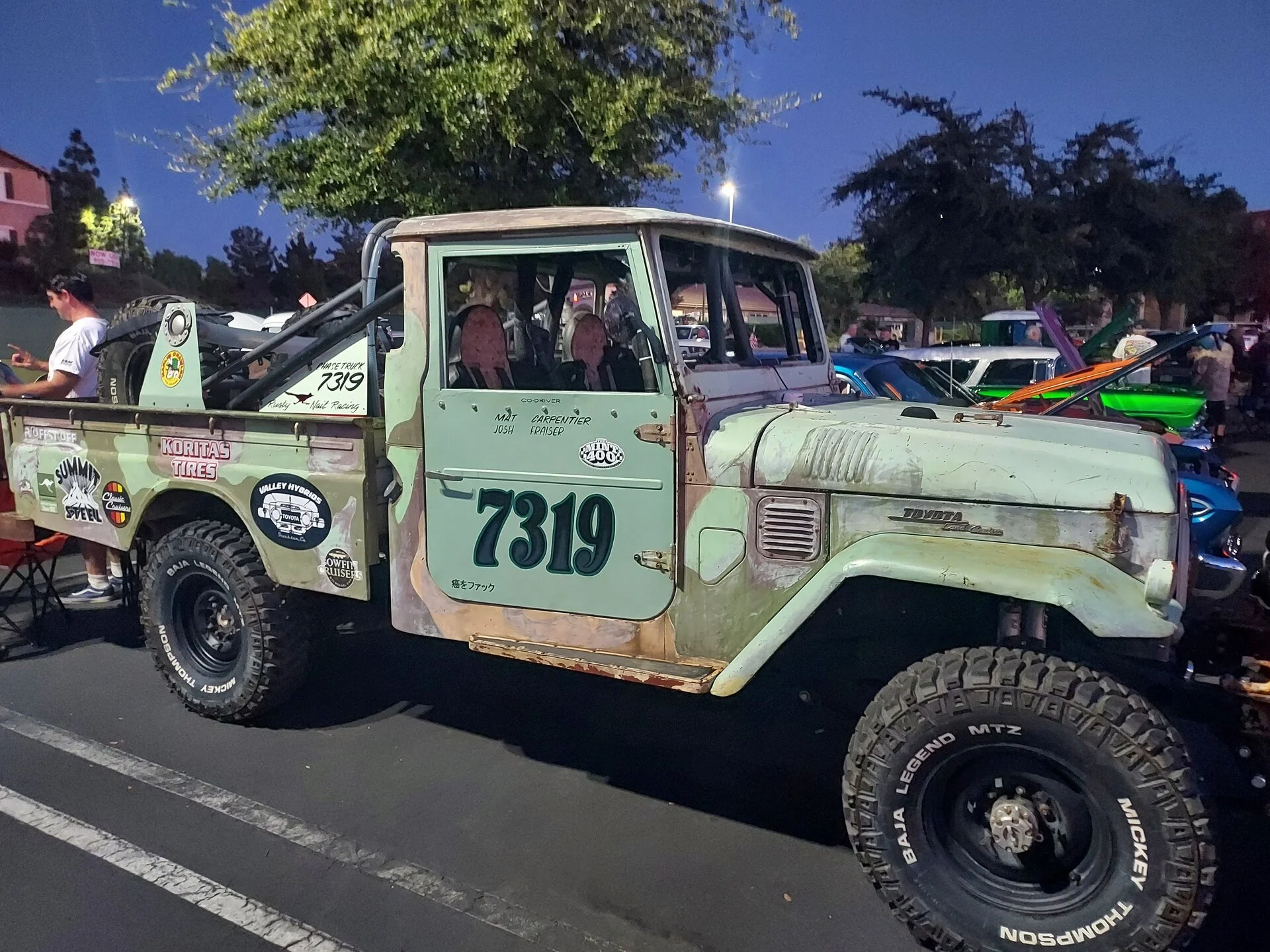

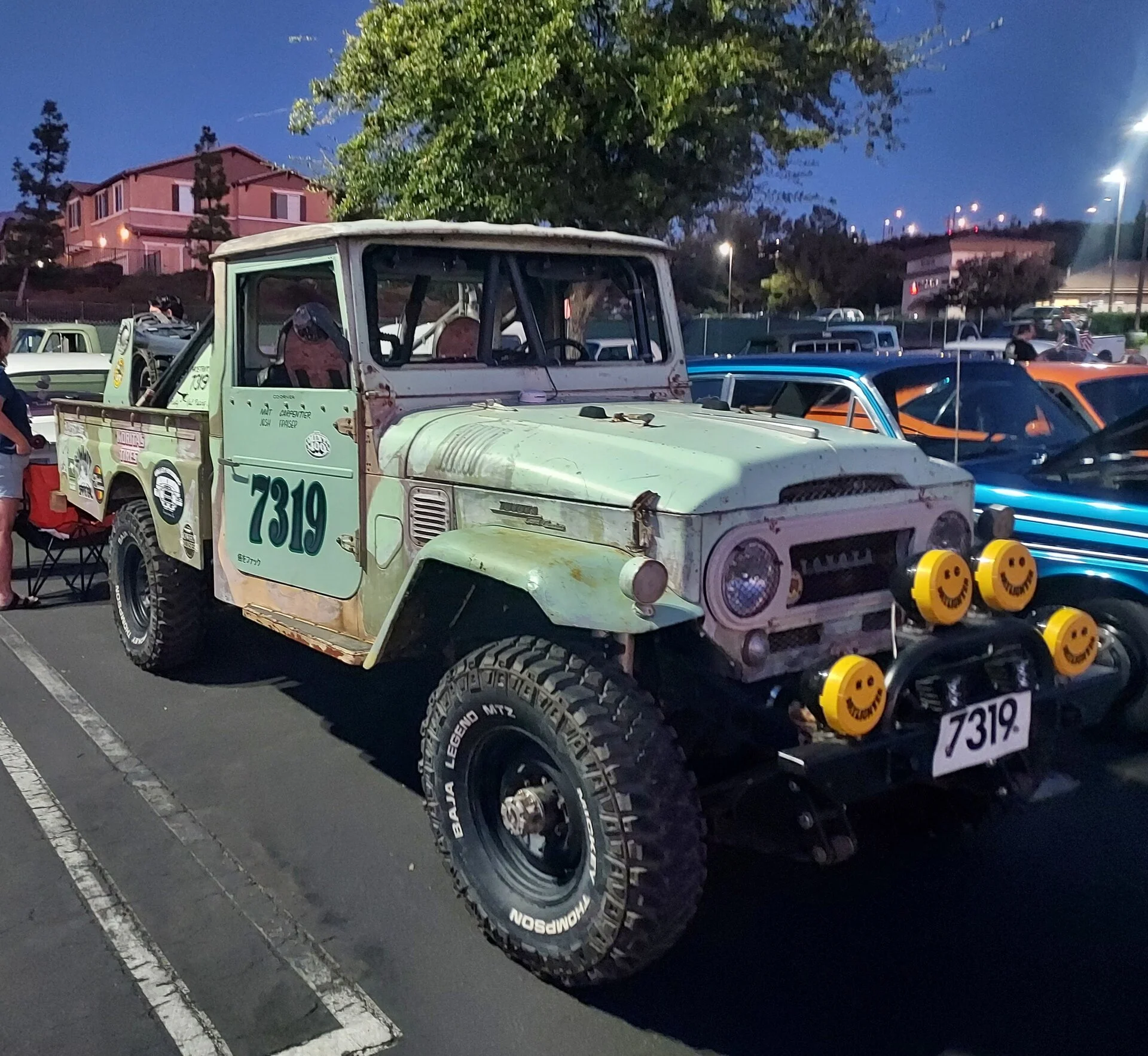

Awesome day the 45 is up and running. Went down to the local car show tonight. I have some fine tuning to do tomorrow So far everything looks good. I took my buddy for a ride and he said " I would have expected more power from a new motor " LOL Bro were loaded with a ton of steel cage, tires, 22 gal of fuel and were going up hill. She's running fine

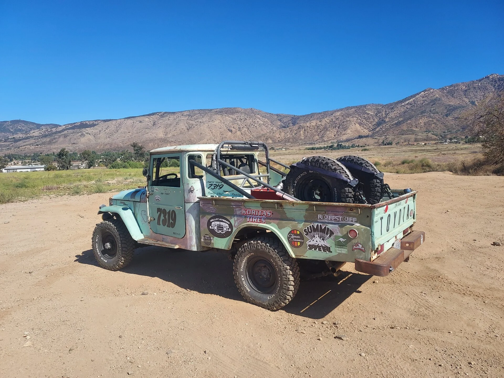

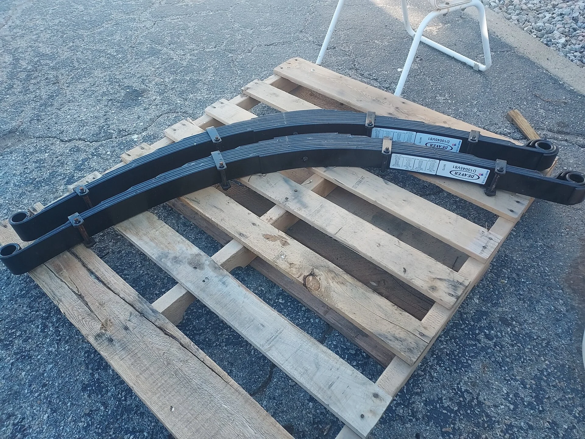

Awesome day today. I finally got the new Deaver race springs installed. What a difference. Ordered new limiting straps and should start major shake down runs this weekend. Big things are coming up in a few weeks so stay tuned

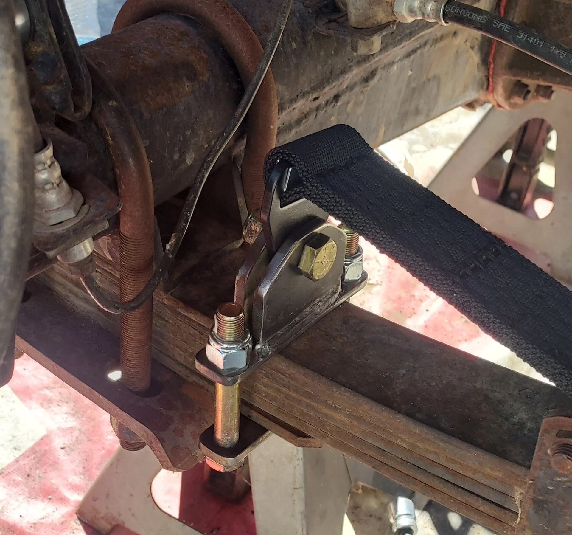

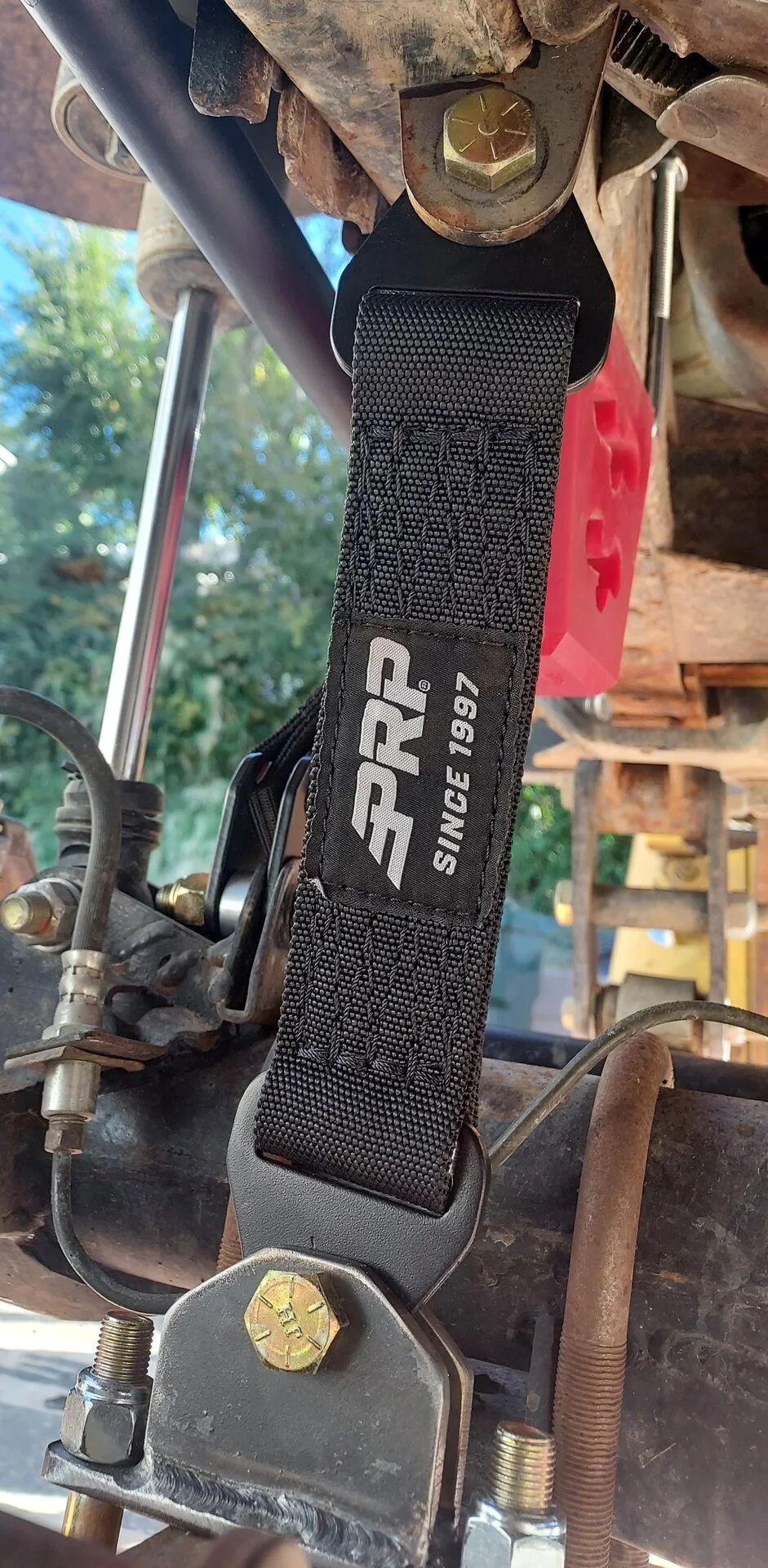

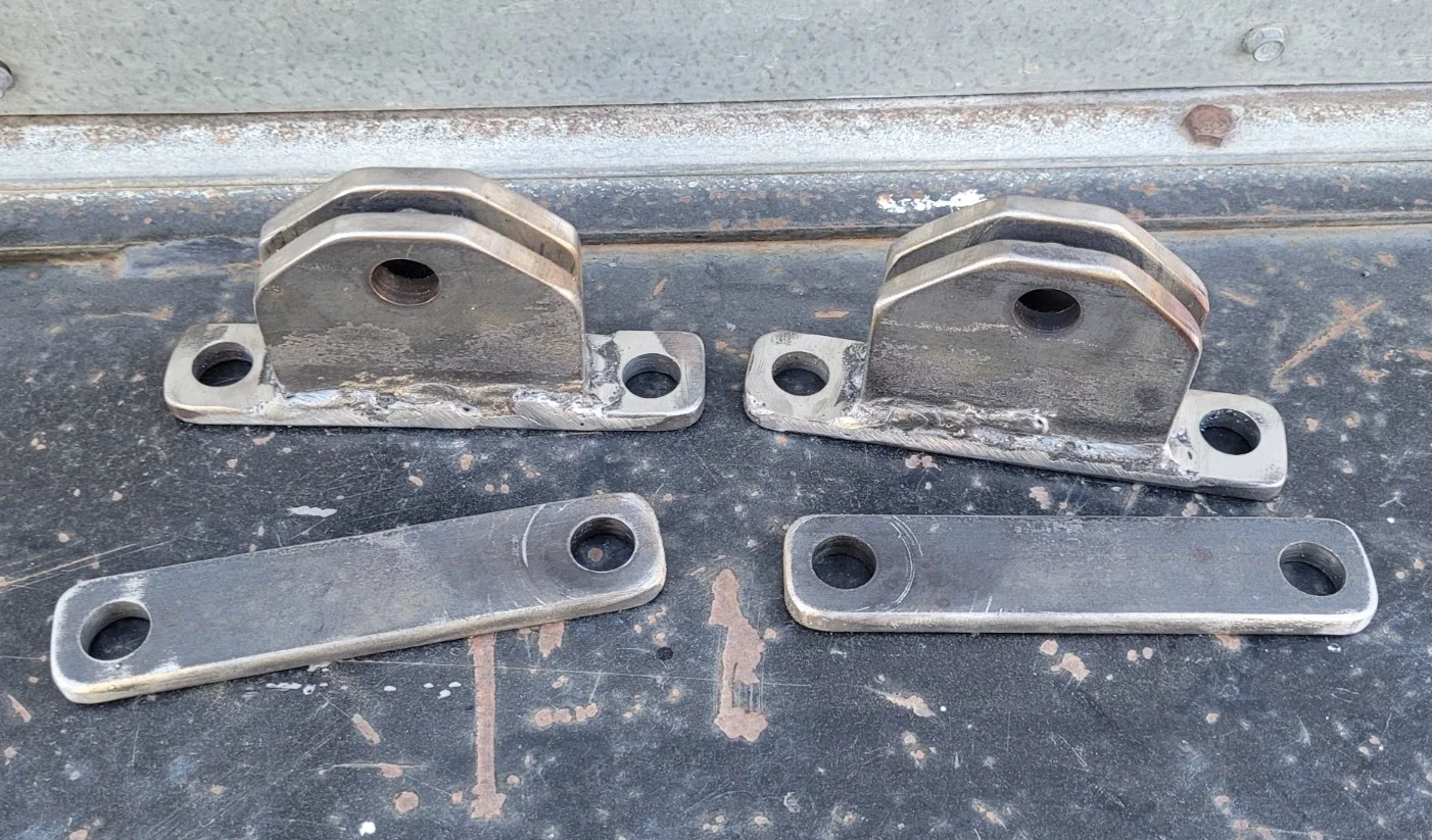

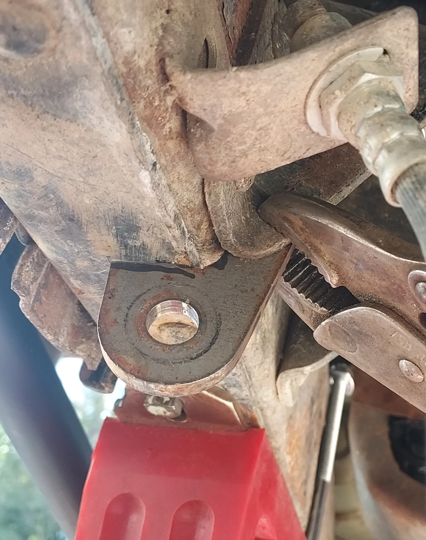

Old limiting strap design just wasn't gonna work so we're giving this a shot. Teammate Mick Henson came up with this. I am doubling up on the upper strap brackets welded to the frame. The clears everything around the steering and allows us the run a longer strap. One more day and we need to be loaded on the trailer for our last King of the Hammers Rookie weekend.
