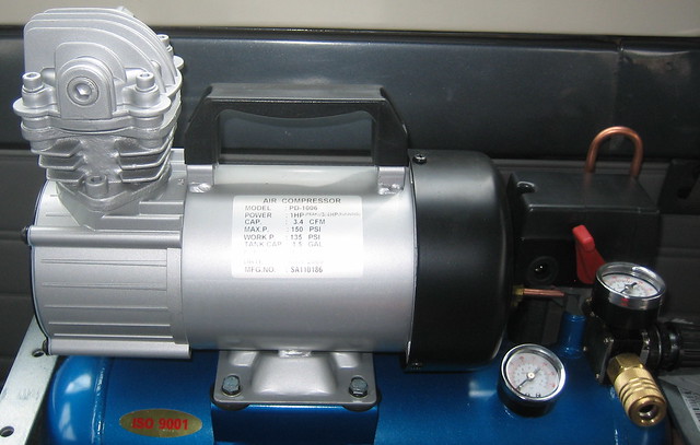

good price, free shipping, excellent. I get it home and it looks different, the head looks a little smaller than that of Robert's and what I saw online. I check on the one I bought and look at the picture and it is different, so I have a look at the part numbers for both mine and roberts and turns out I got a slightly less heavy duty unit. His (and the older PUMA PD 1006) had a larger head with a cylinder liner in them. This one has a smaller one with no cylinder liner. The output is supposed to be the same but the construction ends up being different and if something wears out I'd need to change the entire cylinder and not just the liner. So I've got an e-mail to the seller to find out why the change. Anyone else notice the same porblem?

I think Mat is comparing 2 12V compressors, though it's interesting to see the 24V version.
This is the (I guess older) 12V version. I've brought up 5 or 6 of them and they were all the same - but that was a year ago.
Actually it's different still, can't take a pic of it as it's burried in my truck right now. Both the 24 and the 12V pics you posted are different than what I have.
I received a response from the company that I bought it off and they said this was the new 12V model. Both the 24V and the 12V that you have there are still 2 part housings (a cylinder head and a cylinder lining). Both have cast steel housings, the one I received has an aluminum housing with no lining. I guess they are getting made cheaper or depending on the source where you purchase there are different versions.
