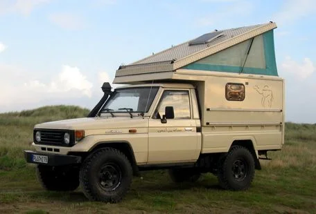

Just having joined all of you in the adventures of land cruising, I have found myself last month stranded in France, whilst being on the way to northern Africa, hoping to make it into the darker corners of African culture. Anyway, the dear old HZJ75 with an enormous little hump on the back, our little house,
right at the border of Switzerland and France, she would not go another inch. Well, when we took everything part, it is the old; it seems problem of the shaft splines having worn down, even on this heavy-duty version of the HZJ
