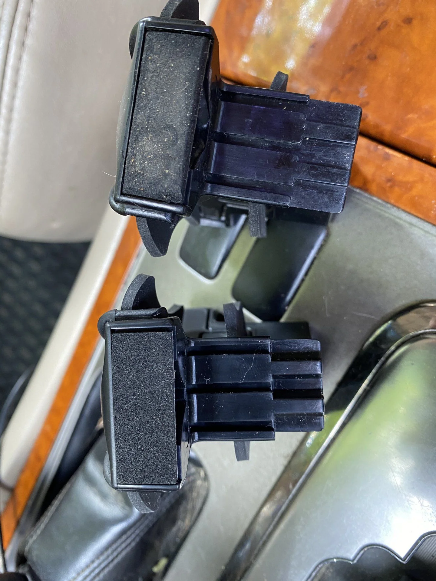

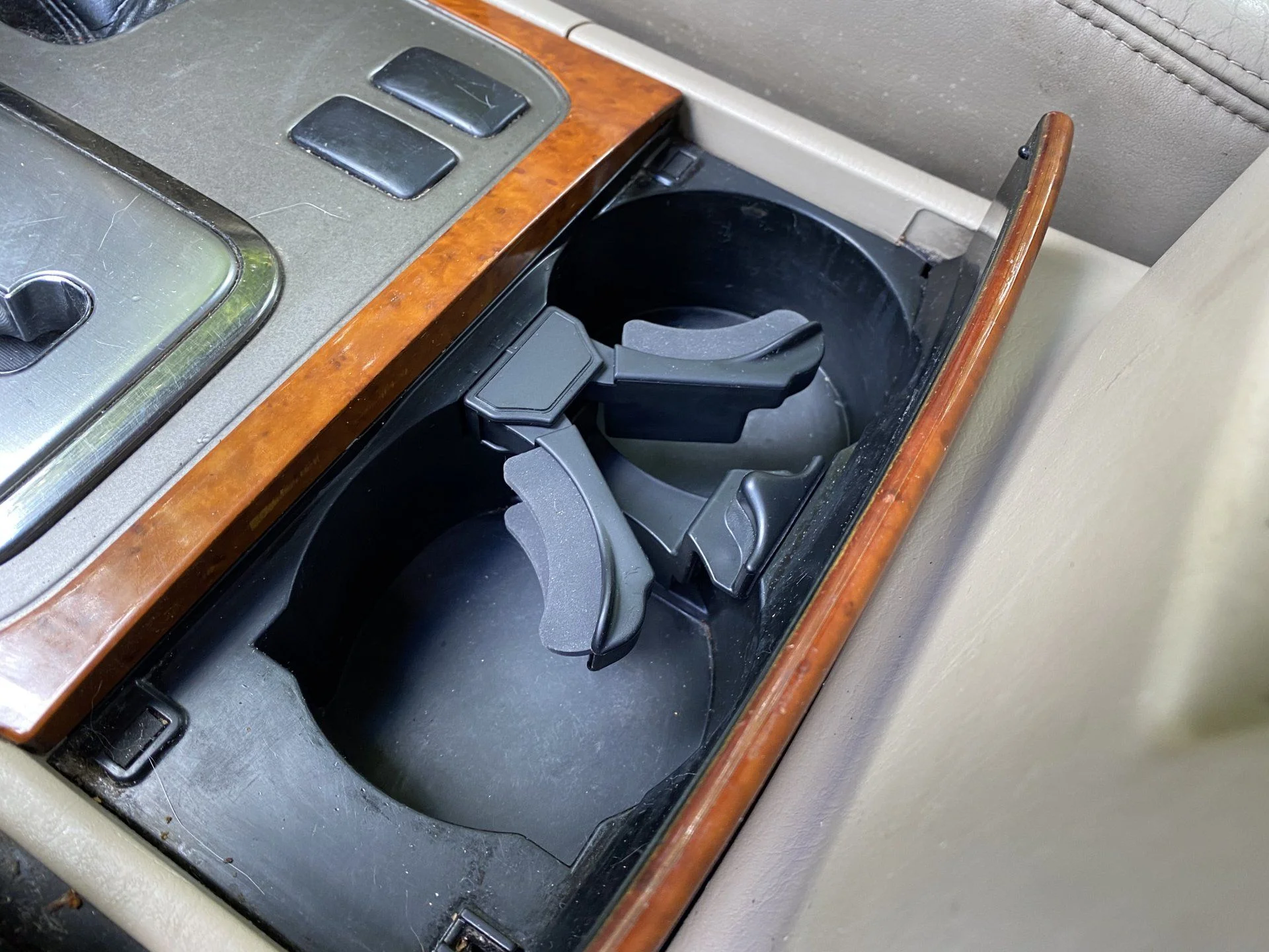

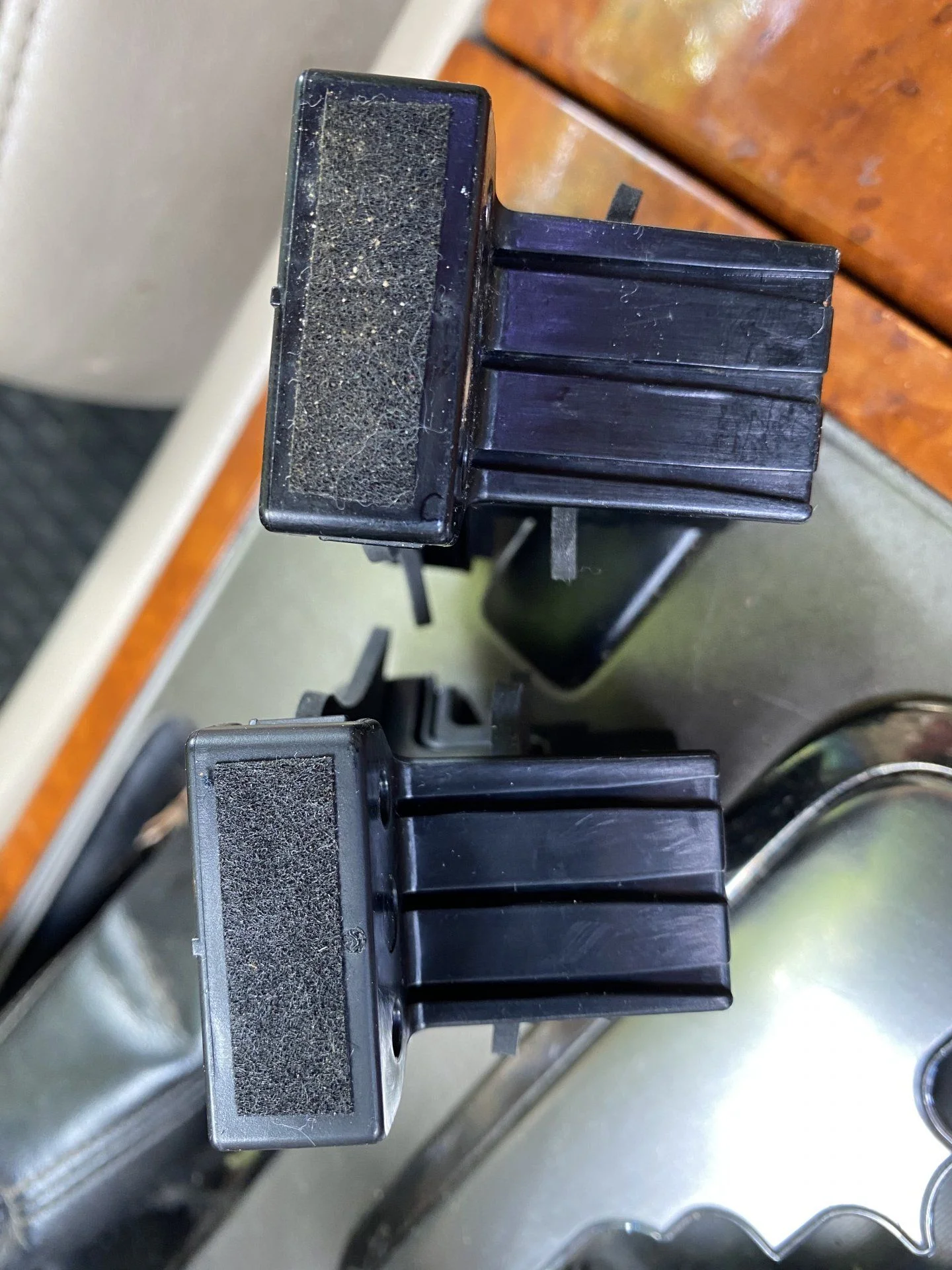

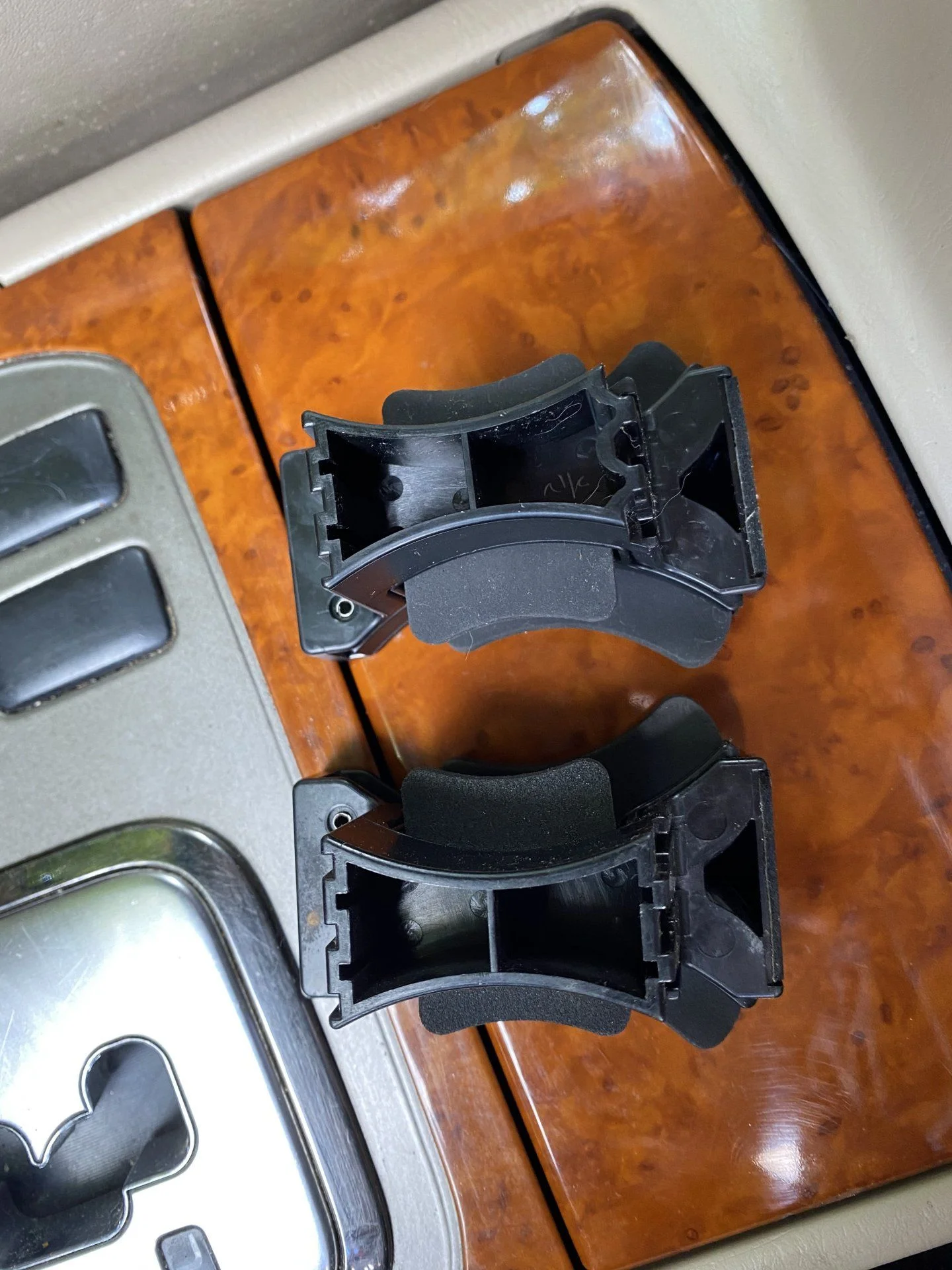

Old broken insert:
New LX570 insert:
Side:
Other side:
Bottom:
