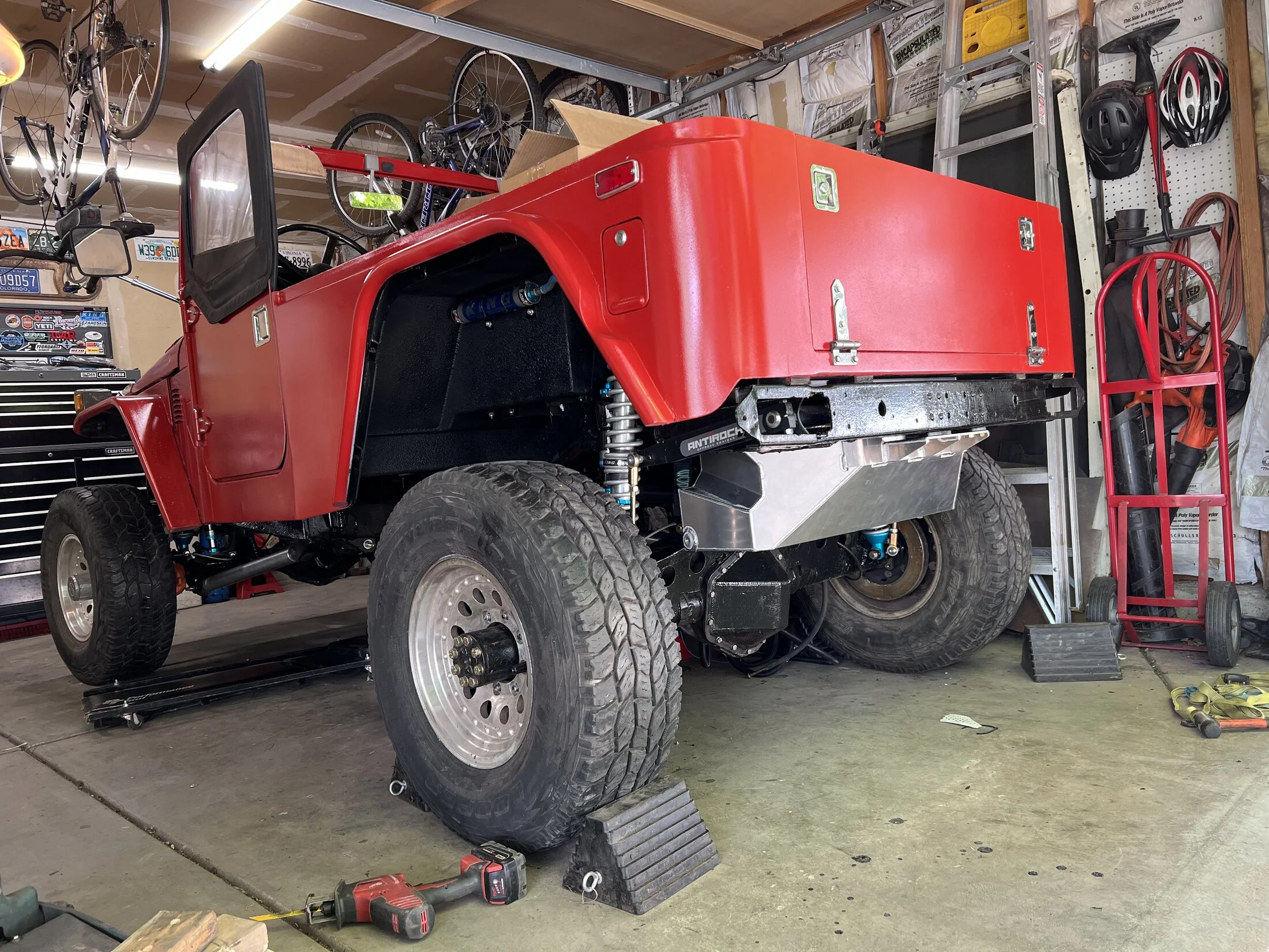

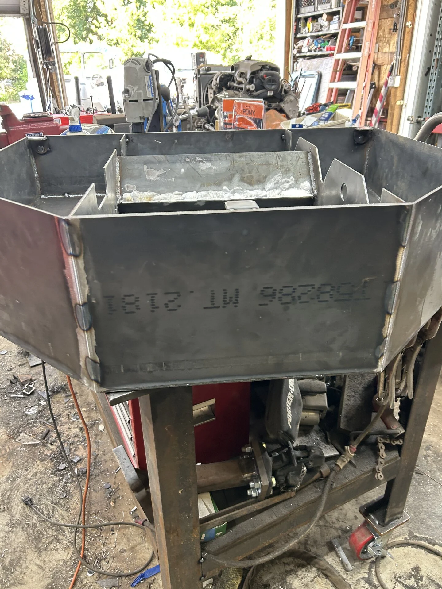

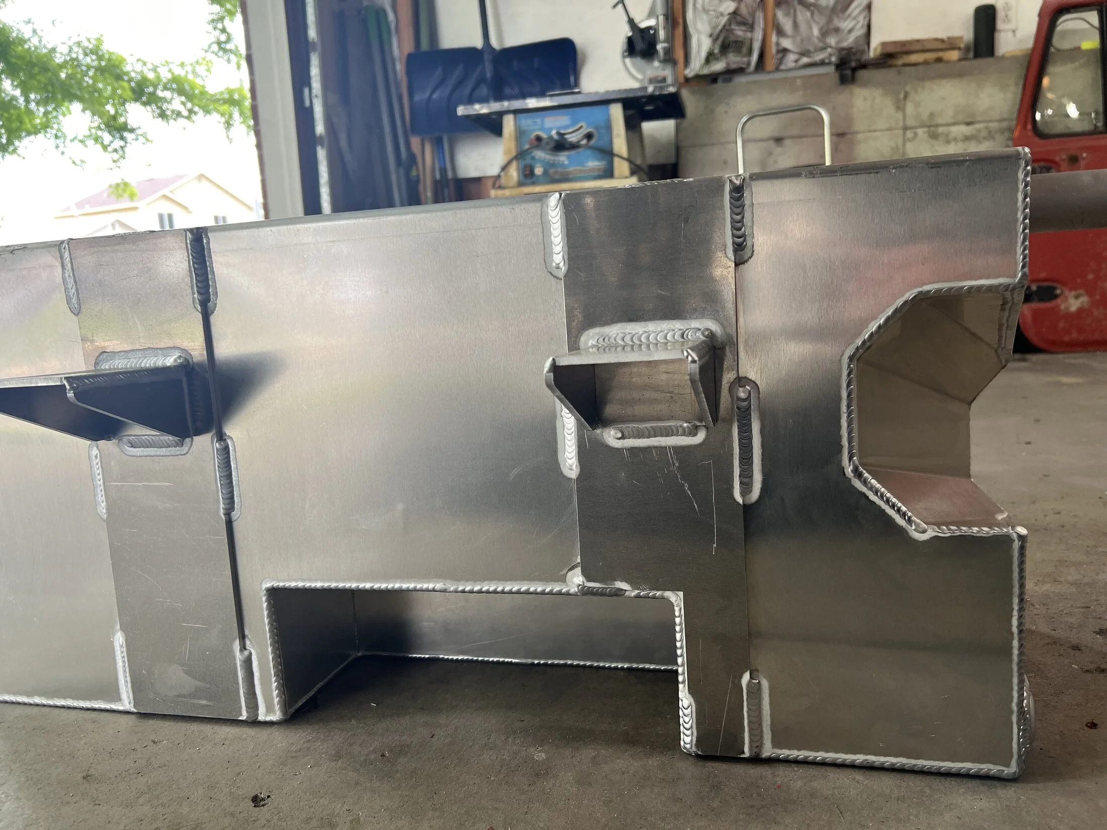

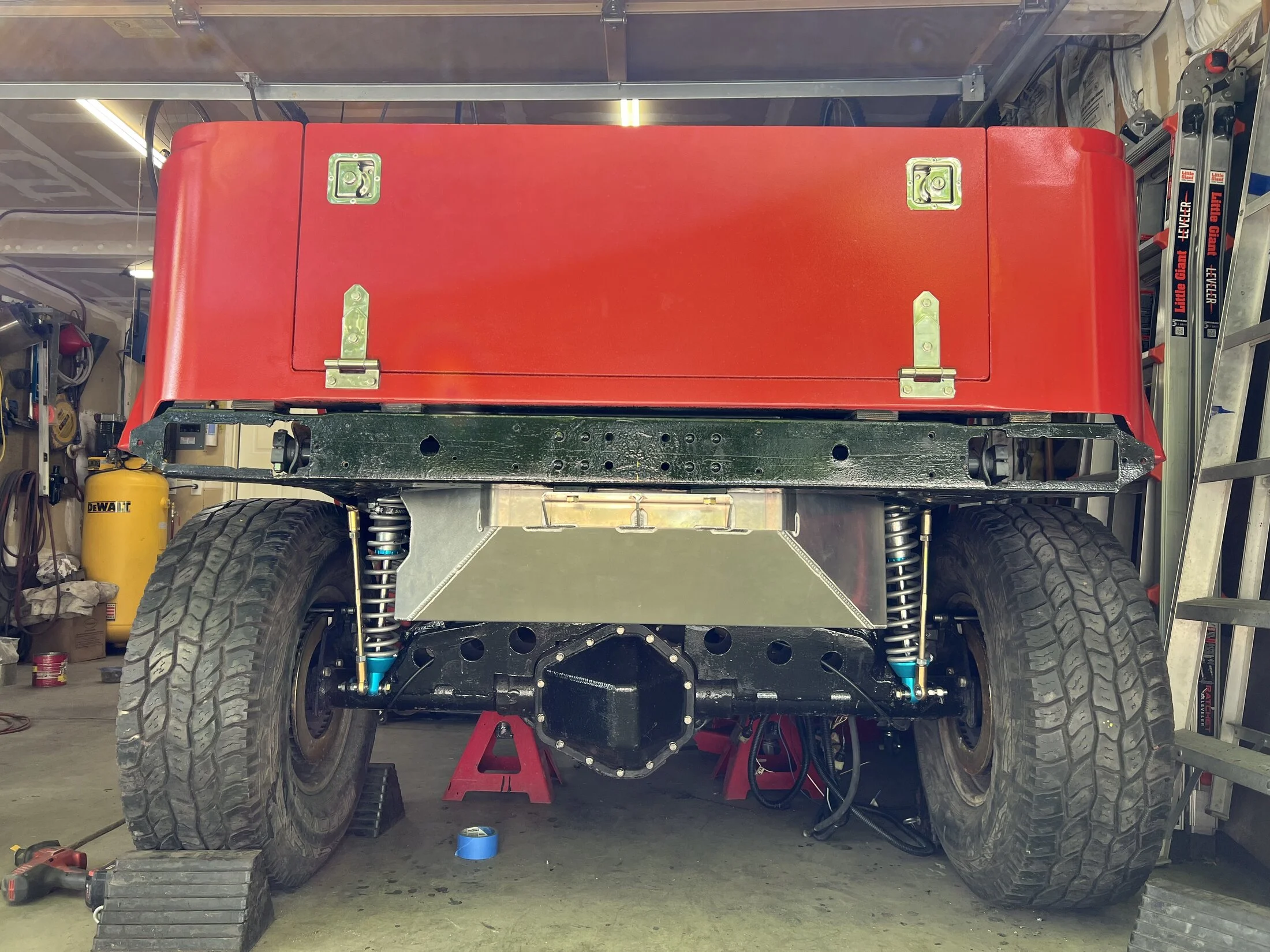

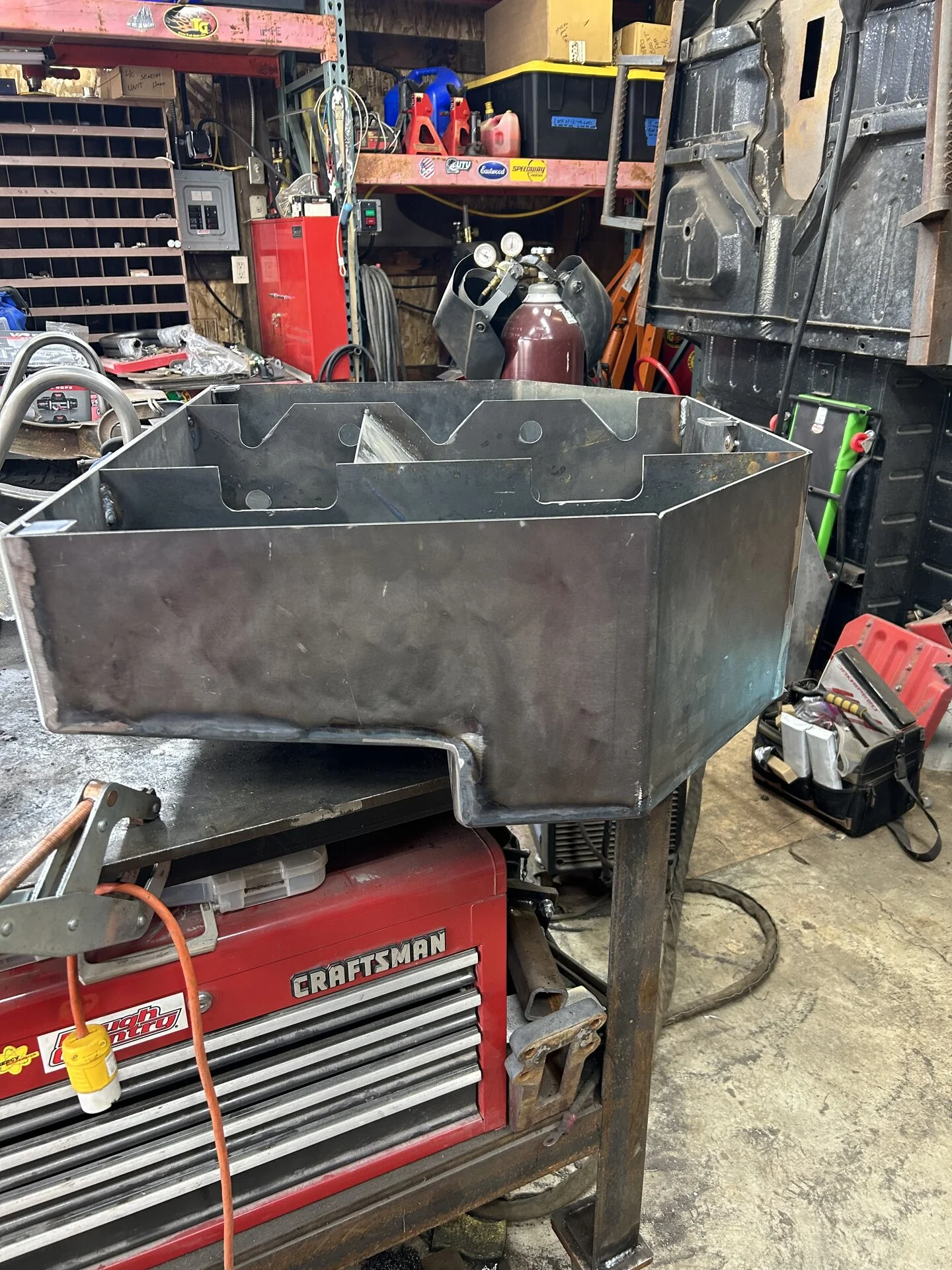

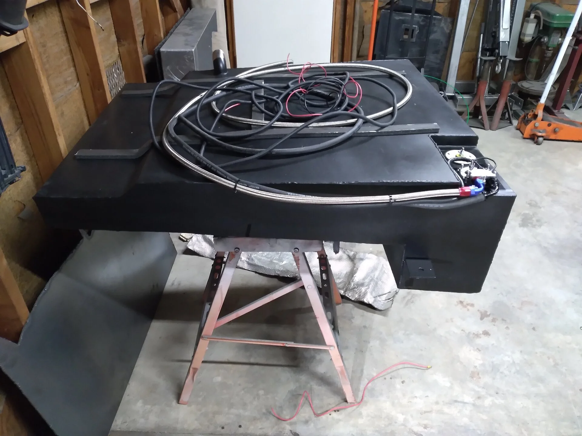

I am moving mine to rear outside. I bought a NOS confer tank it was a nogo with my 14 bolt pushed back 4 inches. I spent some time with tape measure and drew up a tank for rear. I had steel water jet cut at work and sent it to get bent on CNC brake. Front bottom and rear one piece 1/4in. Both sides and top built from 11 ga. Cubic inches converted to gallons should be 23 1/2 gal capacity. Here are a few pics putting it together

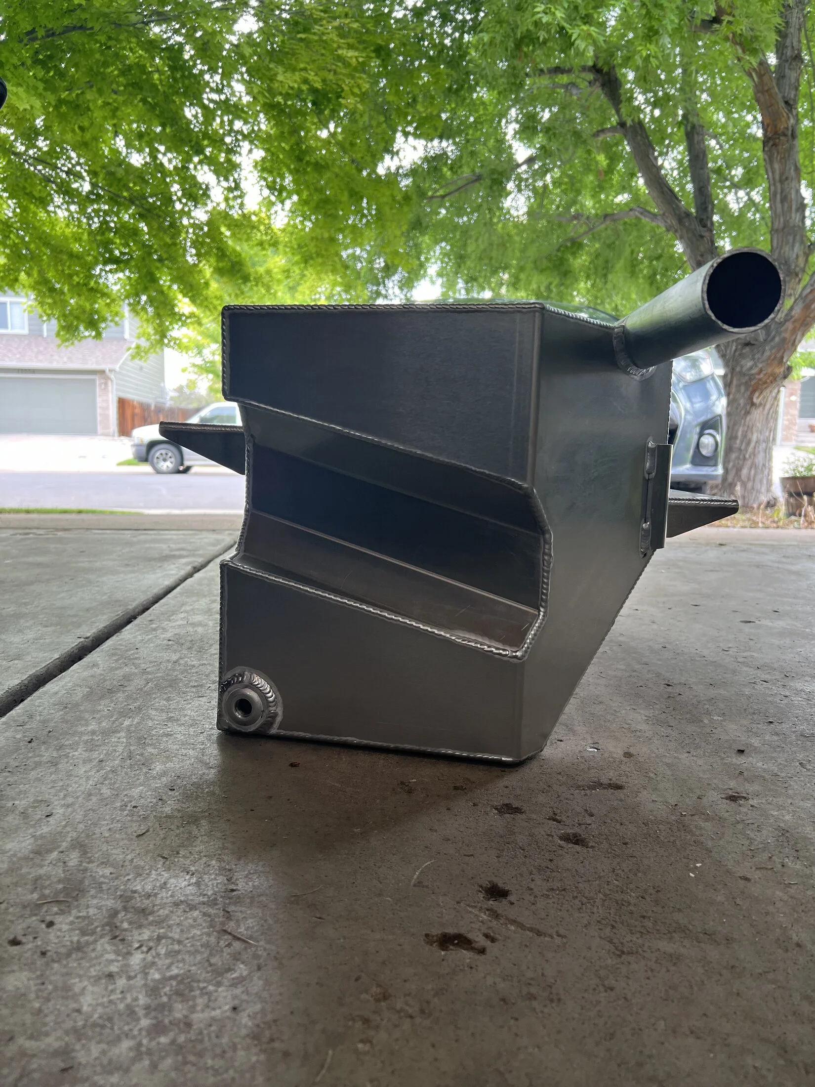

Nice tank design! I ran into a similar challenge with my C14 axle, especially after moving it rearward, so I created a styrofoam mockup for a machine shop to replicate. It turned out great and it holds over 22 gallons.

Wow, that aluminum tank is gorgeous. If whoever built that did it for less then $2500 they are robbing themselves.

I second this if you can get it to fit. I tried fitting one behind my axle but my differential wouldn’t clear. My links are also in the way to fit one in front of the rear axle. I paid less than $100 for the S-10 tank new so it wasn’t too much of a loss.
I second this if you can get it to fit. I tried fitting one behind my axle but my differential wouldn’t clear. My links are also in the way to fit one in front of the rear axle. I paid less than $100 for the tank new so it wasn’t too much of a loss.
Yeah, if you have moved the axle back at all the S10 tank probably won't work behind the axle.
