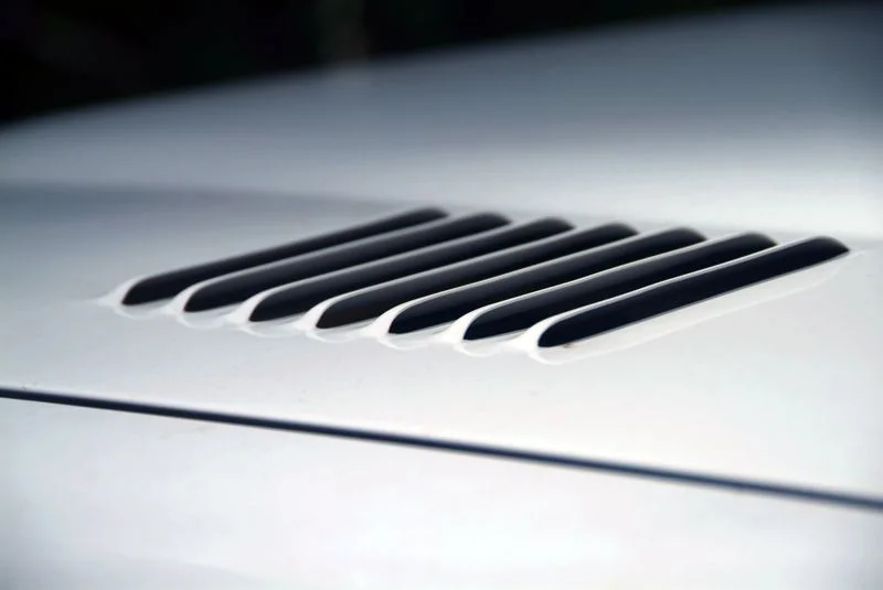

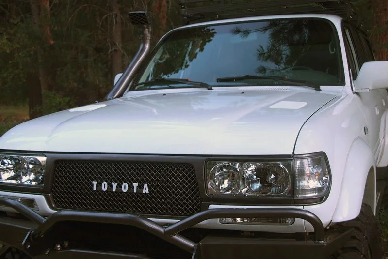

Bumping this thread with some pics to give you guys working on your trucks some inspiration:

This is TreeRoot's 80 build. He is a member of RS and has done some nice things with his new 80. These are, of course, FJ40 style hood louvers and a retro grill.

TreeRoot was our trail leader on Metal Masher at last year's Cruise Moab (he was driving his 40 that day).
I like the hood louvers. I have considered installing some aftermarket louvers where you cut a hole in the hood and insert the louver. But these look so much more "civilized." Do you know did he do them himself or have a body shop do it? Neat idea...
He found a guy in the Denver area that had the special tool and the knowledge on how to do it. Details in one of his threads in the 80-Section. He didn't mention cost.

Thanks Mike. I checked out the thread on the Mud board. That's a cool idea. It looks like he's got some time and/or money in that rig. The louvers and the grill give the truck some personality.
He also replaced the headliner with cashmere or suede or something like that. Greg's gonna be hounding me to help upgrade his interior after he gets wind of TreeRoot's progress.
