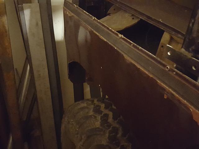

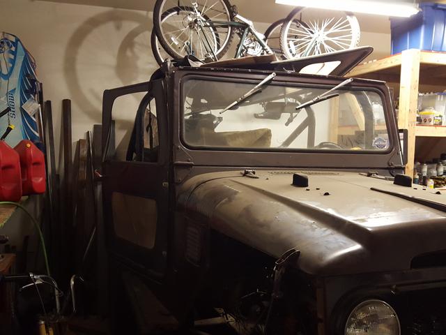

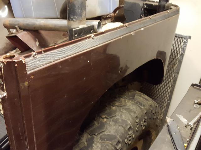

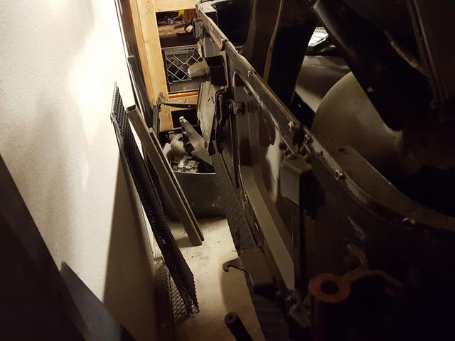

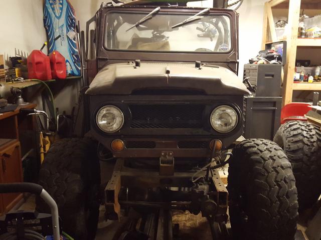

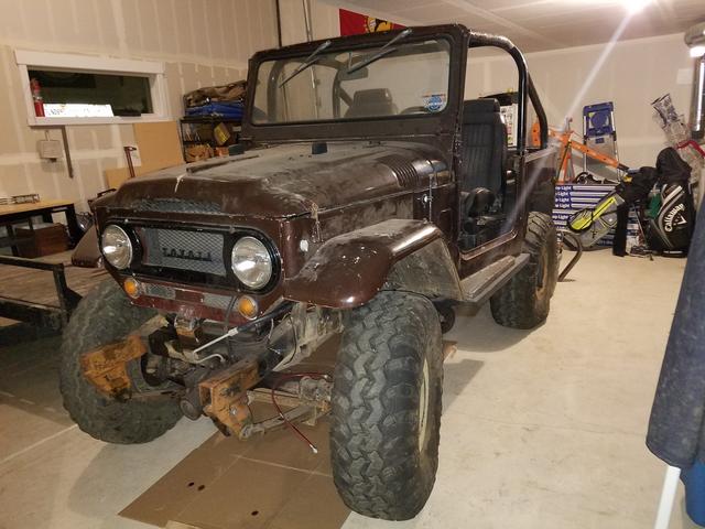

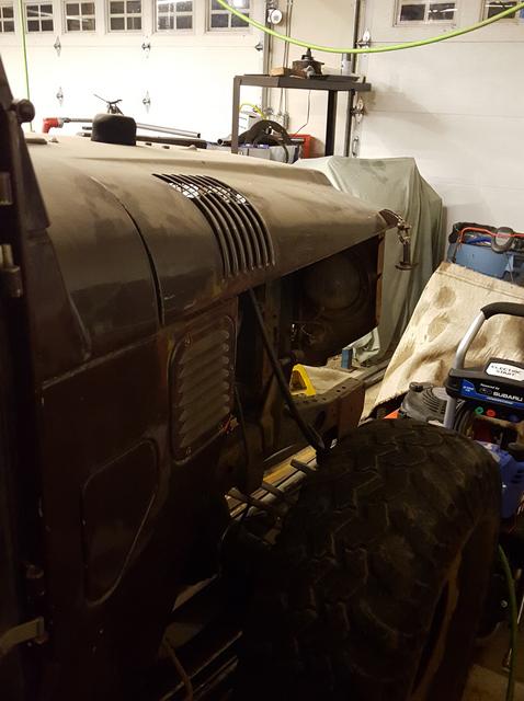

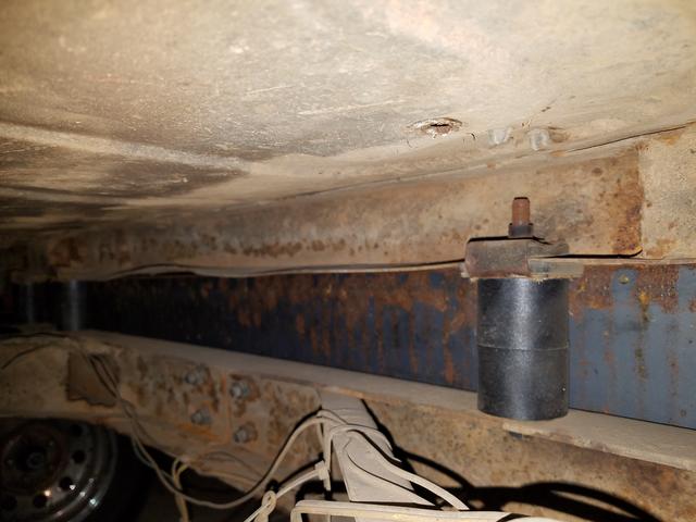

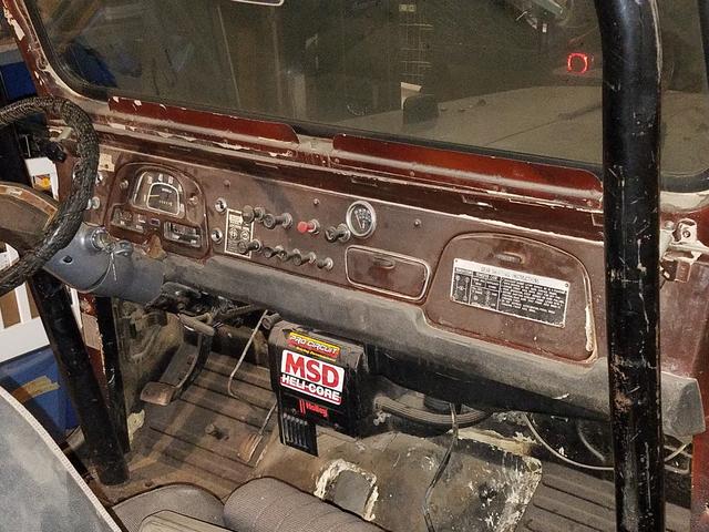

She is an early 1968 FJ40 hardtop with a small block Chev engine, TH350 automatic trans, 203 crawl box, and stock case. It comes with a super awesome 3” body lift, MAF shackle reversal kit, and acre long rear shackles to make up the difference in lift. (That was my sarcastic voice, just in case you missed it.) It does have a Saginaw power steering swap (minus the pump), FJ60 front knuckles and brakes, a bunch of spare parts, and one of the cleanest original tubs I have seen. The poor thing has been buried in the back of a garage for a very long time and these were the pics that started it all:
It actually has a replacement VIN from CA DMV. But they just added "T68" to the original VIN "FJ40LV51571". I don't know the history on that, but my guess is either a lost title or it was stolen at some point in its life.
But yes, you are correct: She's a gas engine, short wheelbase, left hand drive, hardtop and she was the 51571st built. That puts the manufacturing date in Sept of 1967.
A far cry from the way Toyota made them. This does not even resemble the factory unit. Not that it is a bad thing, but, I am a purist so I enjoy the way things were.

Very true. But it does have a pretty cool history from what I can see. This will be in no way a restoration. Due to lack of funds, it will probably start out as something a college guy in the late 70's would have dreamt about. I'm even thinking q78 Swampers. Once it is up and running and driving, I will start to evolve the build as money allows to something more "hardcore". It will continue to be comfortable on the street, but be able to crawl.

Since I agreed to be a motivator/facilitator for this build, it's slightly my fault that Chad now has this in his garage.
The only content I have to add so far: a Lockright to hopefully replace the welded rear diff (pending confirmation of spline count).
Also... Chad, get me some engine block and head casting numbers! I think half of this build will be figuring out what's there and what kind of shape it's in.
Wow, @Mr Chuck Norris, you really need to update your signature... And I only blame you partially for this holding down my garage floor!
The lockrite will be used in either the front or the rear for sure, however messing with the axles is way down on the priority list. I think the first thing I need to do is go through all of the boxes of parts and find out what I can sell. This is going to be built on the hopes and dreams budget.
Or someone can just buy it from me. :flipoff2:
Wow yeah, I needed to update my info. It's been a while.
