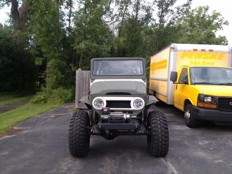

About 1 week before I supposed to leave for Coal Mine, the truck thundered out of the garage for the first time in nearly 3.5 years, clearing the overhead door by a mere inch with the rear tires flat. In a redneck way, I dig the two-tone scheme.
Some outdoor shots at muffler shop #1, which turned out to be a colossal PITA.
I figured the local "little guy" auto shop would have been able to handle the exhaust system in a timely fashion. Nope. He said if I dropped it off Wednesday, it would be ready Friday afternoon. After a lot of "well this and well that" and absolutely nothing done to it, I picked it up Thursday afternoon and took it to Midas who did a great job on it.
