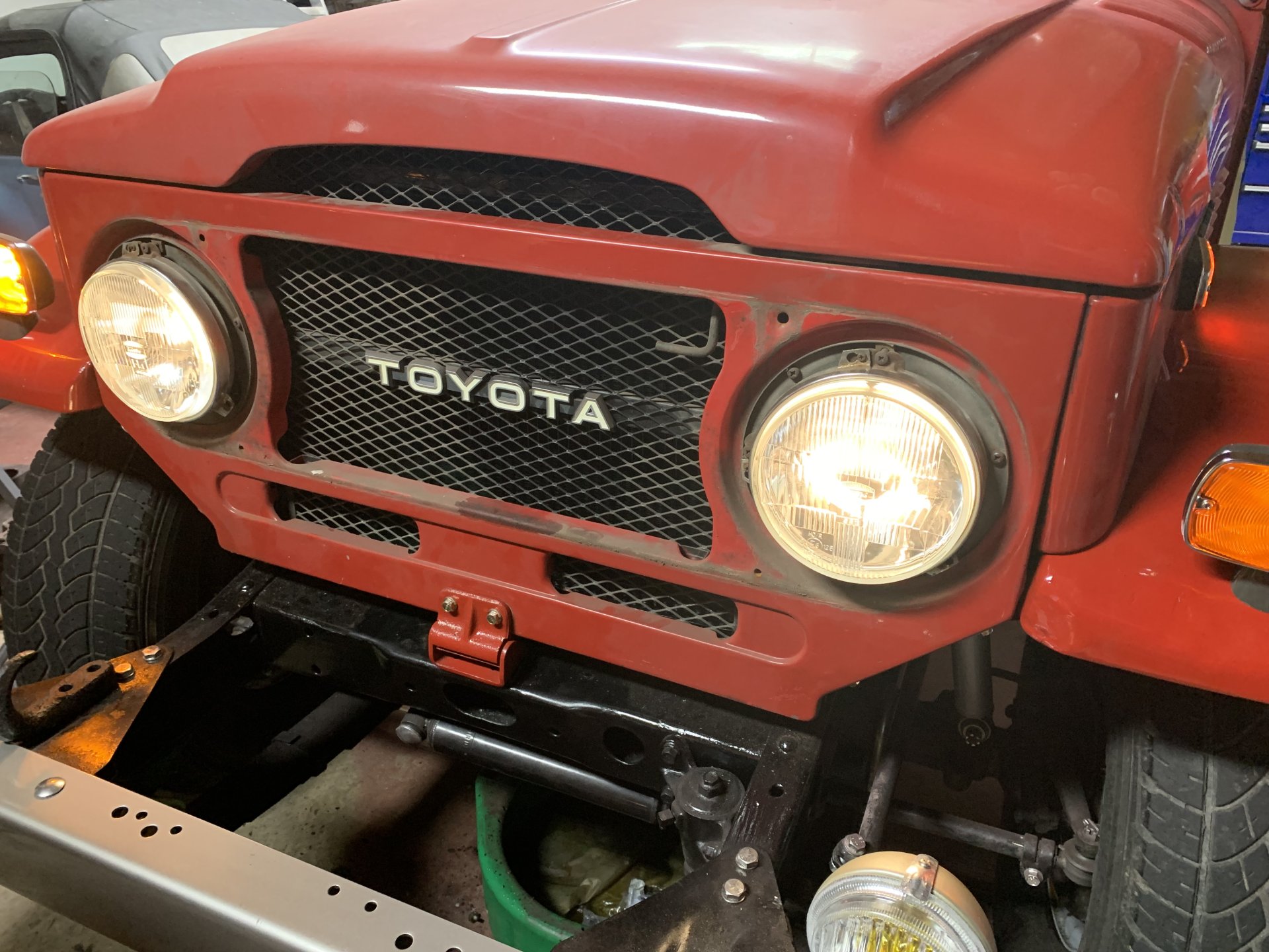

Sniper fired up today thanks to tech advice from @wngrog and Lance at Iron Pig Off road. I ended up with so much free time I cleaned all the wires up and installed the OEM headlight kit Toyota still sells. Pics attached of part number.

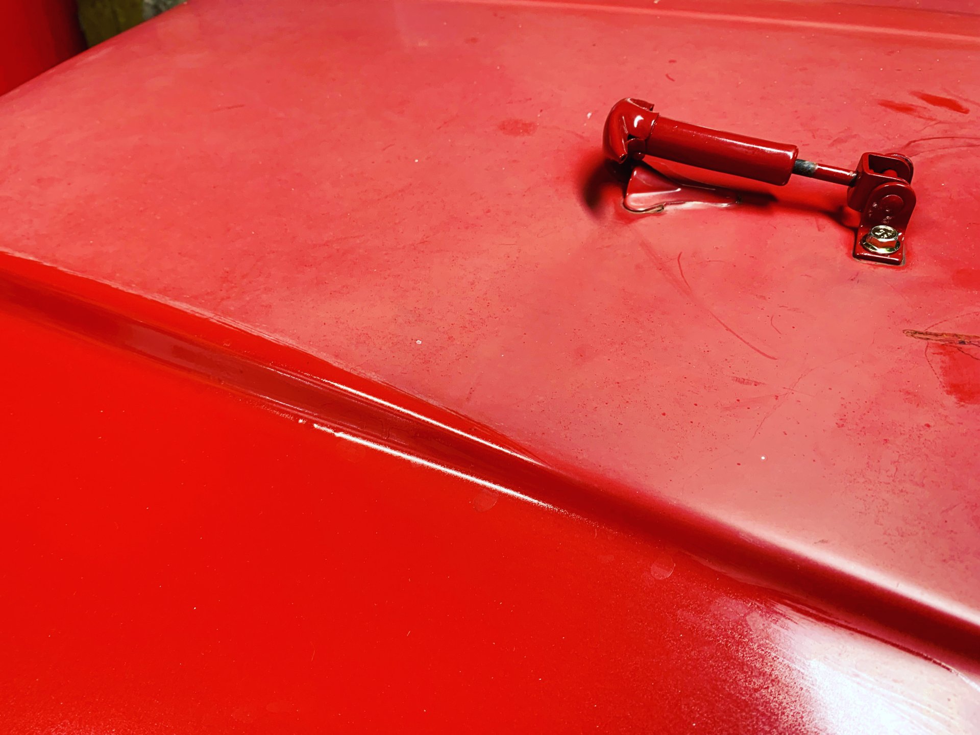

Painted the windshield hooks. Started cleaning the paint and applying penetrol. Also continued chasing shorts within the signals.

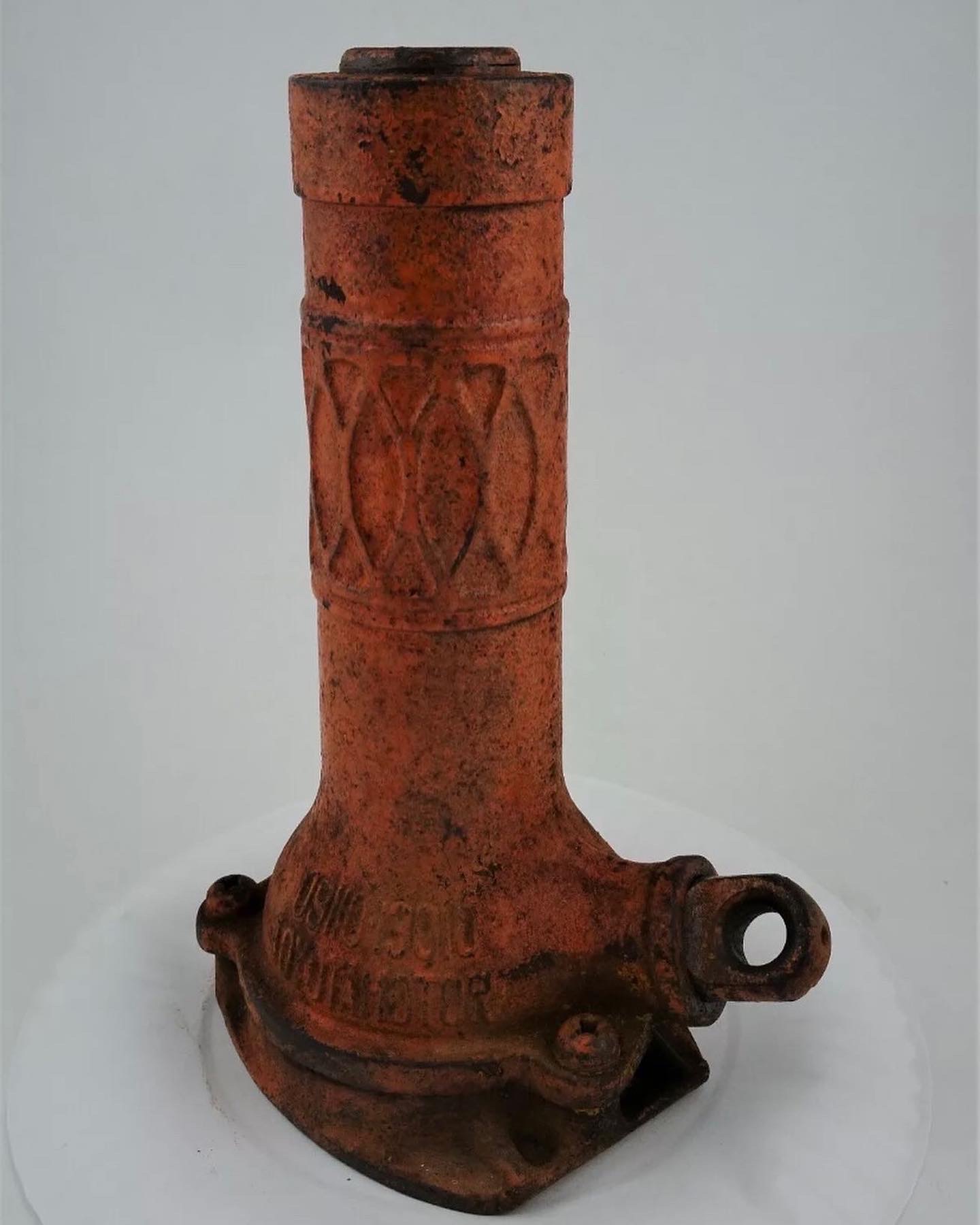

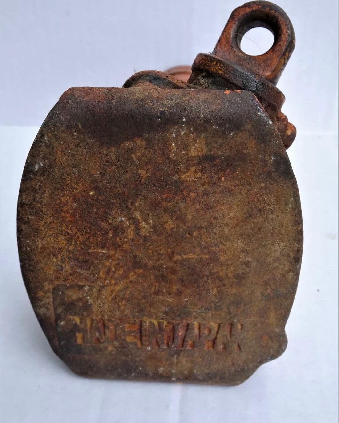

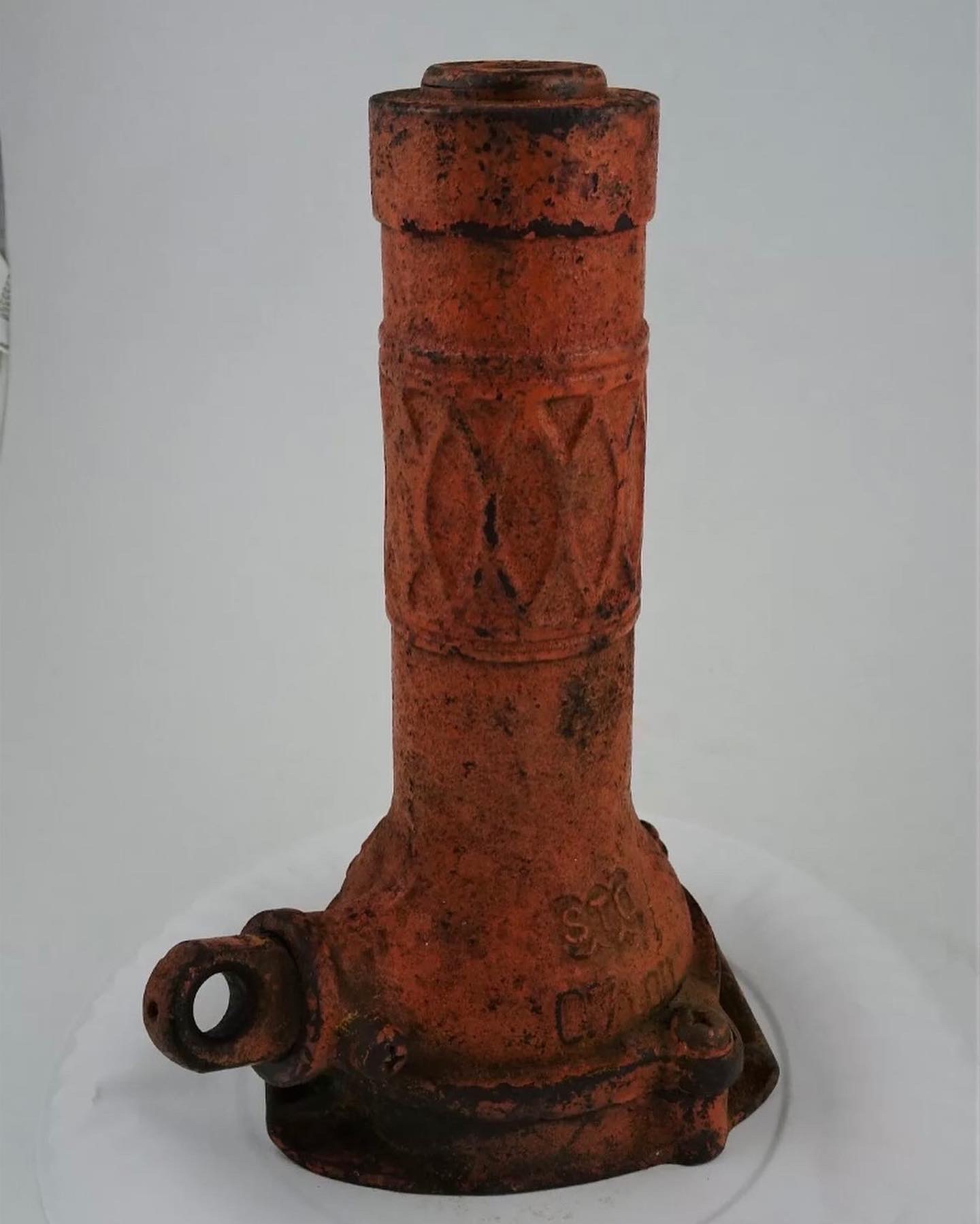

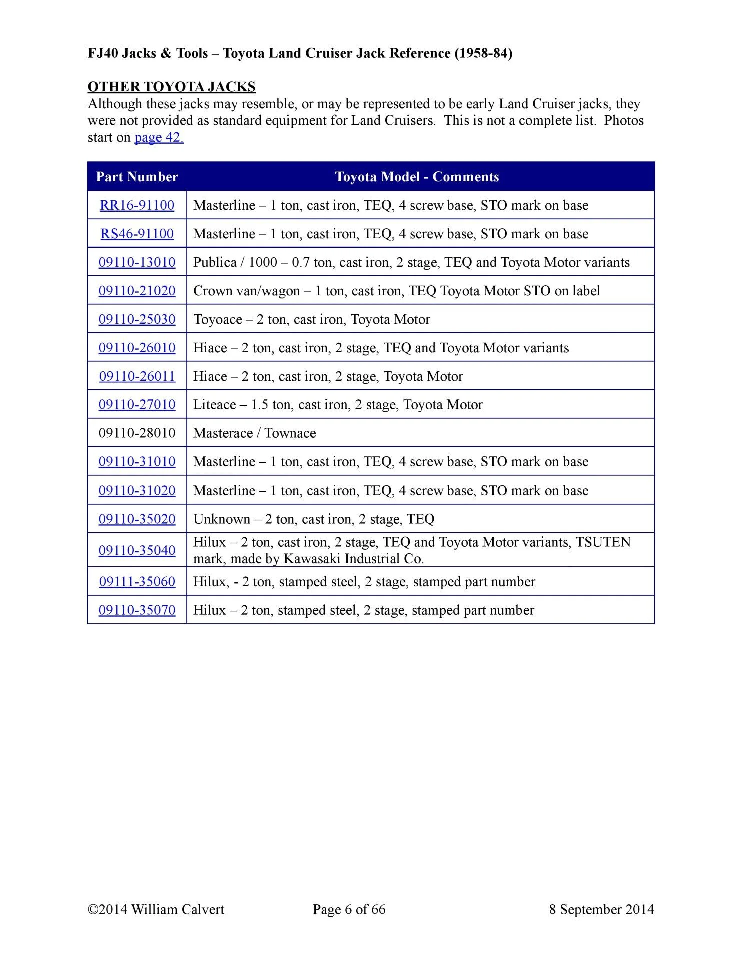

Acquired a Vintage Toyota Motors Bottle Screw Jack 0.7 Ton Capacity. Has part number 09110-13010 on it. These are still available from the dealer as well I found out.
Was the headlight kit plug and play for the most part? Where did you order it?
Yeah, the headlight kit is plug-and-play. I ordered it from Vescovo Toyota. They offer free shipping and no tax with orders over $75 using the code “freeship”. $40 for the whole kit. I purchased two of them as I used the extra harness to wire the OEM fog lights.

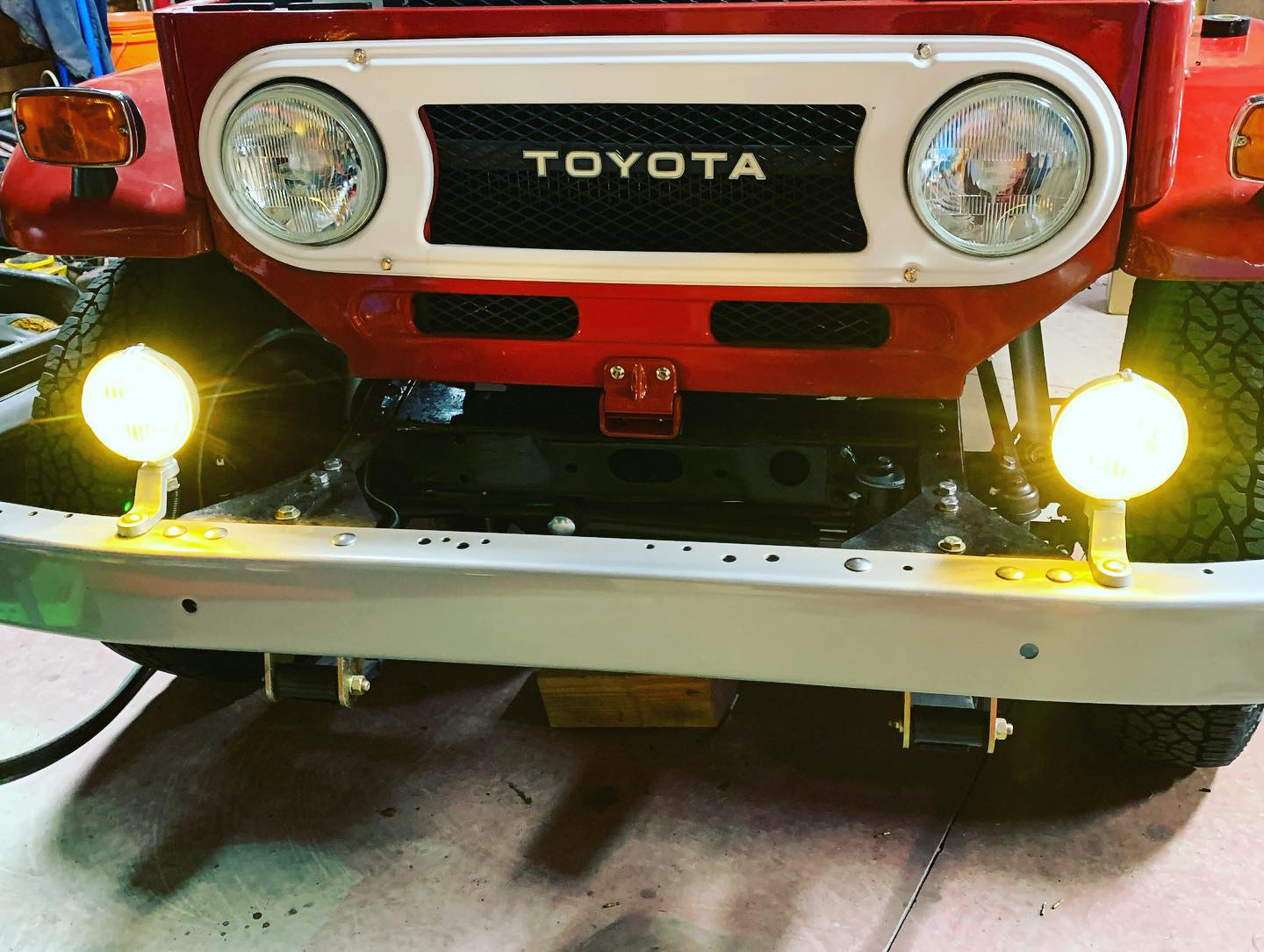

How did the extra harness workout for the fog light install? I'm waiting delivery on the OEM fog lights, brackets and switch but had not considered a harness. I did the headlight upgrade a while back and that harness included a ton of wire and 2 relays but it plugged into the existing headlight wires.
Well the harness is great for me as it's just a basic well made harness that only requires one trigger wire. That trigger wire comes from the fog light switch. As we discussed it just closes the circuit so power is applied. I shortned the harness a bit after it was laid out. It's far easier having too much harness to route then making a short one work. I am waiting on additional fog light knkbs and switches to come in but will do a quick write up.
@Green Bean you can just as easily use this harness and just make the OEM fog light switch the trigger by cutting off the push button end.
