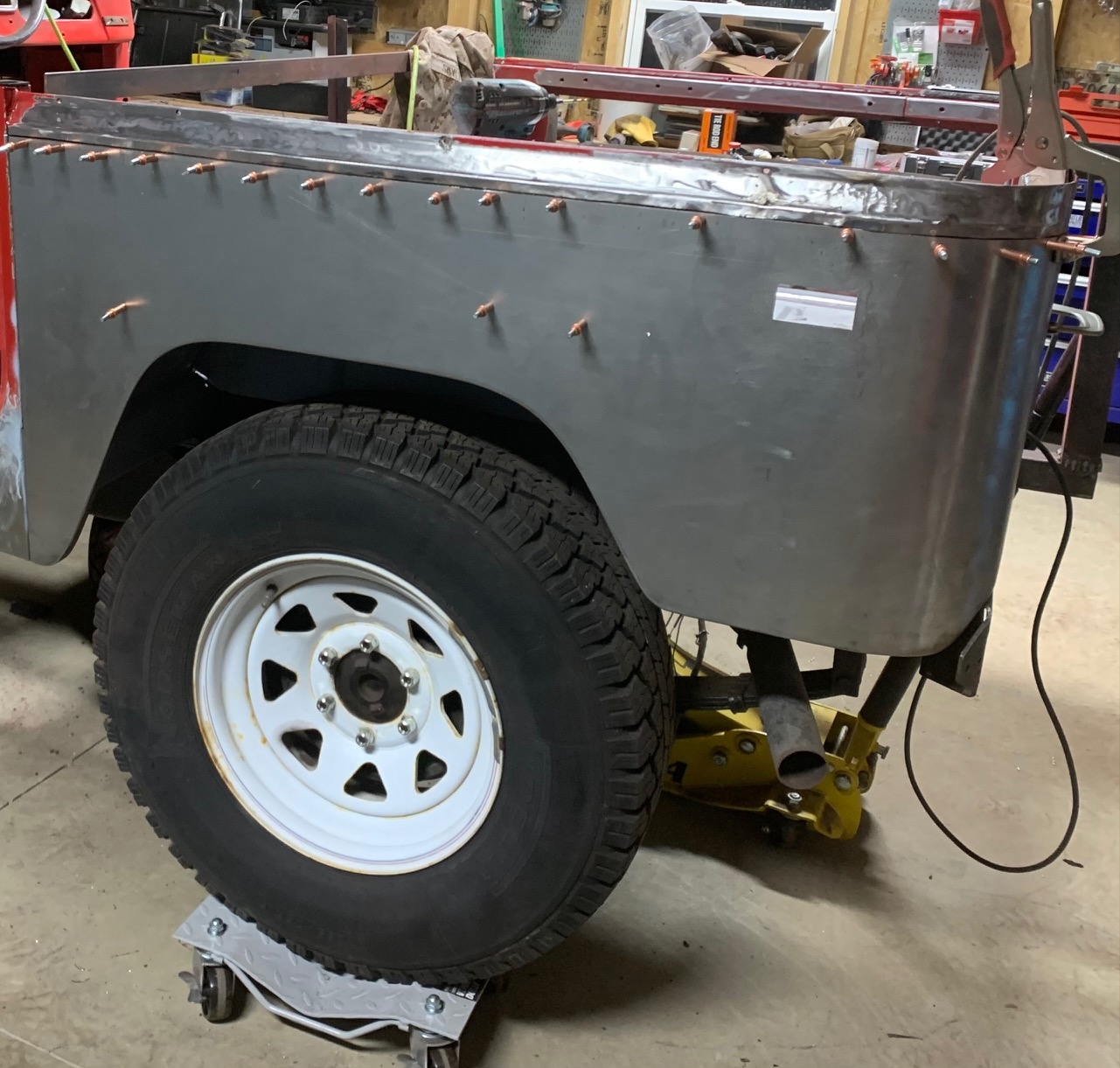

Got the quarters and the rest to the point I could shoot a basecoat of single stage to see how good/bad a job I did. Only pic I took which doesn't show much I know. I had a tent set up.

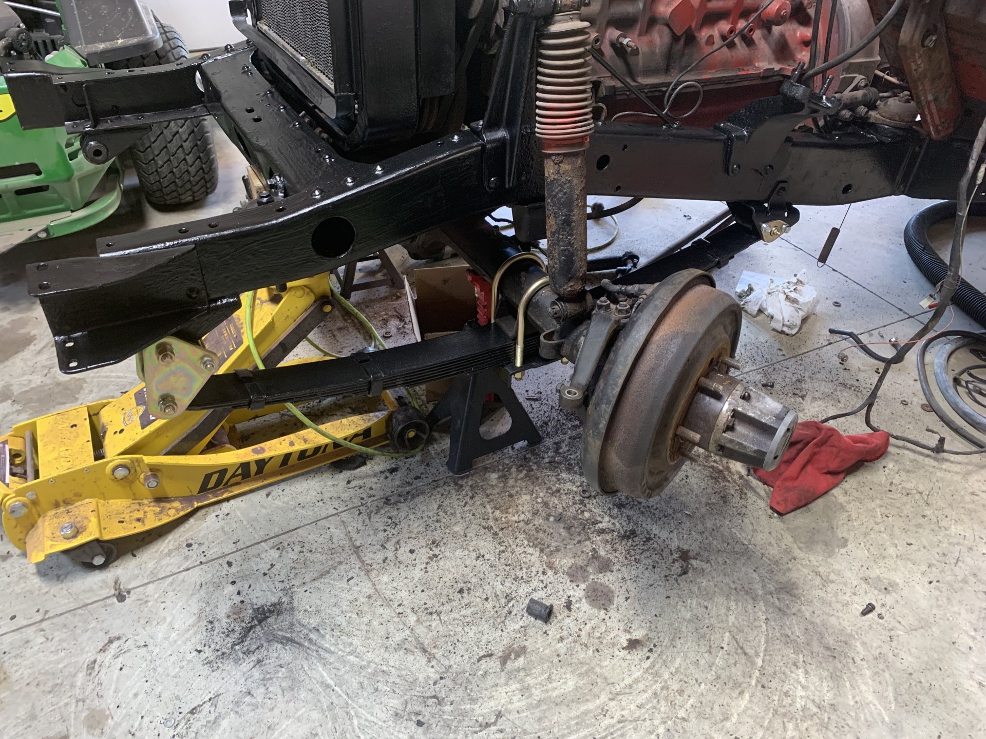

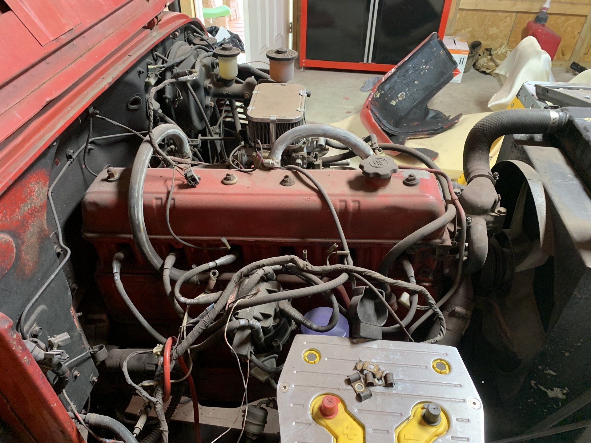

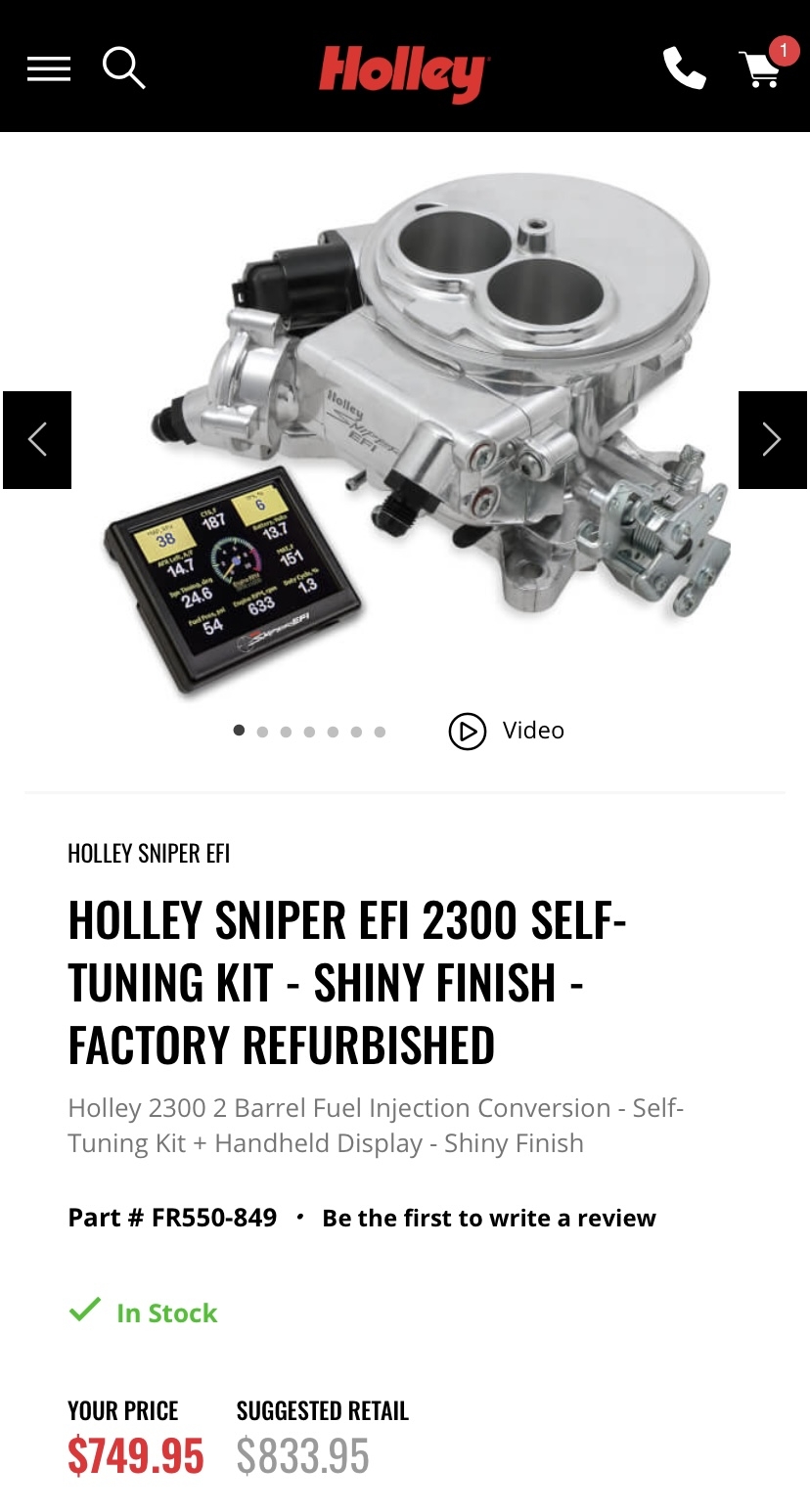

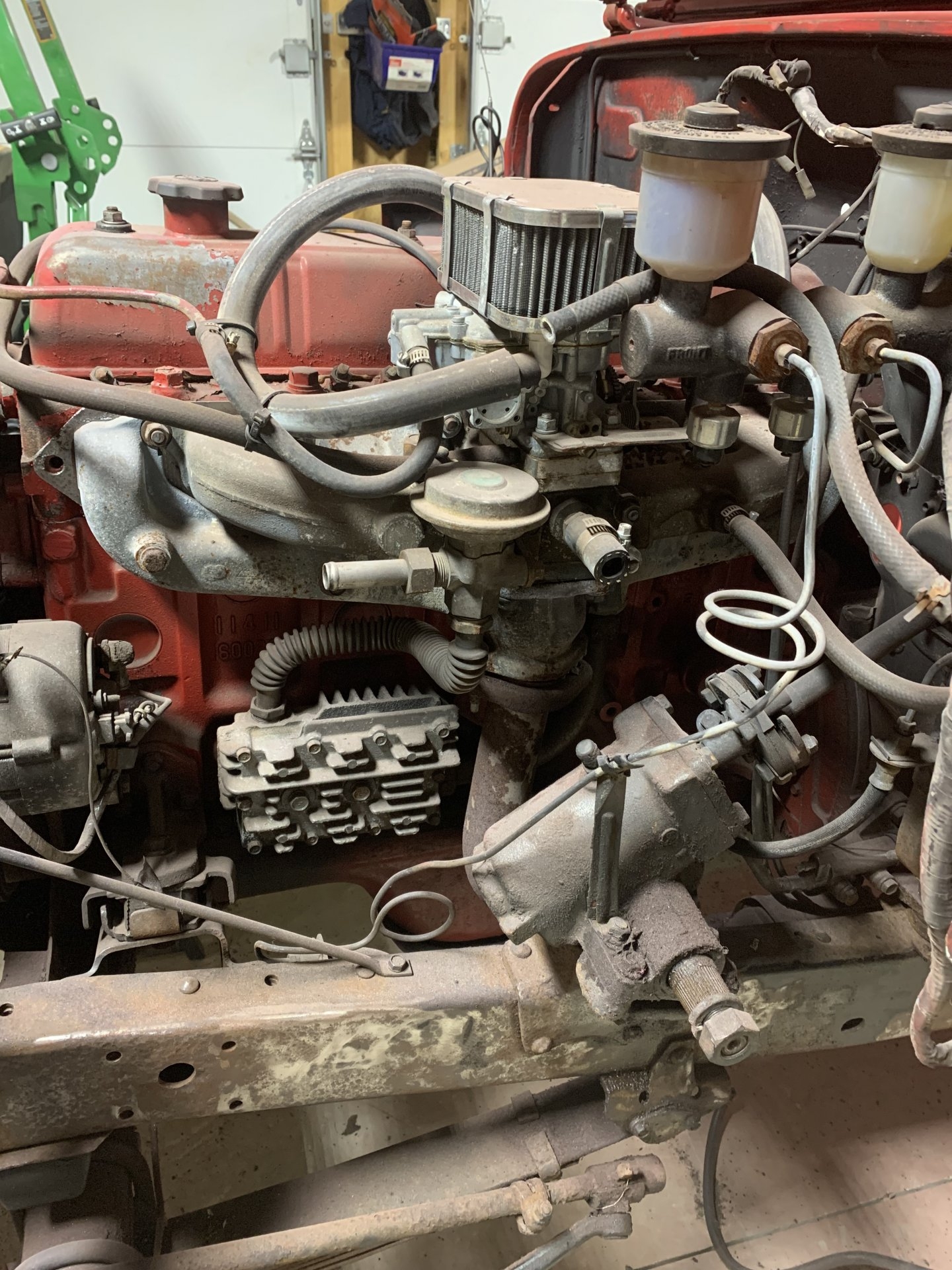

Coated the entire frame in Chassis saver today. Also ordered a header from JT outfitters and a Holley 2300 Sniper EFI kit. The engine has a weird mix of emissions stuff. It's all coming off and into a box for later.

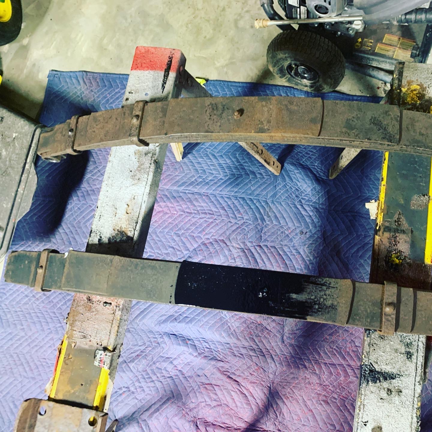

Finished one leaf spring refresh. Pulled it all off and sand blasted it. Then chassis saver and new u bolts, bushings, anti inversion shackle, and greaseable pins.

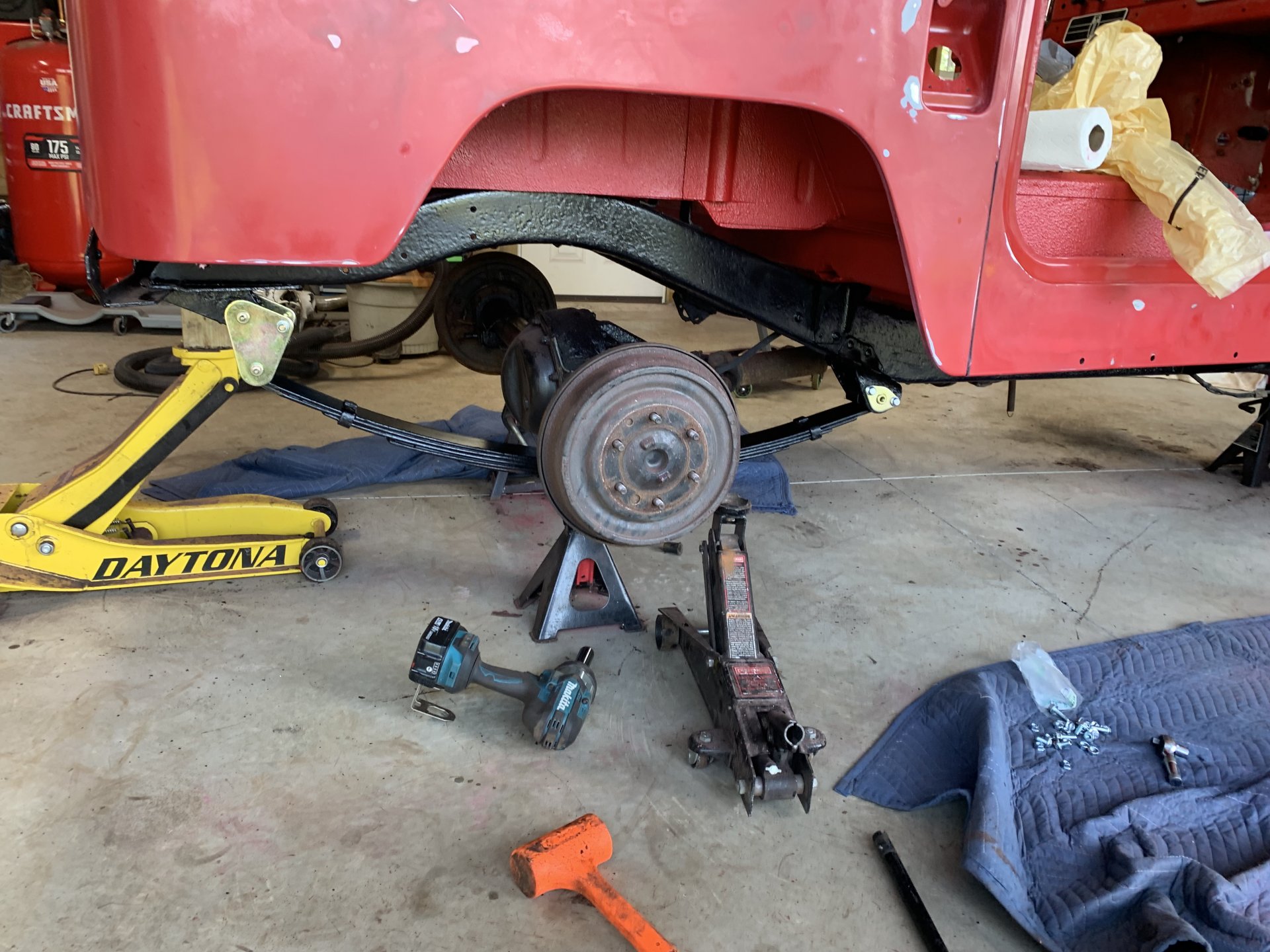

Finished the rear suspension minus shocks. New shackles, bushings, greasable pins, and leafs were stripped and coated in chassis saver. Went ahead and tore off the front steering linkage and stripped and Powdercoated it as well. More to follow.
Any advantages to weld it this way vs "under channel"?
I just thinking what to cut... panels or canal cover
I forgot about this thread! I’ve only replaced the panels this way. The channel is nice to have as a backer since the metal can be thinner in this area and if it blows out you have something to put a patch against. Since the area is closed off that can be challenging. Since each tub is different I normally will lay the panels over the existing metal and get a rough cut line. Then Go back and forth cutting out the old panel and comparing it to the new one on how it lays. I’ve done this about 8 times now and it’s all I know.

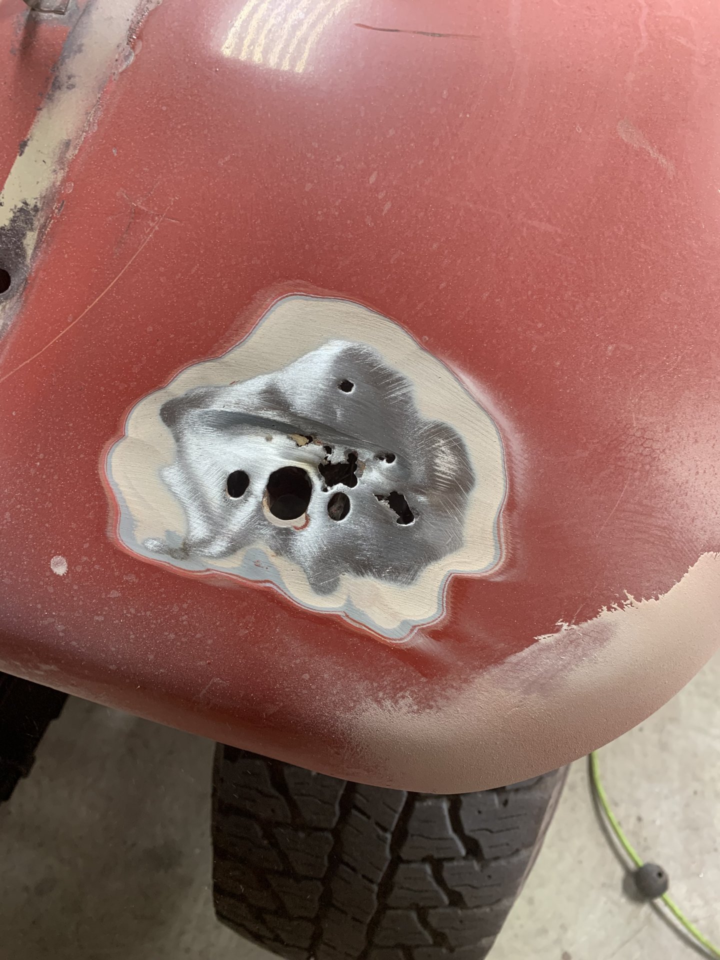

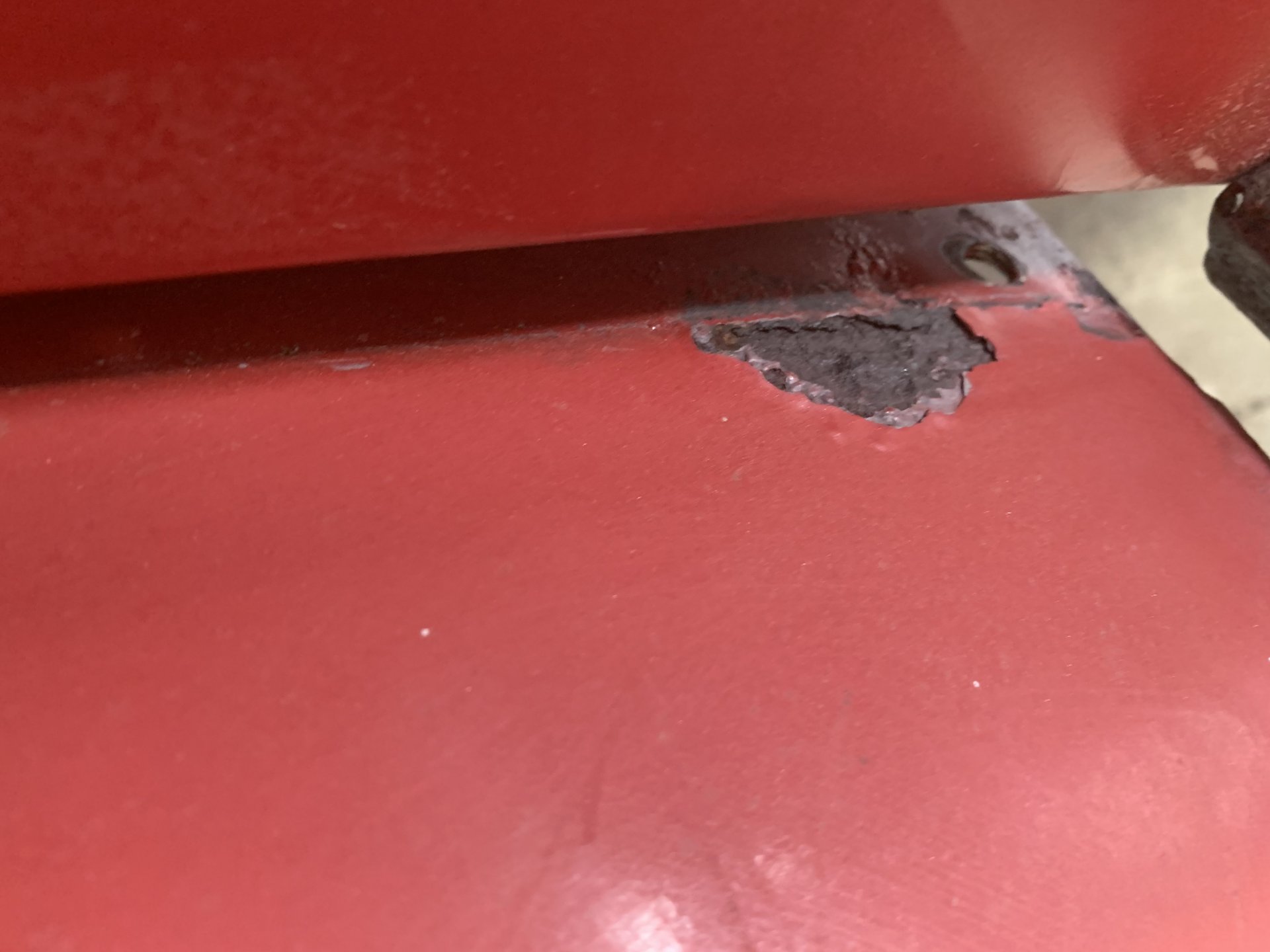

It won’t be that bad…. 45 minutes later. Yup it’s that bad. Breaking out the welder again. Stripped it all back and lots of thin metal and thick bondo. It’s all good. I can fix it. Just not happy about it all as all I wanted was to sling paint this weekend and get this one off to the new owner.

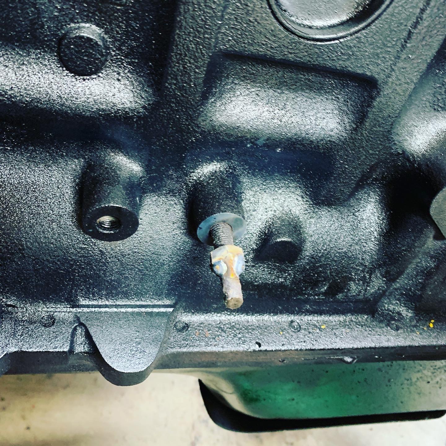

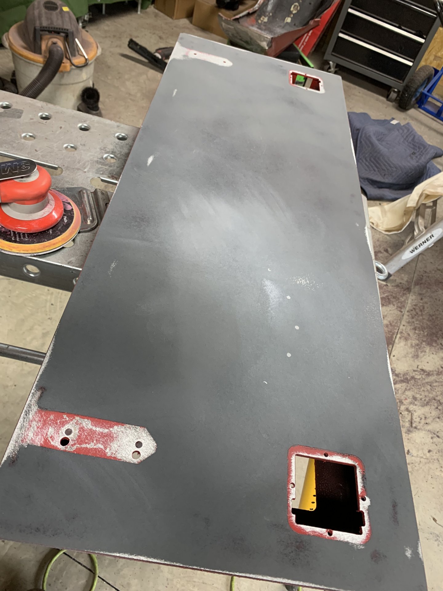

Finally welded a nut onto the broken emissions bolt. Prepped the sides for paint. Also placed an order at Redline Land Cruisers for the CNC’d adapter, heat shield, and other odds and ends they sell for the Holley Sniper 2300 install.
