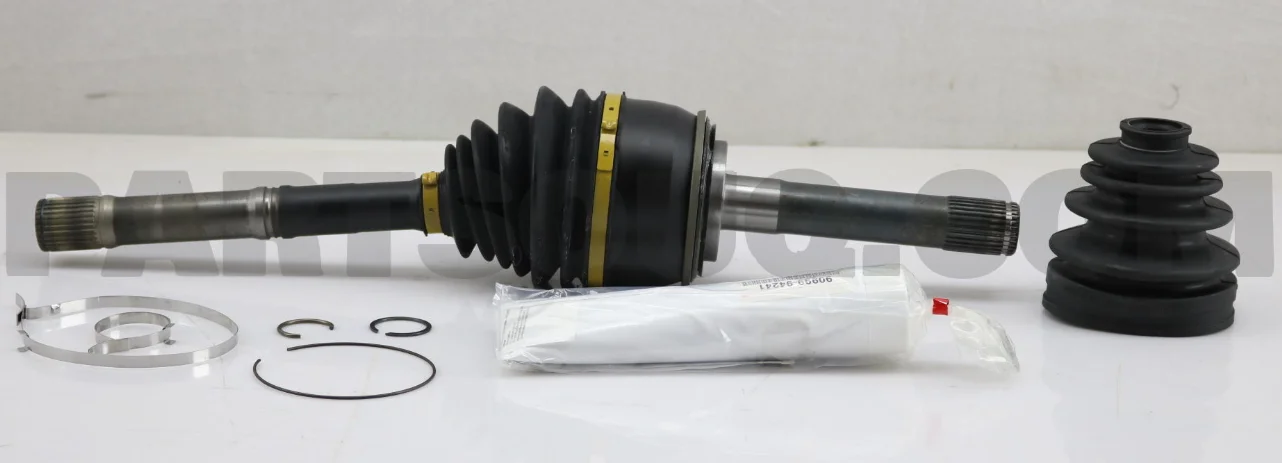

@ClassyJalopy is that part number you mentioned the full EVERYTHING kit for the front axles? I was looking at buying parts to have a local shop do this for me. This is my local parts counter: Parts like 43460-69145 - https://parts.hendricktoyotaapex.com/productSearch.aspx?searchTerm=43460-69145 .

43460-69145 gives you the whole outboard shaft, the inner boot, grease for both ends and clips. I highly recommend getting this kit instead of just the reboot kit since the outer-shaft grooves usually are worn out with mileage.
As for other stuff to replace while you are in there? I would recommend replacing the drive flanges and the diff side axle seal.

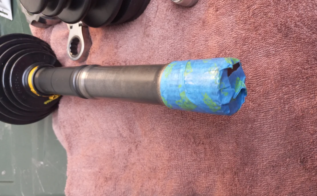

Are there any people that wrap the outer splines with tape and lightly lubricate before sliding the boot on?
The idea is to protect the boot from cuts when its being stretched over the axle end.
I don’t. Those boots are thick and tough. I just slap a little grease on those splines and the boot goes on without issue.
