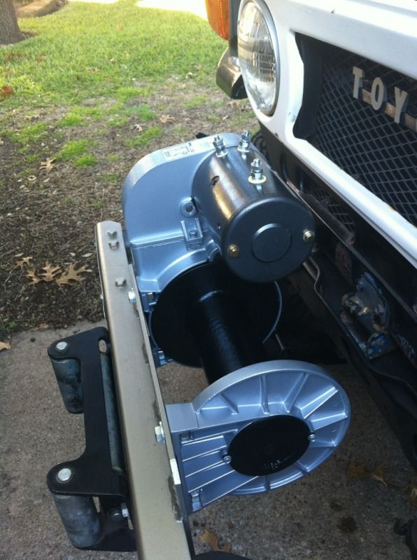

Update:
Some teaser shots for you guys, was hopoing to have it fully operational for a wheeling trip last weekend but didn't get it done. Ran into issues with an Aussie locker install and had to order different thickness thrust washer shims ... long story short I was assembling a differential instead of wiring a winch :frown: Did get it all assembled and mounted up minus the solenoid pack:
Ended up just buying a new clutch from Warn instead of the billet Gigglepin ($75 vs. $150), did go with the upgraded brake shoes though. Will take more pics once I get it wired up and spooled, have a trick in-cab control as well.

Hate it when threads die with no conclusion, so here's my finished 8274 ready for 20 more years of abuse. All and all I'm prolly in this for about what you would pay for the new generation of Chinese winches, so think twice before you pass on that basket case ... you could have a and affordable 8274 with a little work!
:cheers:
Tucker
Looks great; better than mine!
You said it! Craigslist is your friend for finding old 8274's.
Great job Tucker! That's amazing!
