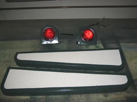

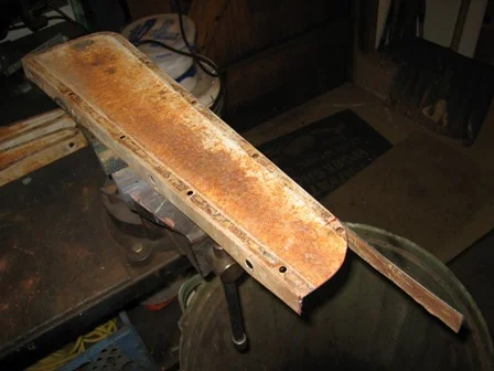

Wasted more time on running boards. :rolleyes:

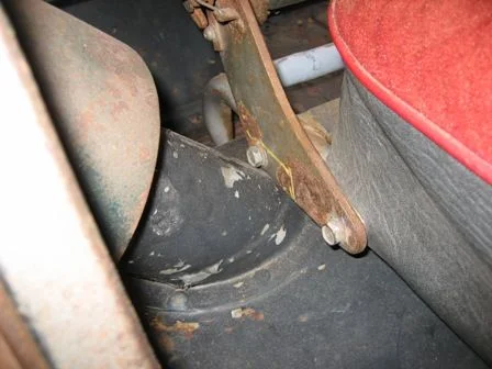

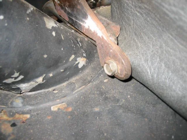

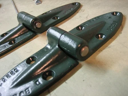

The previous owner must have drilled them out to 5/16". So I used a 5/16" x 2 1/4" SS pin with a nylon washer to take up the slack between the hinge leaves.
I like that for my 45 as well. Anyone have a picture of what the original pins were? I'm pretty sure the bolts in mine are not OEM.

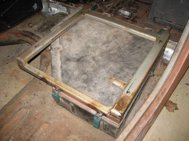

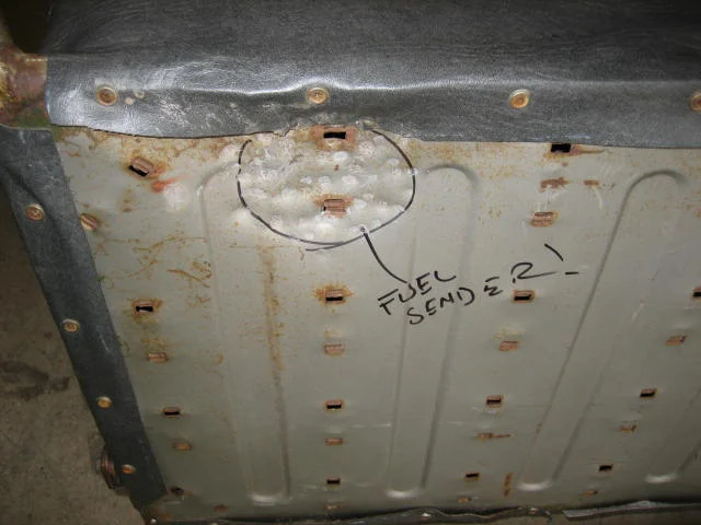

So how do you make later FJ40 seats fit a 25?

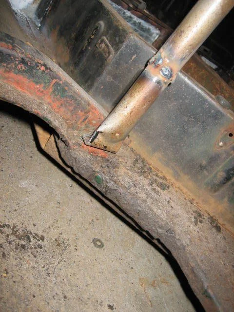

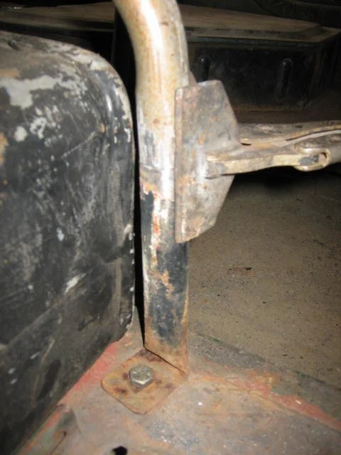

First you clearance the hinge and weld up a support on the back so it doesn't hit the fuel filler.
Drivers seat mount. Used the FJ25 rear seat mount (the bolt holes aren't slotted for adjustment) and had to reposition the front hooks for the clasps. The front edge of the box is about 9/16" further out so I welded the hooks onto a piece of bar stock that extends through the front of the frame.

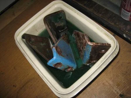

Jim,
I found that if I drill one grease fitting sized hole in the center of the pivot then hose the hinge pin area down with Kroil that I can get those things to free up. A couple love taps with a hammer can also get things moving along. Drilling a hole lets you get lube to where the problem is, give the rust chunks an escape route and then leaves a place to add lube later (I use - wait for it... - a grease fitting and grease :grinpimp:).
