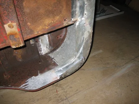

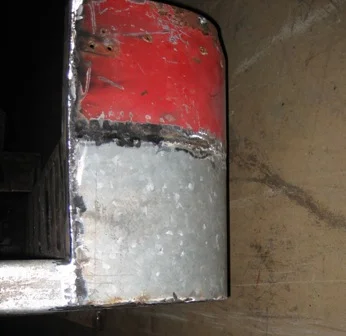

Managed to finish the right rear. One more corner, the center channel and a few more holes and I might have a tub.

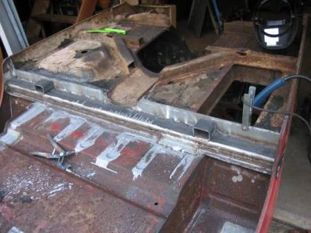

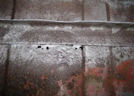

Actually did a little more work on this thing. This is what I was afraid of, my "solid" tub would be like swiss cheese when blasted. Good thing I took it easy on it. :rolleyes:

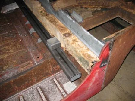

Heck with originality, I want to get this done. My new center section next to the old one. 2x3 tubing. :)

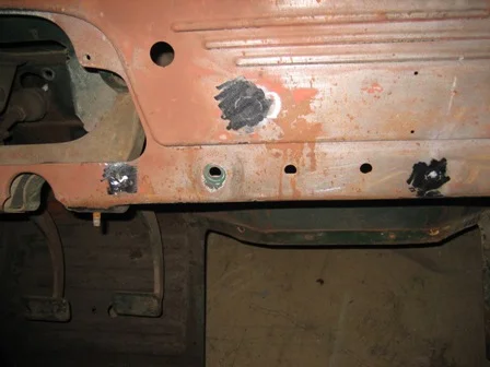

Getting down to what you guys who don't know what real rust is would call "bodywork". :D Patching extra holes in the dash.

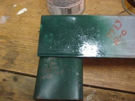

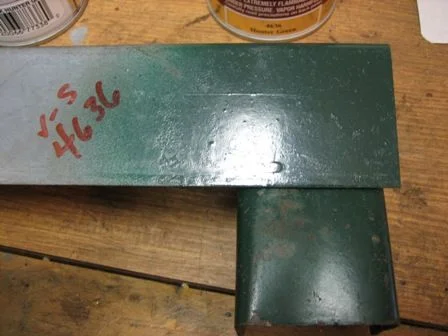

Picked this up at Home Depot............pretty close Rustoleum Hunter Green 7733
Only problem........Rustoleum sucks.
Visited Tractor Supply. Val-Spar Hunter Green 4636, $22 a gallon plus hardener and stuff, just my speed.
