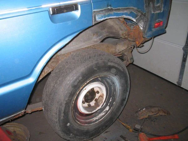

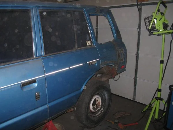

14 inches has been bobbed..
What do you what a pic of?

If you dont have the interior panels and such in yet, could you snap a couple from inside the panels to show how everything lines up? Both my quarters are kinda trashed now and i figure sawzall blades are pretty cheap so i might get a little crazy with the chopping. Did you do anything the keep the back end square while you were doing the chopping/welding?
-Matt
Naw.. bob aint gonna bet paint till he is runnin..
Hopefully before the rubithon.. But.. Paint is the last thing on his list. :flipoff2:
It will be stock metallic blue on the top and below the door handles will be rhino lined..
I'll snap pics of te inside for you.
I did not do the Bob. Honestly, I doubt I would have the paitence to do it. Trailcarnage on this board did it. And a dam good job actually..
