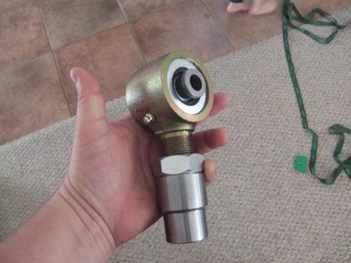

Got the last link item in today.
I was going to put a big ass heim in the wishbone end portion but it actually was cheaper to run a rebuildable, threaded johnny joint.

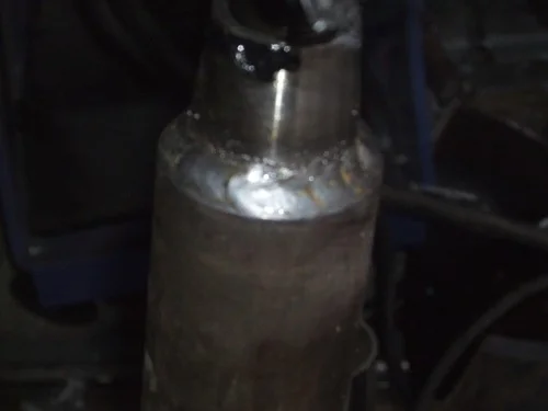

Now that I got everything I started to assemble the links.

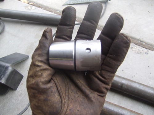

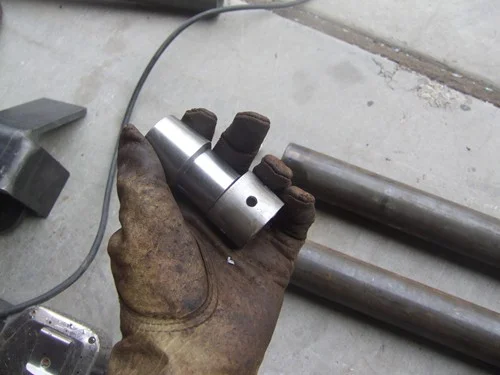

For the lowers they will be made out of 2" .250 wall tubing.

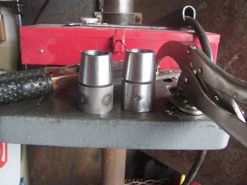

Unfortunately, there is not a threaded insert for a 1x14" thread in a 1.5" ID tube readily available. So it was time to make things work.
I got some 1.5" x .120 wall DOM and made "spacers" for the threaded inserts that I have. I drilled some holes in the dom to tack it to the threaded bushings. Seems to have worked out well.
I did have to spend some time polishing the dom to make it fit in the 2" x.250 wall chromo..

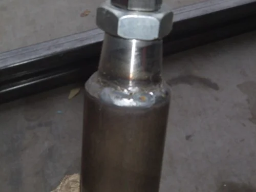

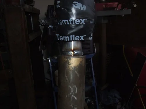

Once I was able to put the threaded inserts in the 2" tubing I ran a single pass to make sure that the 1.5" dom was welded to the threaded bung and then I completed another pass to make sure that the whole shebang was welded together..
I am still trying to convince myself that I need to use the 2" x .250 tubing for the bushing instead of teh 1.75 x .120 tubing..
The bushings will be at the lower axle end so they will see abuse. But if it matters for a bushing I do not know. It will be supported from the inside..
well... very.. but it won't weigh much more than the leaves did and honestly, I would rather overbuild and not have to consider any issues when my wife is driving the truck at 75 down the highway..
