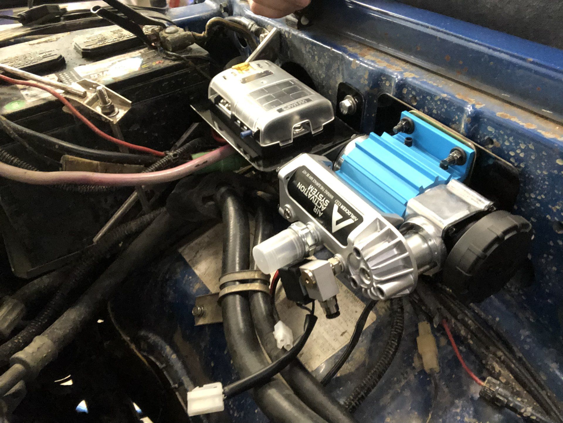

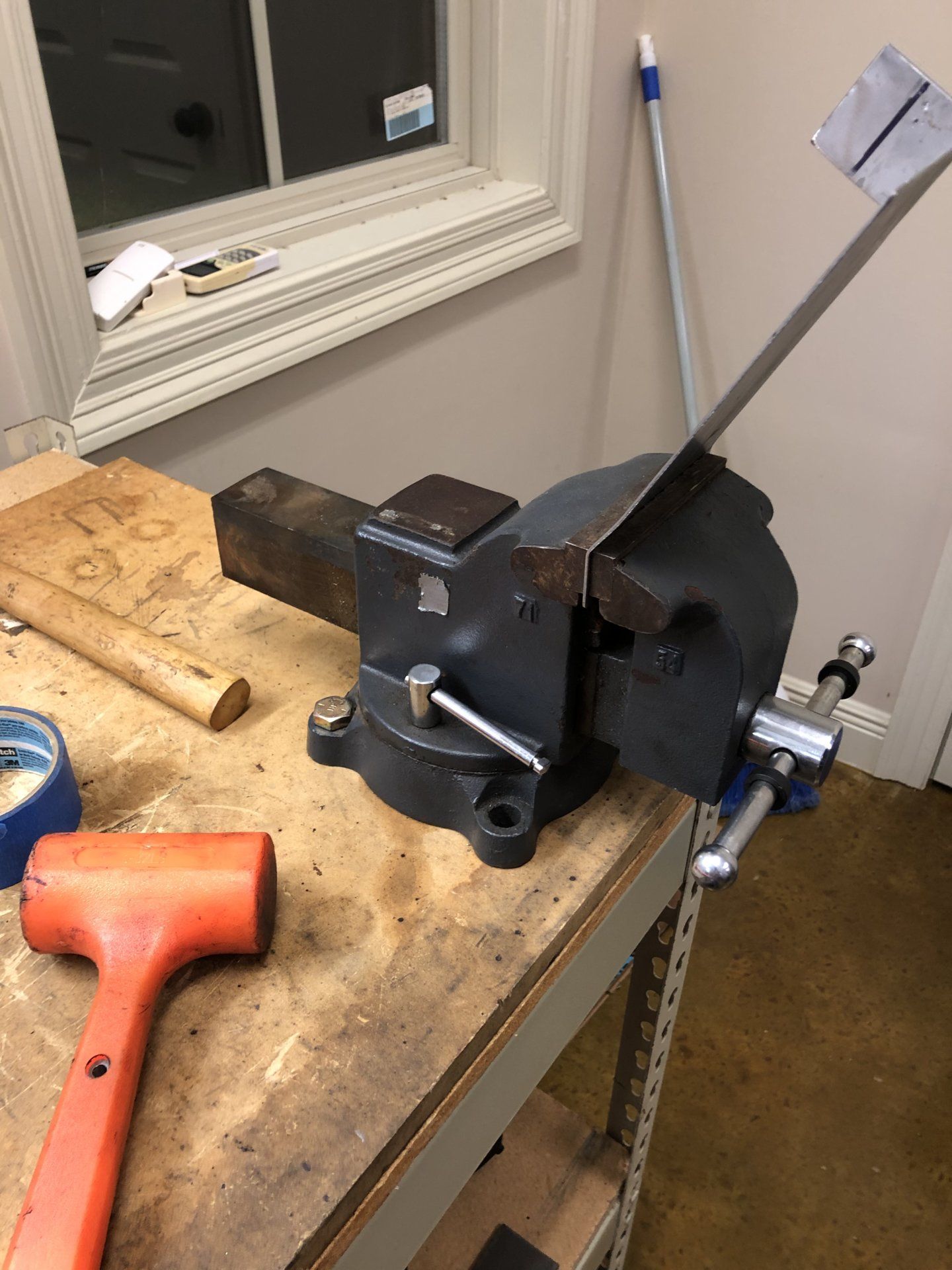

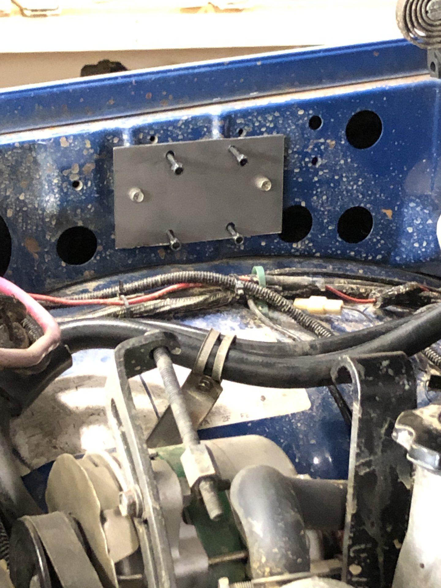

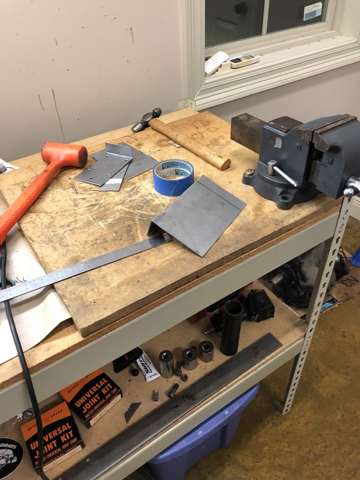

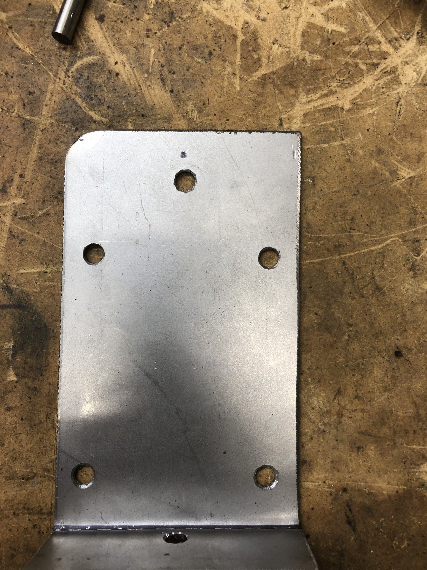

I’ve been working in 30min sessions due to life and work so progress has been slow. I spent some time making fuse panel and compressor mounts. Of course it took way longer than expected but I’m happy with the outcome. They are 16ga steel from Lowe’s. It bends well but is sturdy. The vise and a dead low hammer worked well with nice 90deg bends. The radius of a quarter made a nice round corner on the bracket corners. A 60grit flap wheel on my angle grinder made short work of the corners. Painted them and got everything mounted today. The arb wiring loom is nice but will need some modifying to work with our dash lights. The fuse block wasn’t mandatory but I really wanted to clean up the terminal connections.
Finally mounted up the block and compressor mounting today and worked some on the wiring.

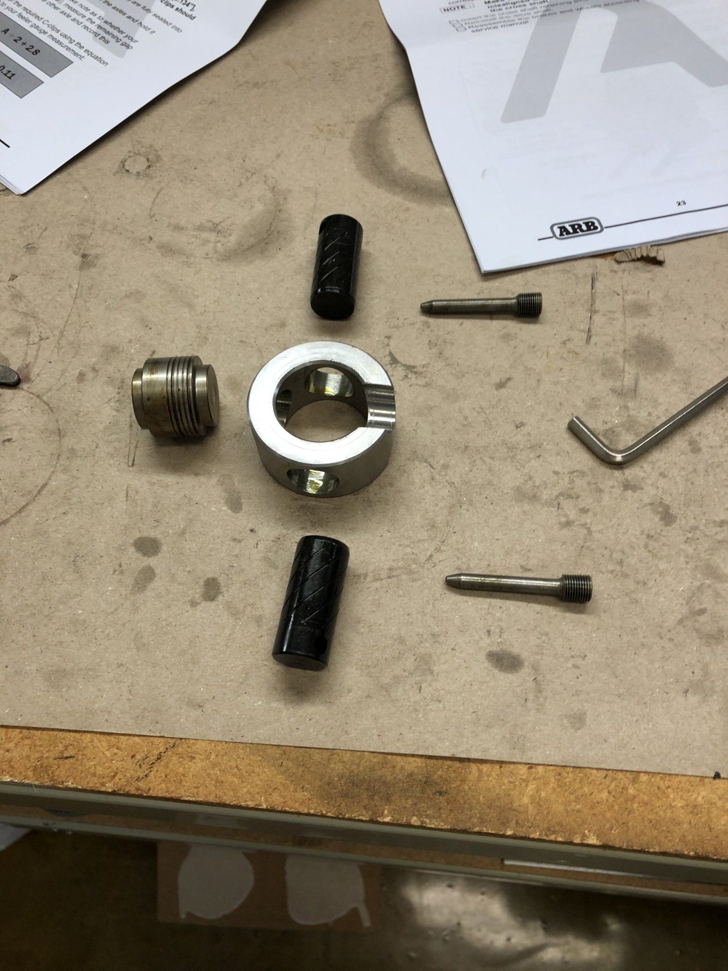

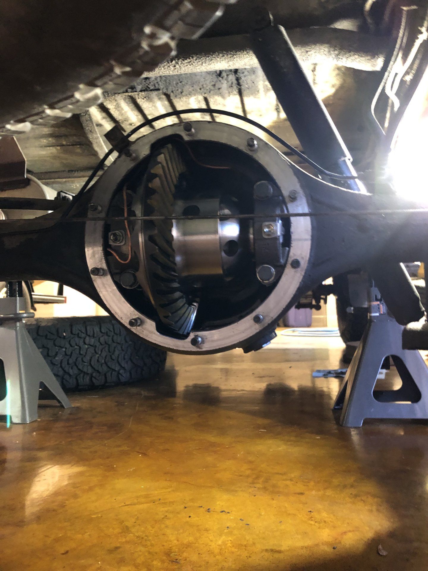

Earlier this week got the third member back in.
First installed the 2.8mm c clips per directions. But with a feeler gauge and math the 3.0mm ones worked better. Basically you measure the space between the axle end and thrust block with a feeler gauge. This showed I needed a 2.99 clip. It’s a snug fit but talked with arb this morning as long the block slips in it should work.

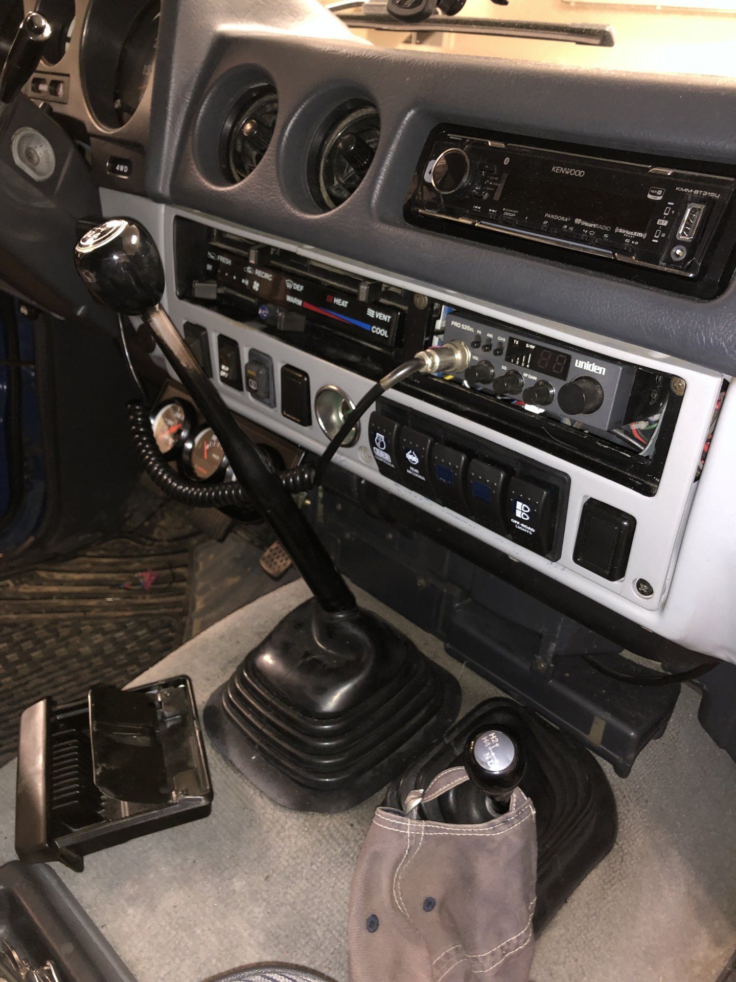

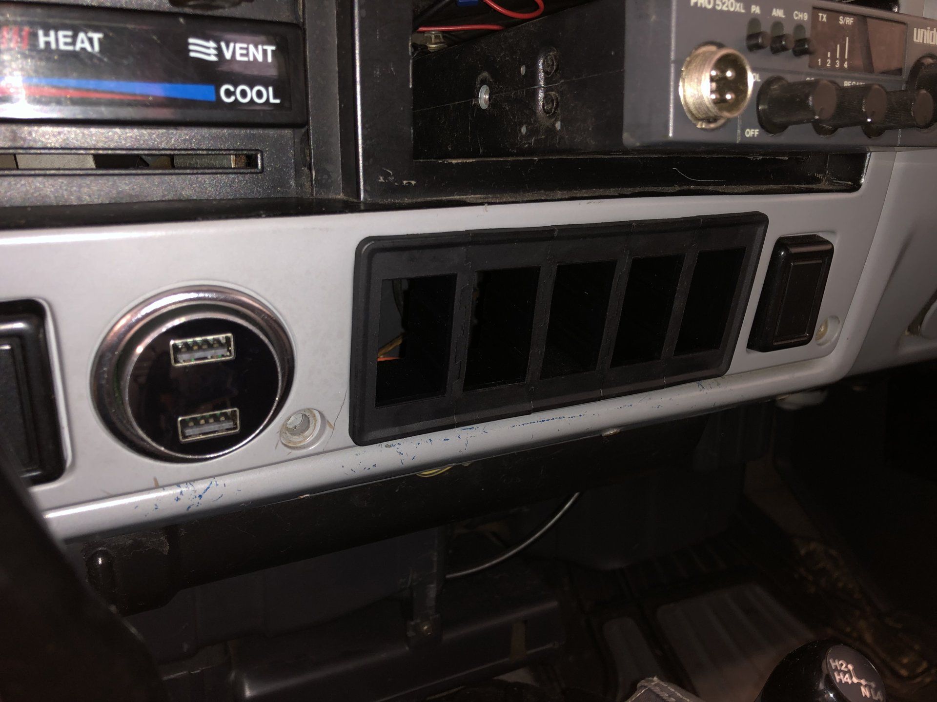

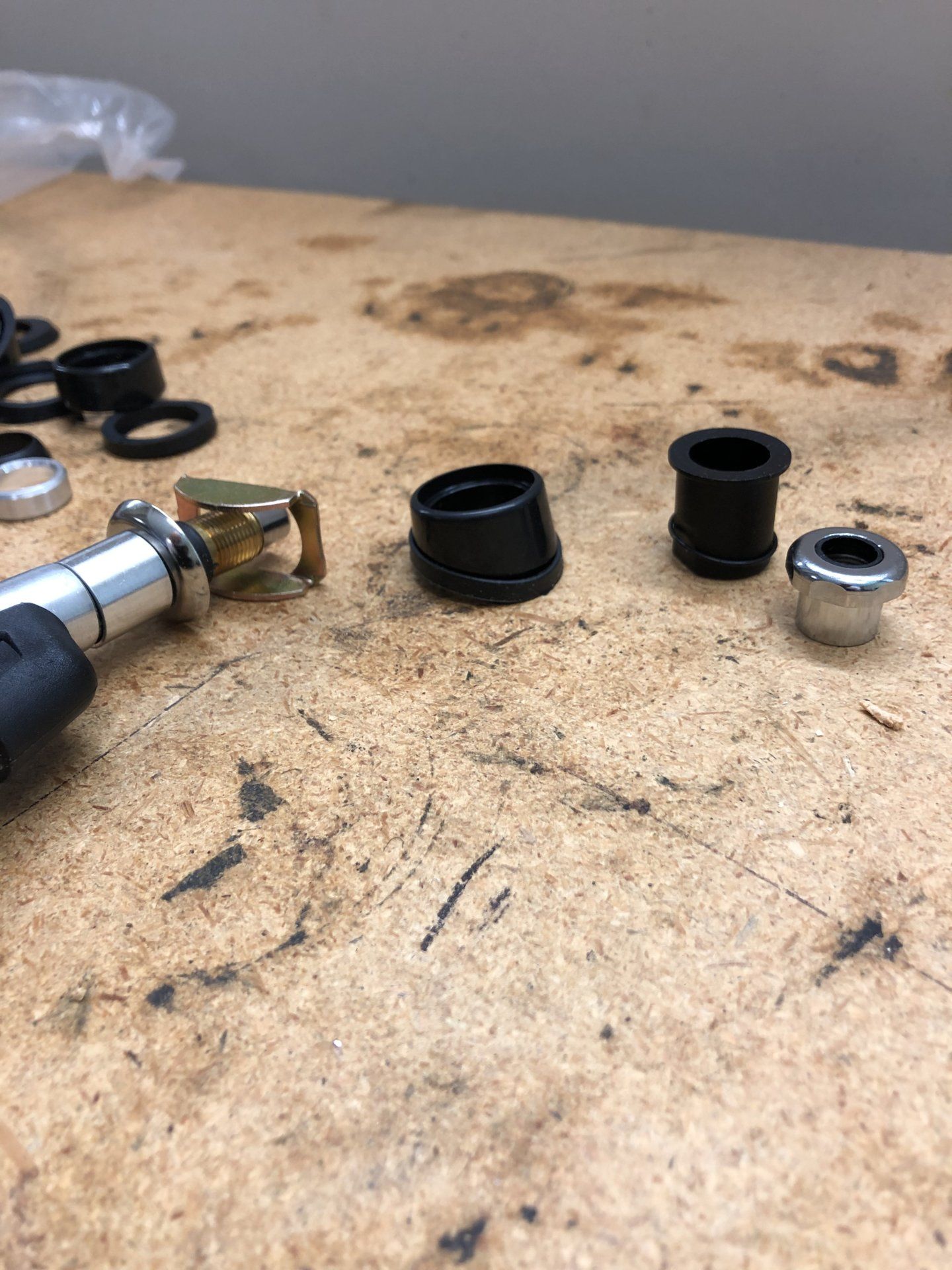

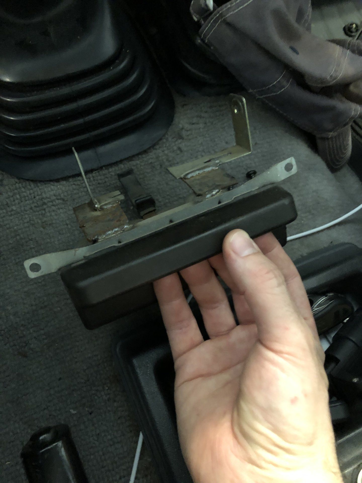

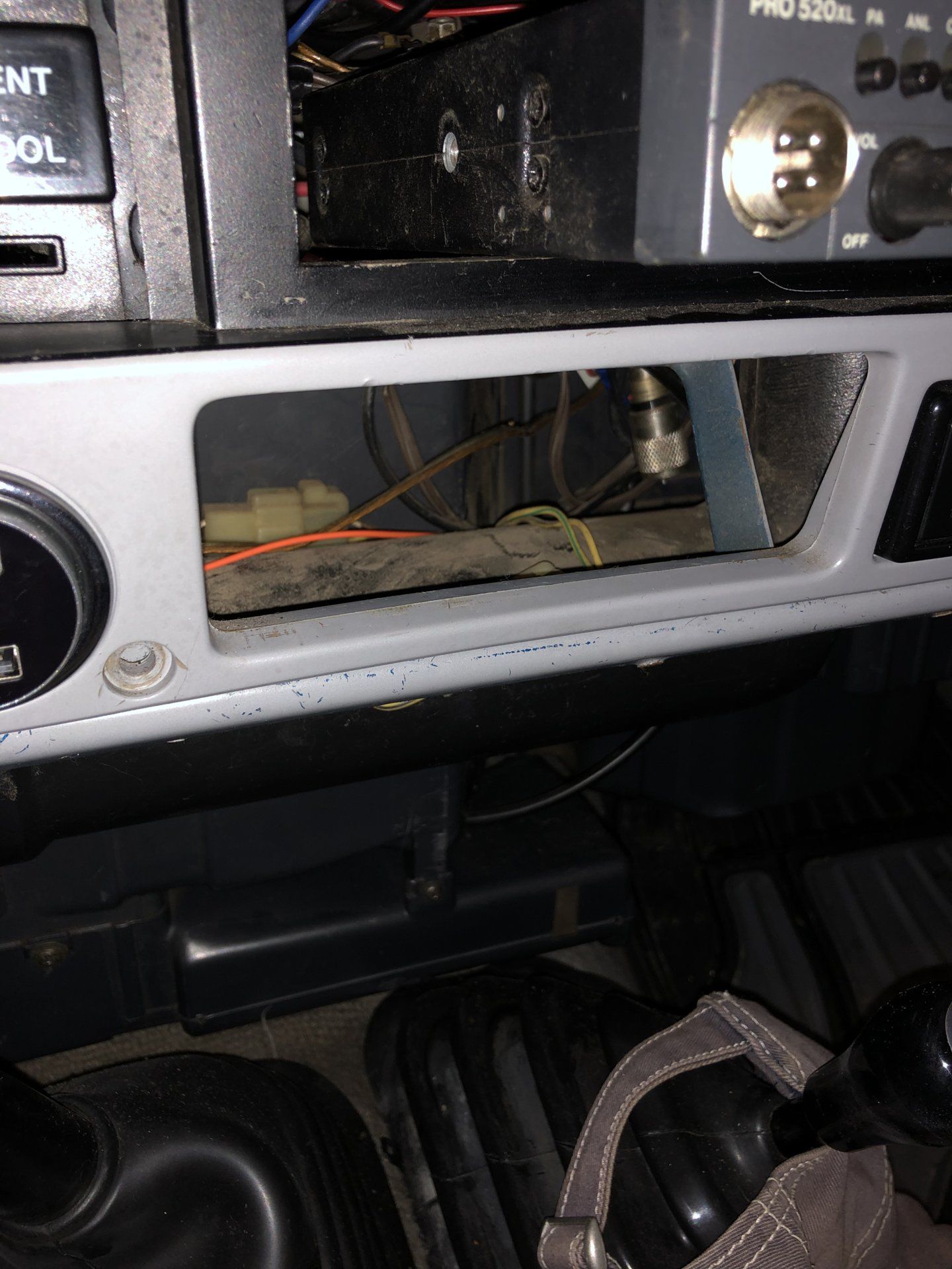

Next up is all the wiring. I’m installing some lights on the bumper and wiring up my gauge lights to the dash lights at the same time. There was a pic a while back on Facebook that showed switches mounted where the ash tray goes. Turns out these little blocks just pop right in without cutting anything. There is a small gap but barely noticeable once the switches are centered.
Spoiler, I’ve got a fun button now.
I spent most the day doing wiring work. Not a lot of fun pics of that.

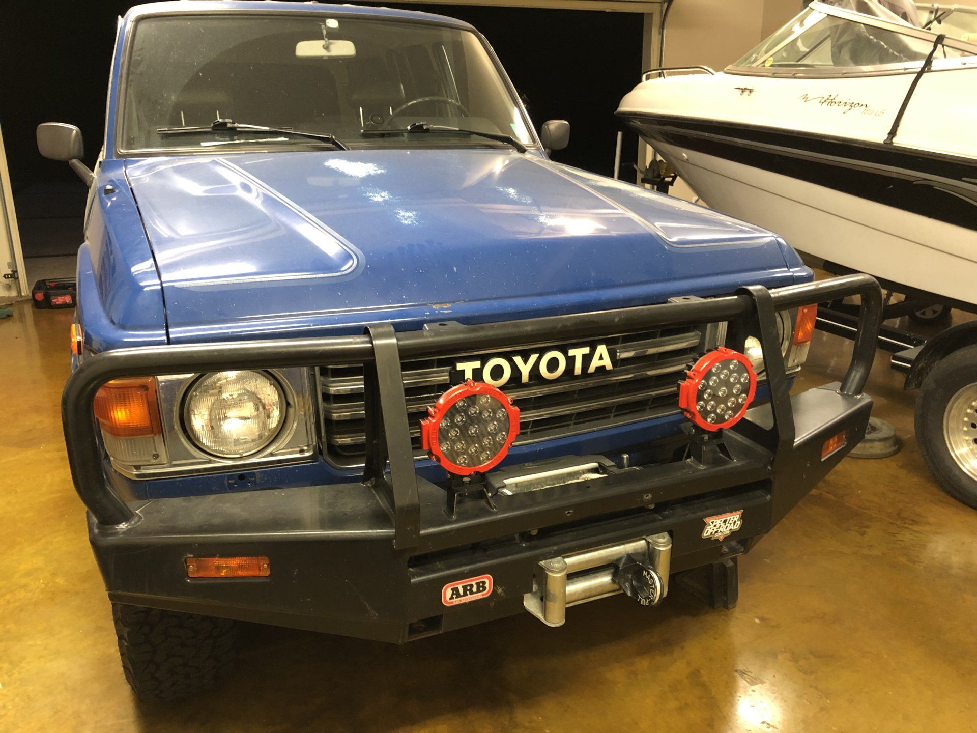

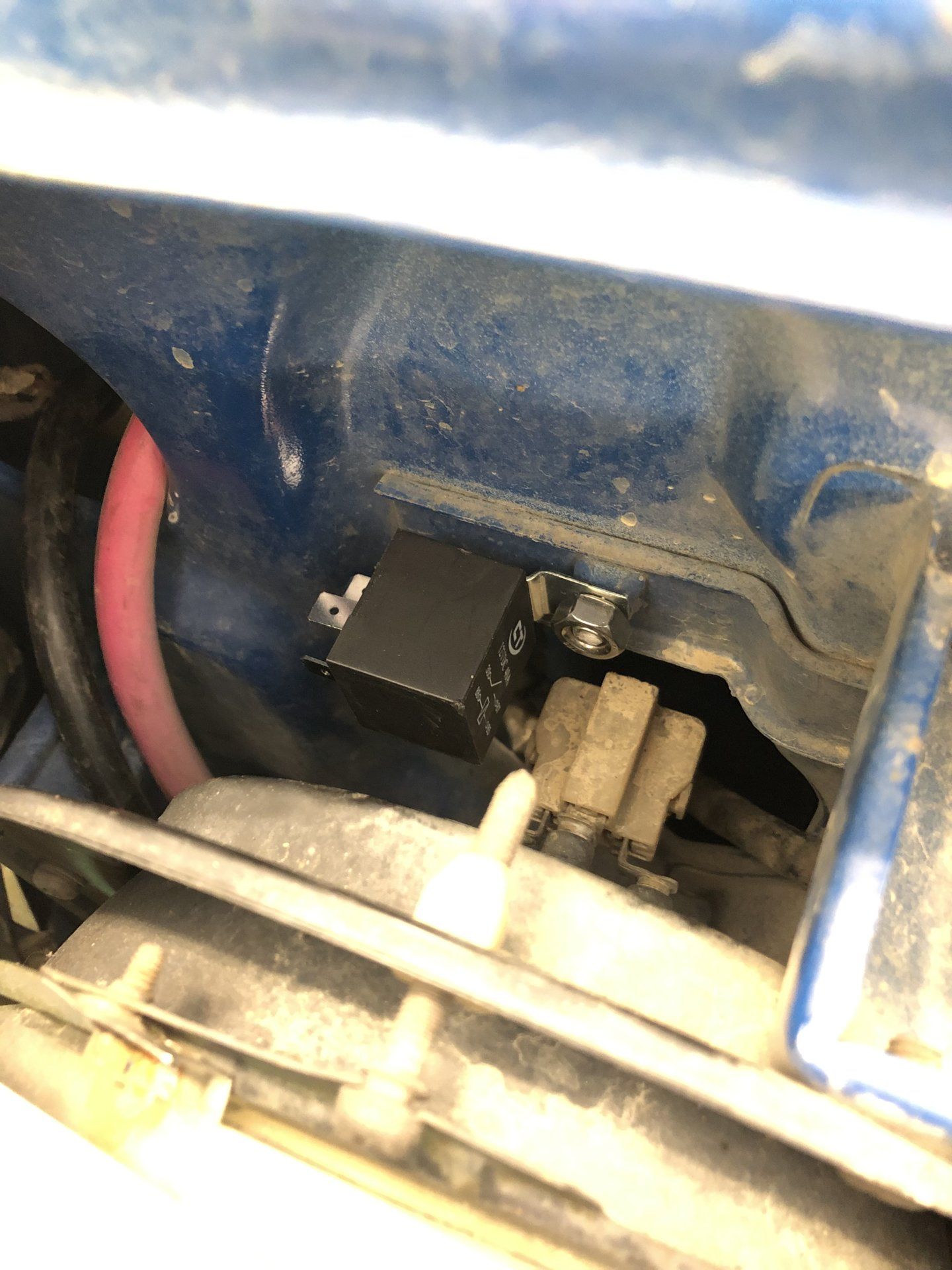

Wired up these amazon special lights. I used a relay and put it behind the headlight.

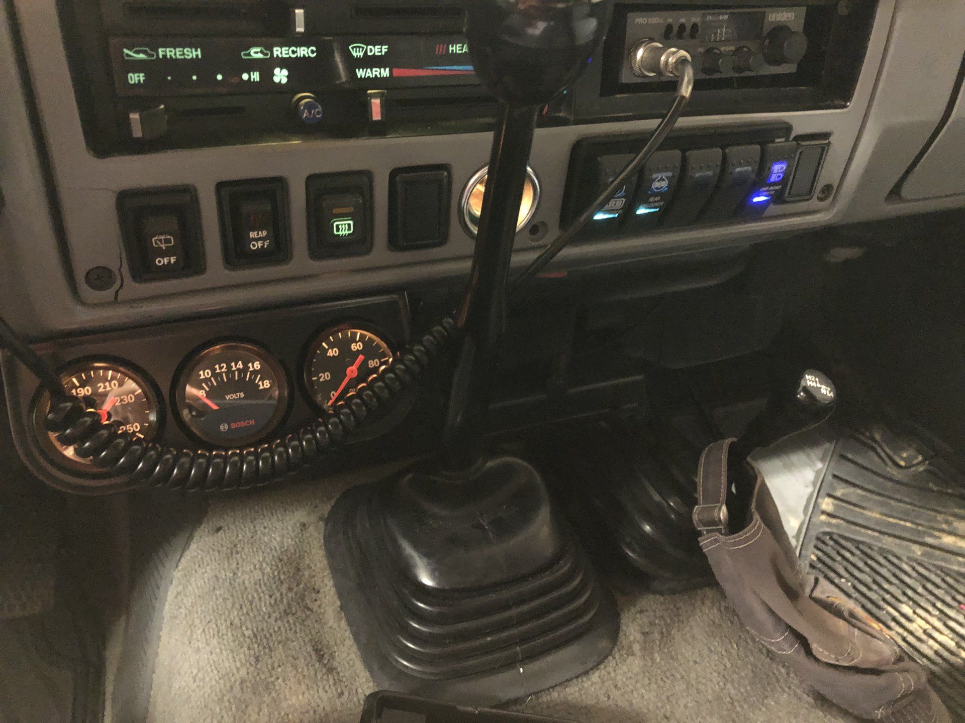

Like others a used the cigarette lighter dashlight circuit for backlighting with both the switched 12v and ground. The cigarette circuit was used for the switched 12v power to the arb wiring harness also. For the ground to make the switches light up, i left a ground from the arb harness unplugged. For the backlight ground I made a simple harness to plug into each switch that connected to the cigarette lighter circuit. The green wire is the ground FYI. Red one gets 12v when the headlight switch is on. I left the blue/white connected to the cigarette lighter circuit.
Part of what took so long was wiring up the Bosch gauge backlights also. Figured now was as good a time as any.

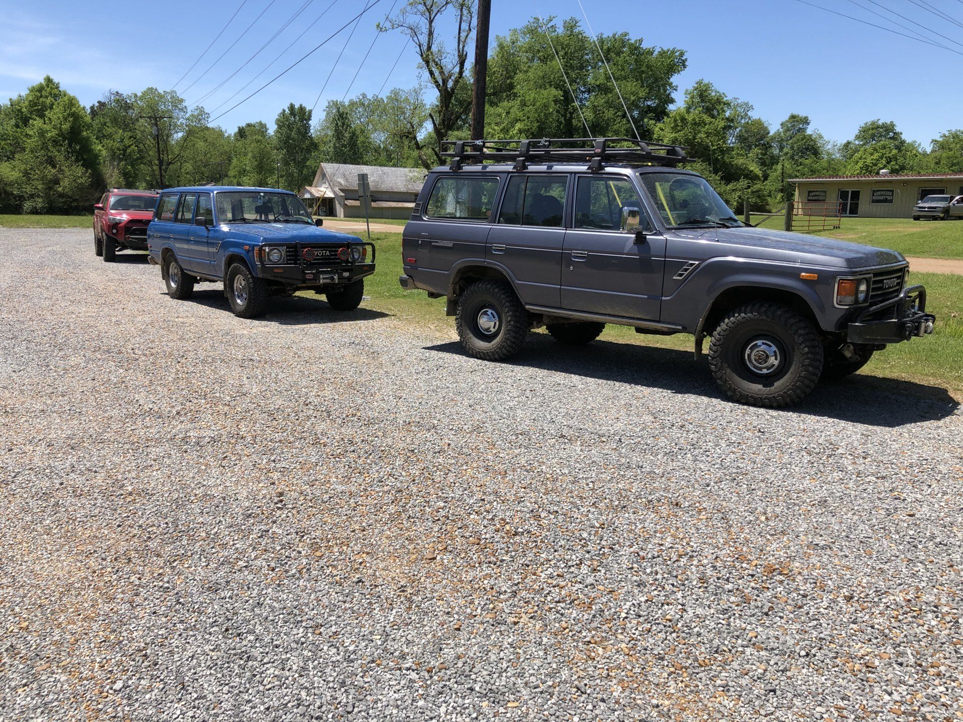

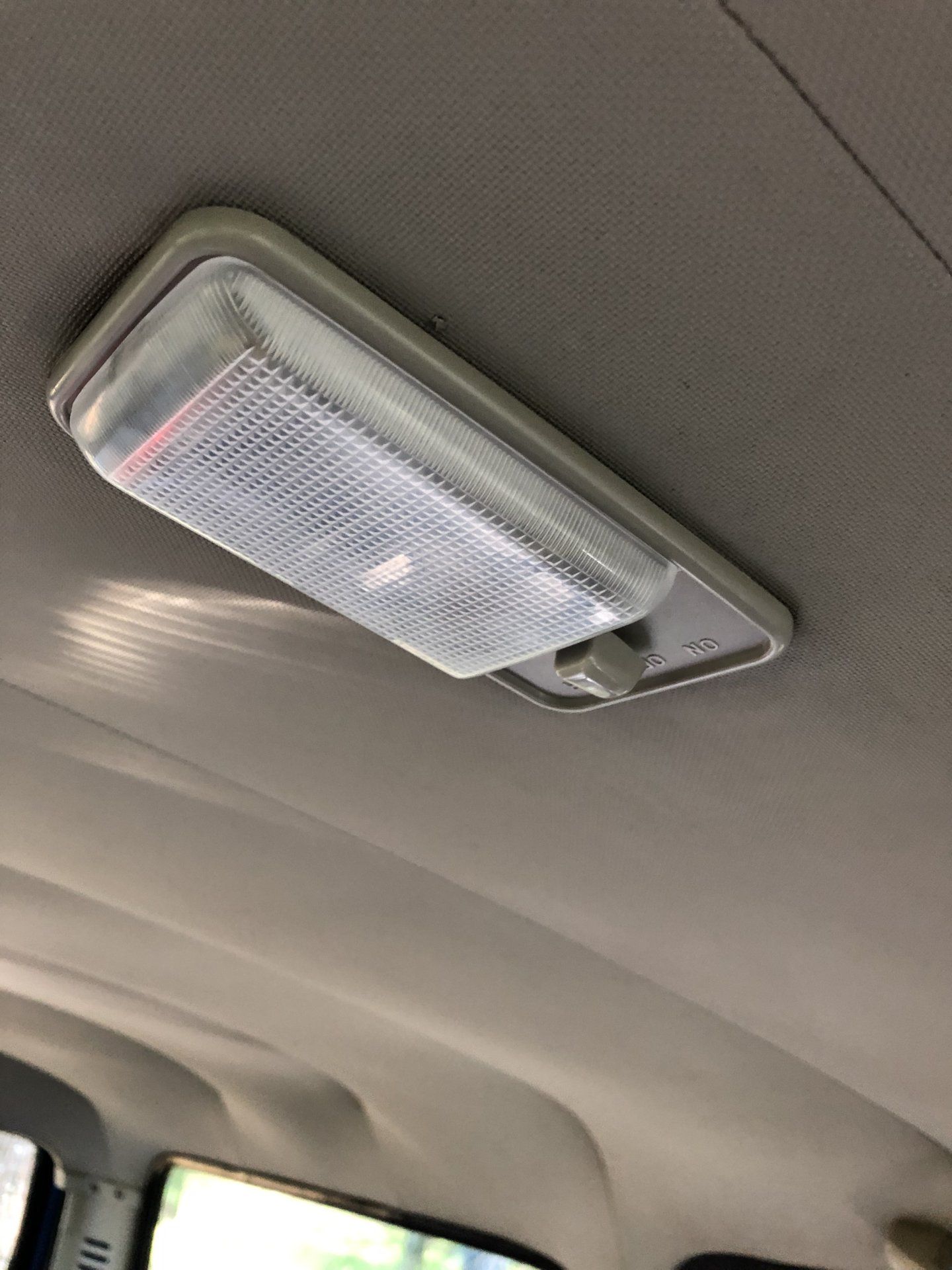

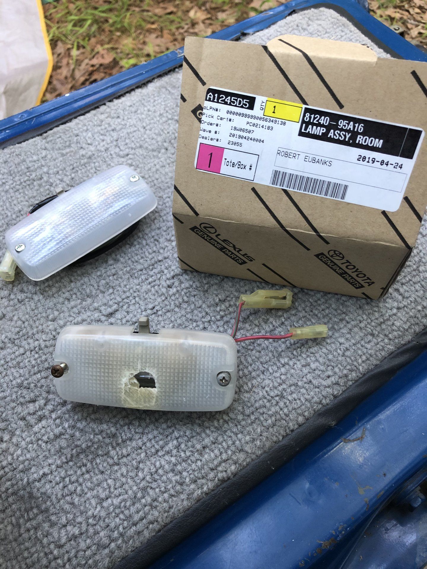

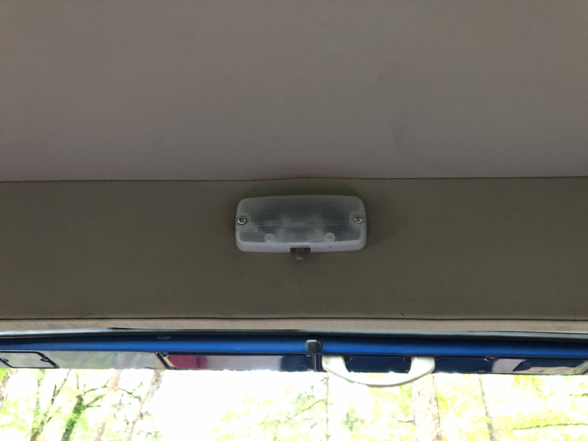

Cottonland Campout was a blast. Bluebird did great the two drive to and from Canton as wel as all the dirt roads @wngrog took us down. I had a bologna sandwich at the Ebenezer store and it was delicious. My new dome lights came in the day before I left so they went on when I got there.

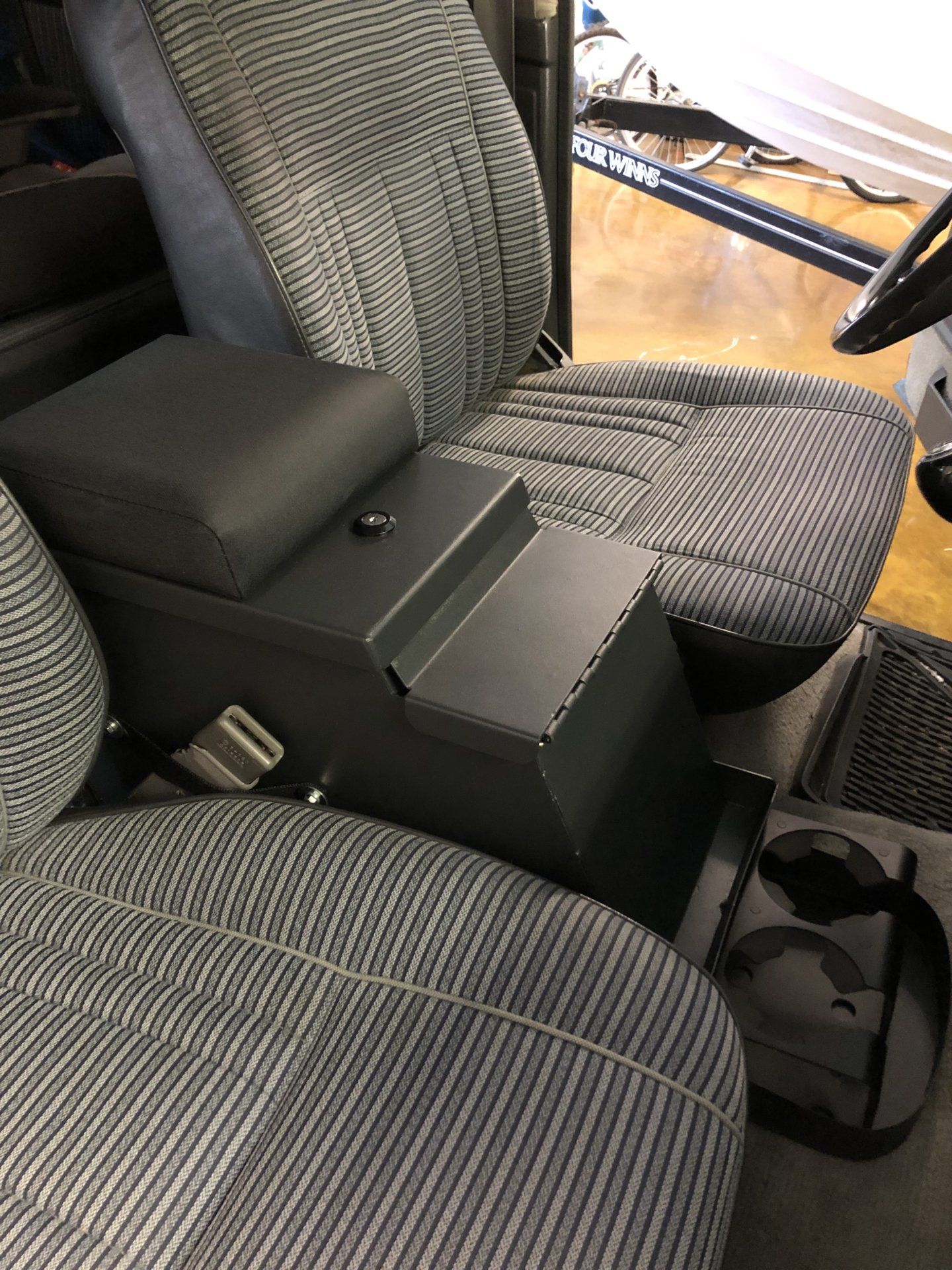

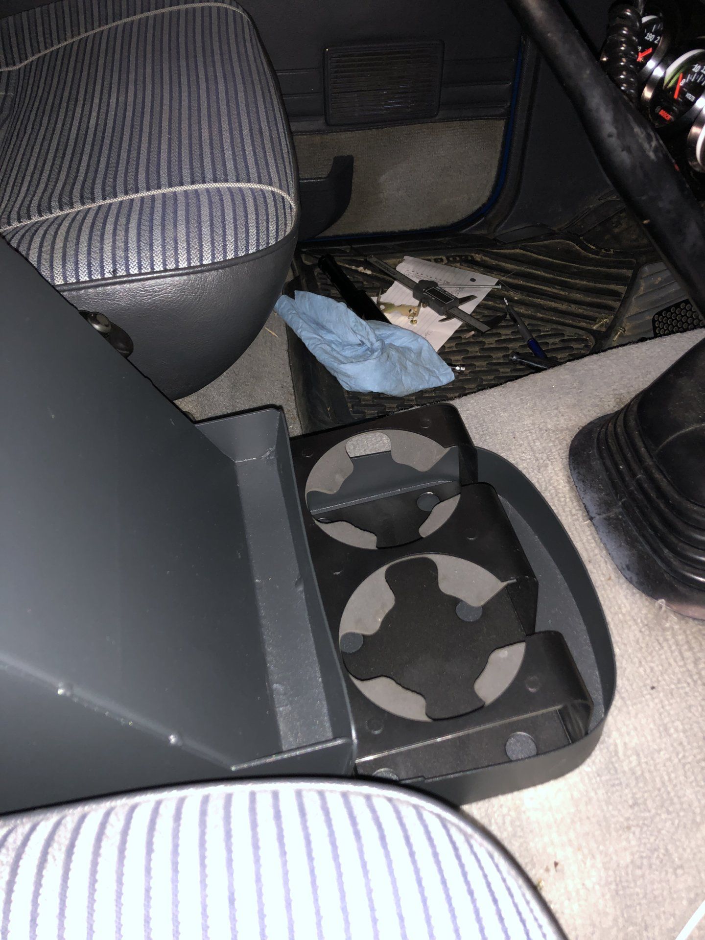

I installed a Smittybilt console with a tuffy drink holder. I drilled four holes in the floor of the console and got some longer bolts to use the stock mounts in the floor

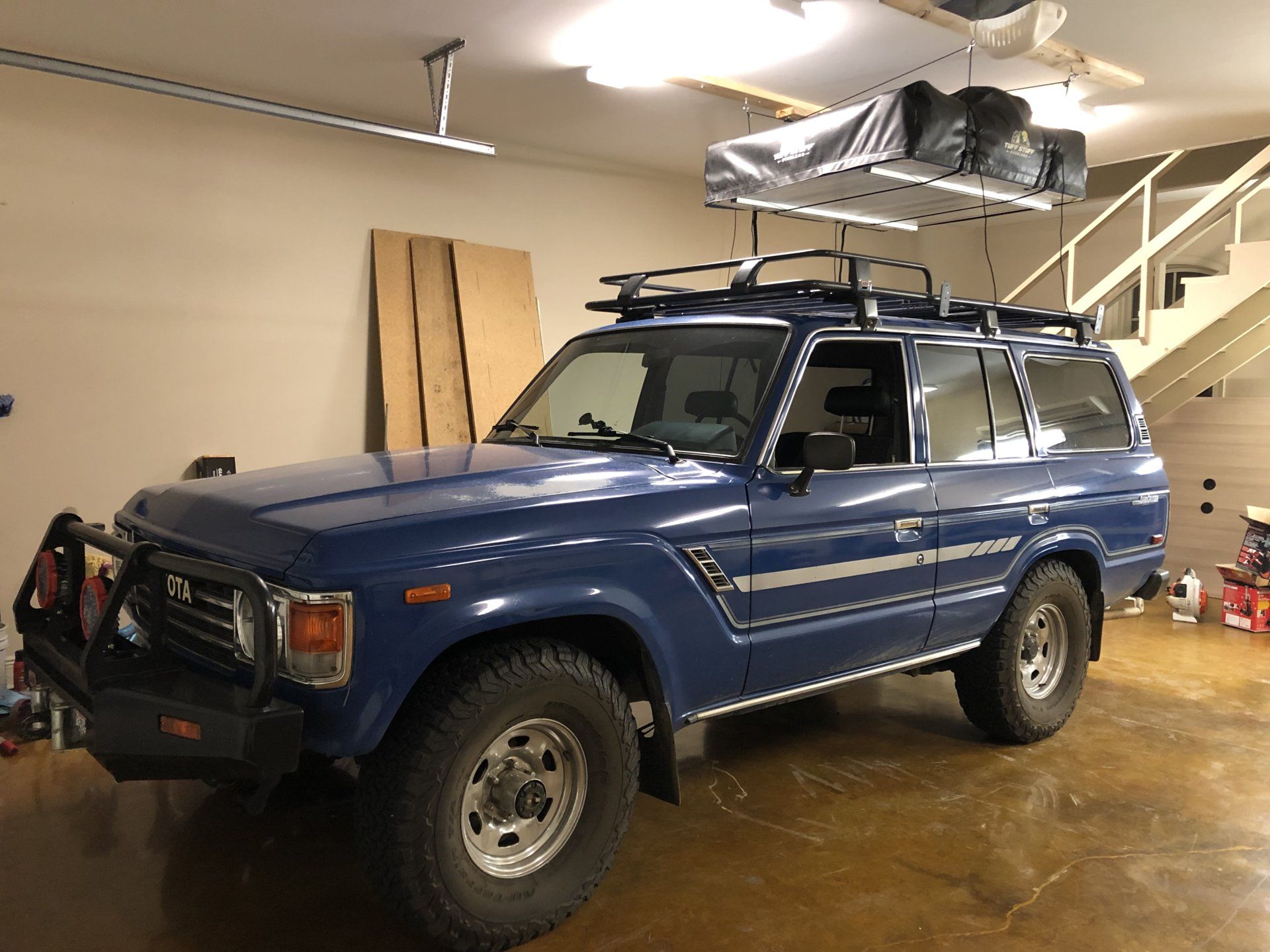

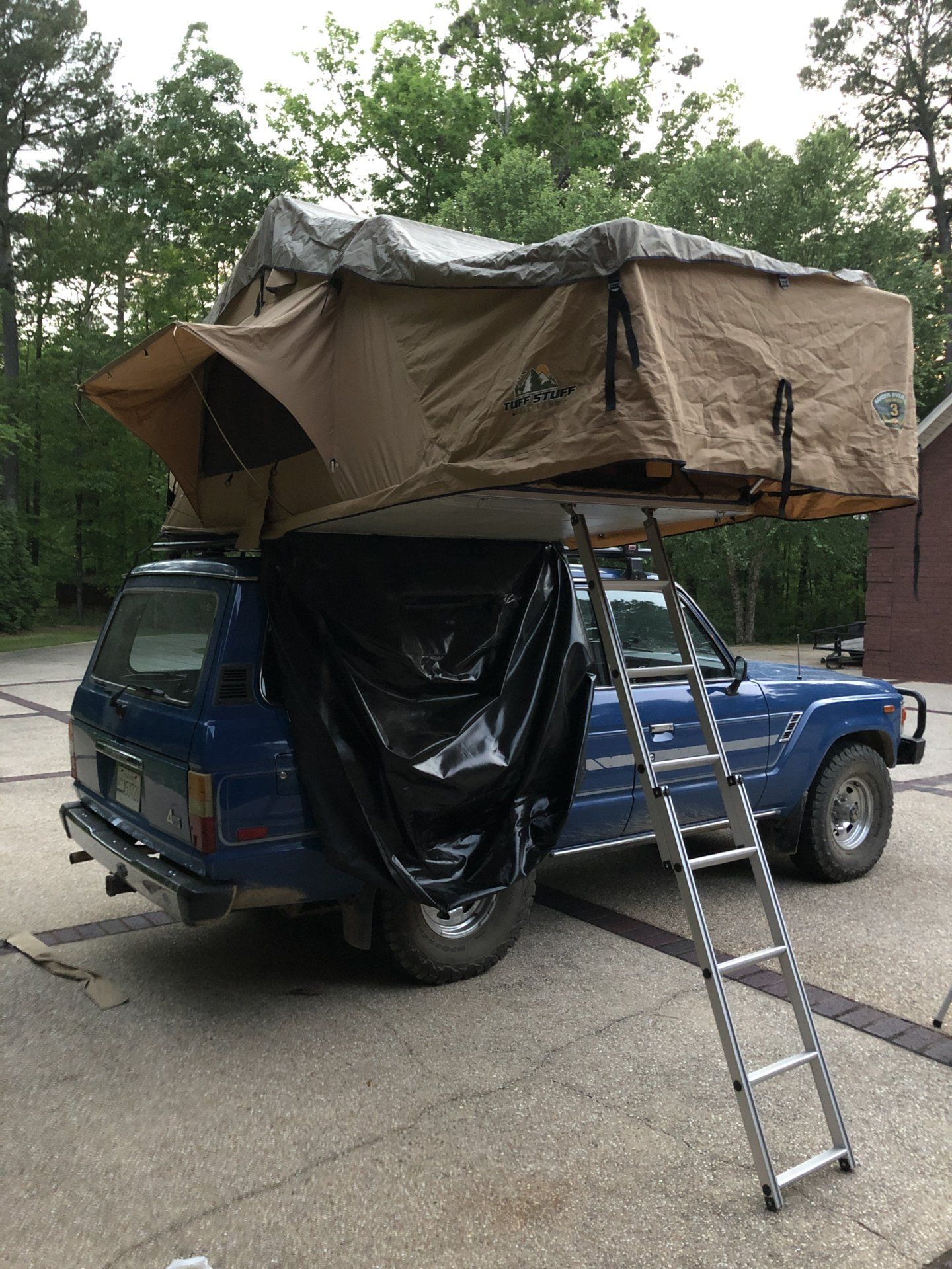

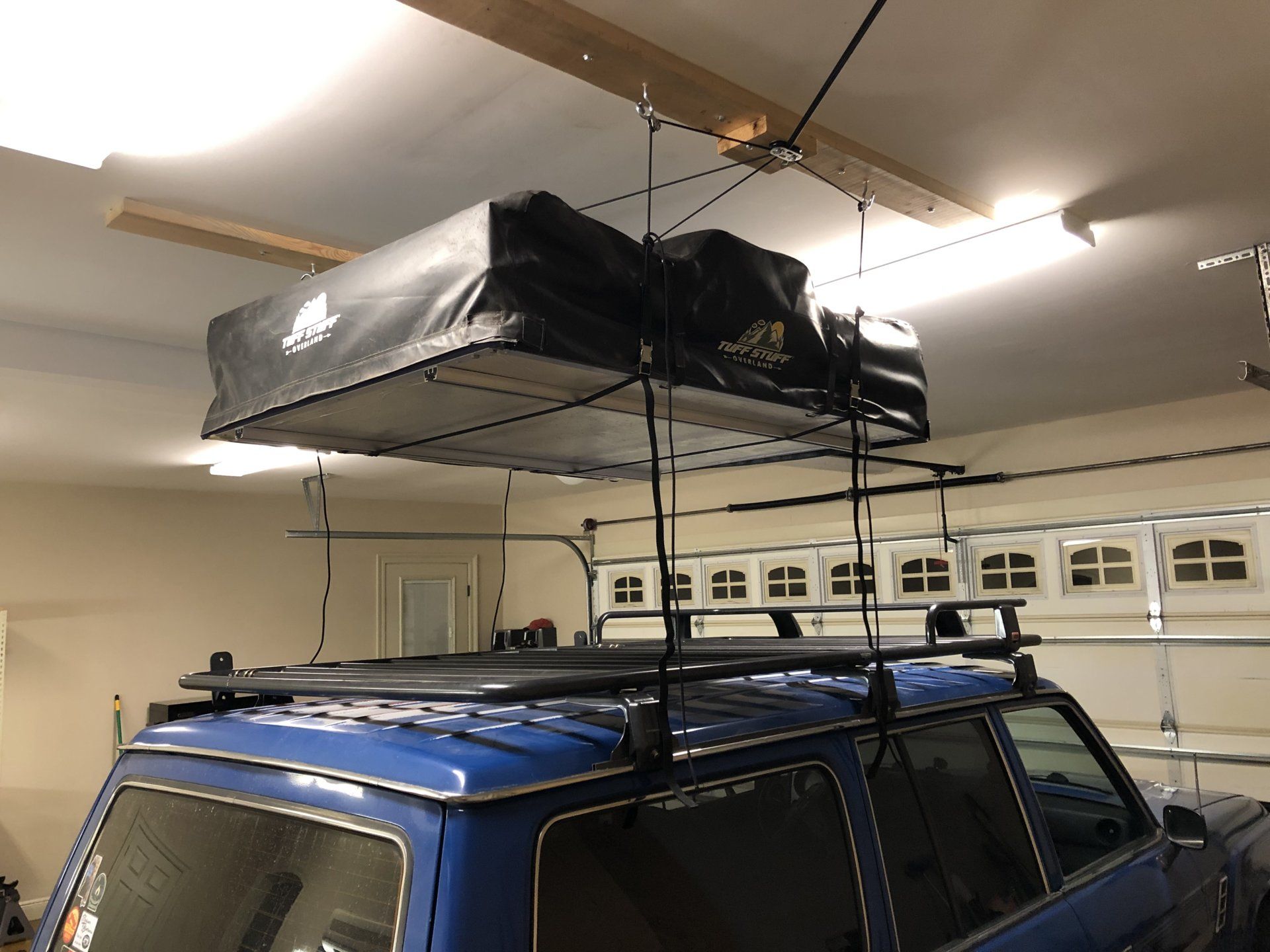

The next project was installing a Jeep hardtop lift to get the tent on and off by myself. It took a long long time. I measured a ton because it needed to be in a particular area but also be somewhat centered visually from two sets of lights. In the end works awesome. I highly recommend this method on tent storage.
This is as low as it goes given where I put the eyelet for the line the raise and lower. Good enough to go on a trailer or sawhorse.
It’s made by Hoister direct and uses a pulley loop reduction system to decrease the effort to raise and lower. It has a builtin lock that if you let go it should just stop movement. I haven’t tried it but it takes enough effort to get it to lower I don’t worry about it falling.

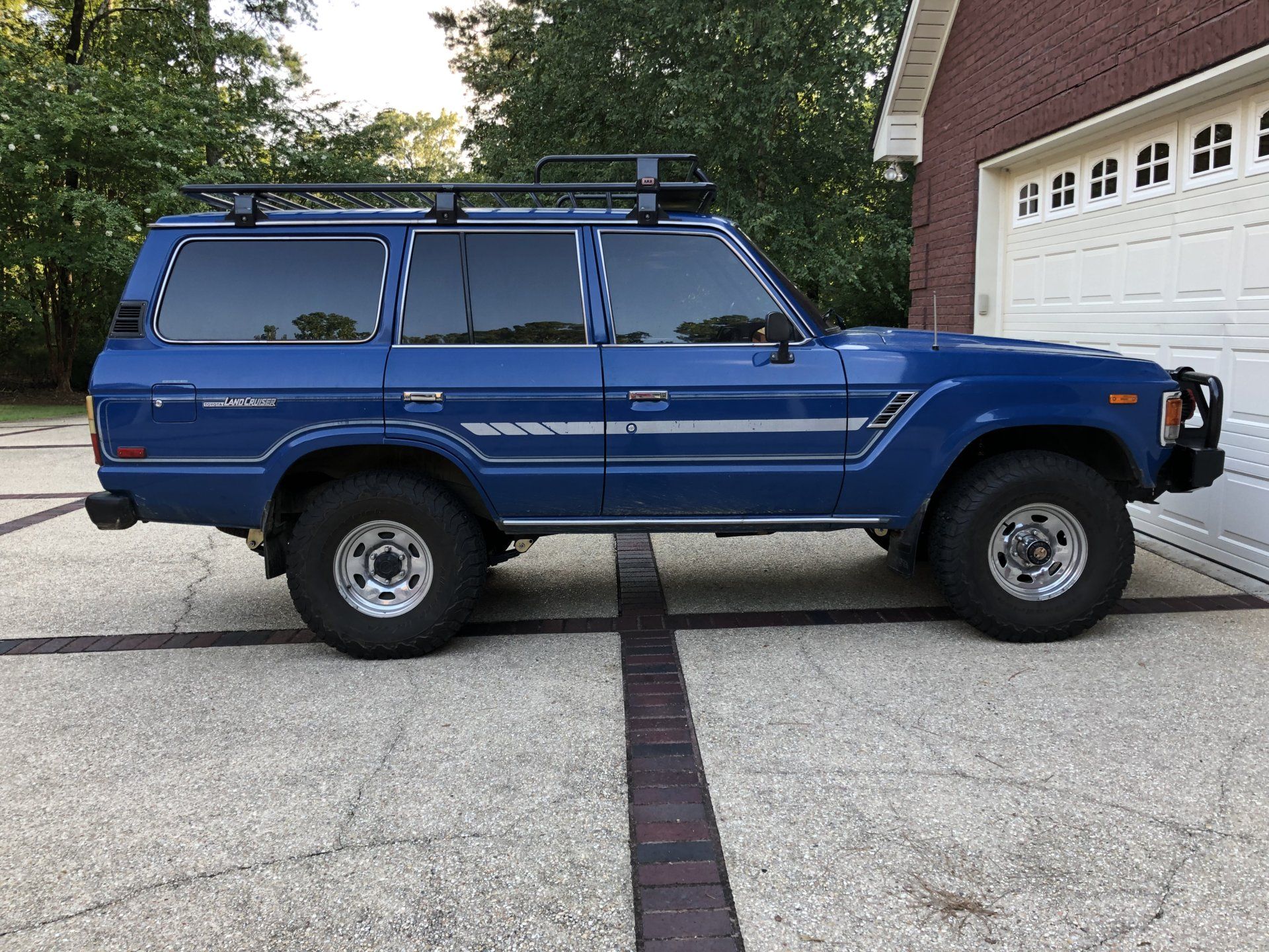

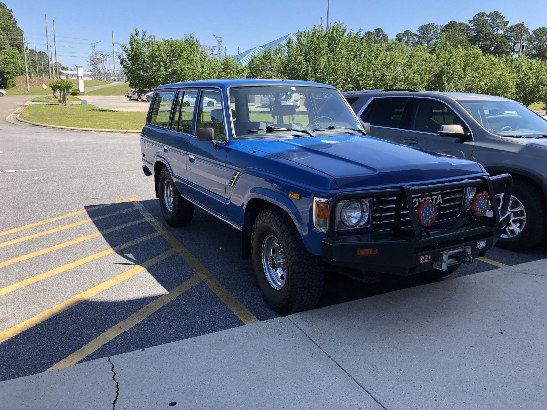

First off, a huge thanks to @wngrog, Bluebird got a lift. It was a pain but certainly not as bad as some the stories I have read on here. I went with OME medium and love it. I wish this was the first thing done to the truck after purchase. The old suspension was so worn out it was scary in turns.
We only had to cut two shackles. Bonus I only hurt myself once. Cut my finger which is healing nicely now.
Before
After.

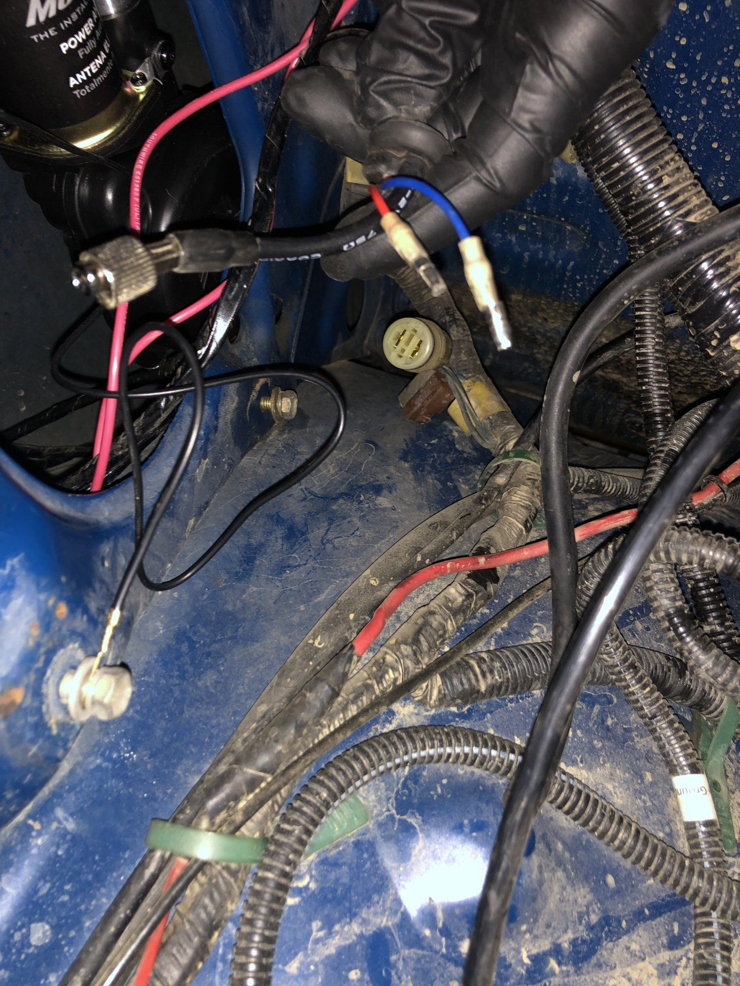

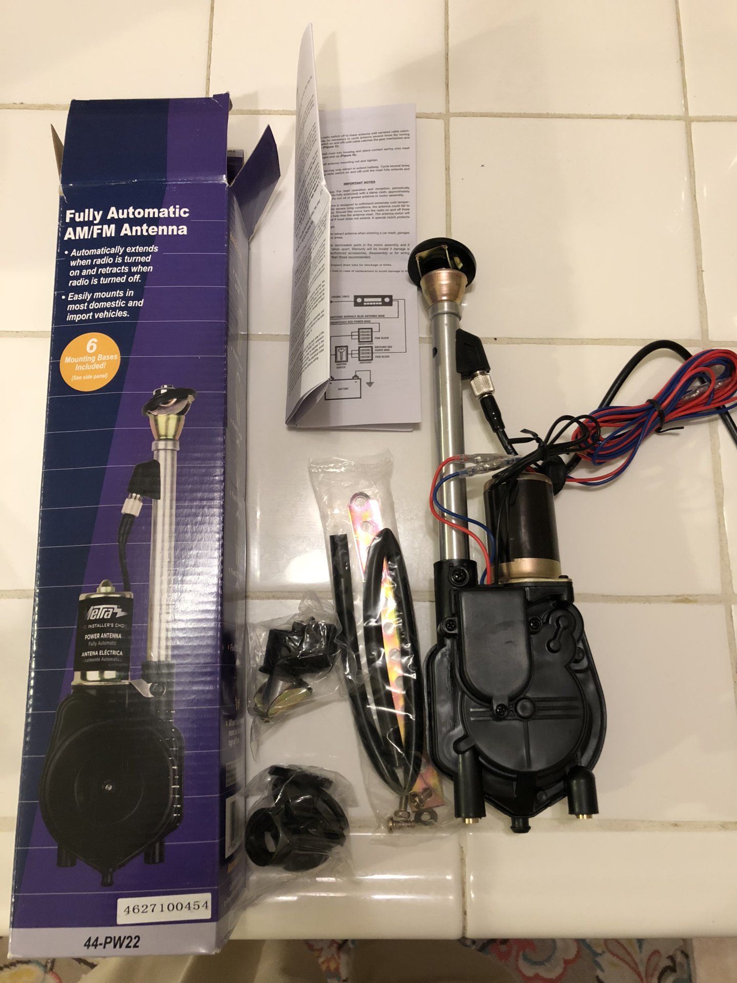

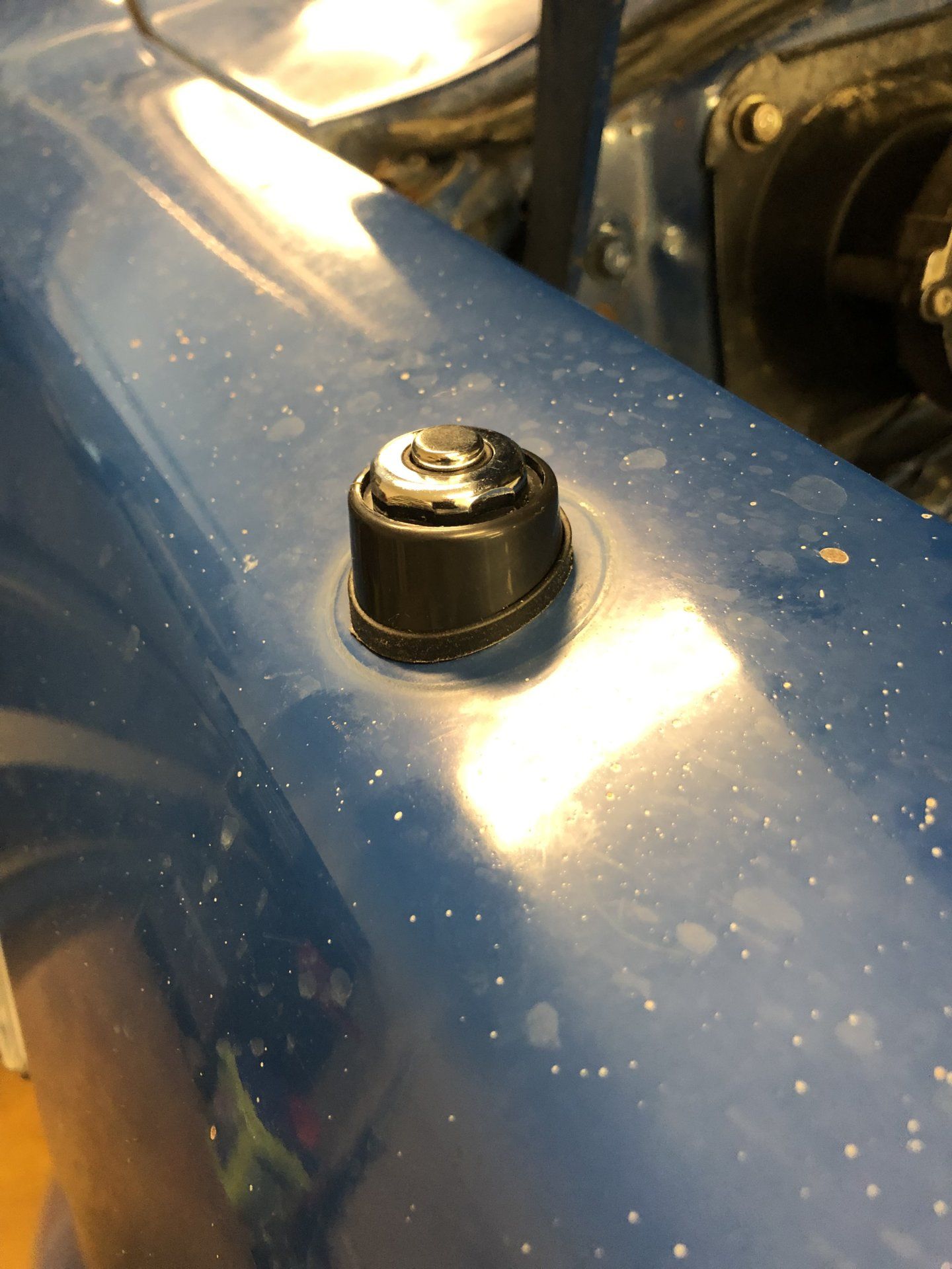

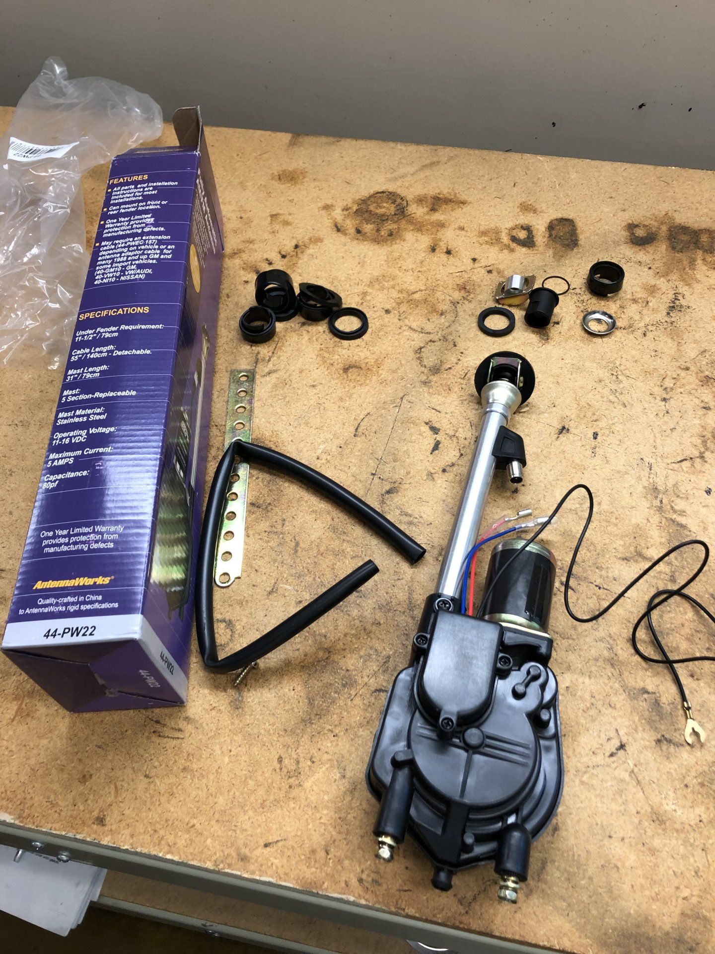

Got around to swapping in the replacement power antenna. It’s a universal one that come with several different mounting pieces.
I grounded it to the windshield washer reservoir bolt and had previously run a power and radio on wire. There’s a switch in the glovebox to force it off to use while off-roading. I’ll be sure to remember it next time.

Looks great! I read through the thread and may have missed it, but what size tires are you running?
