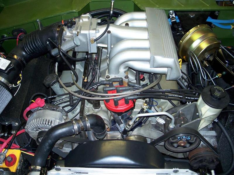

You have a GT40 intake on a 351 that pumps out over 400hp?
Thats what the builder said. But, It was carb'ed initially. FWIW
SEFI Fuel Injected 351W, hydraulic roller motor, Ford Motorsports SVO aluminum heads, Hedman ceramic coated headers, Ford Lightening GT-40 upper and lower intakes. 30lb. injectors, Mustang cam :rolleyes:
