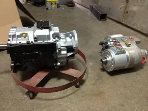

So now we have the body in place we are going to start mocking up the trans and t-case. So a NV4500 and an Atlas 4speed are in order! These will mated to a custom TPI Chevy V8!!
Nice! Looking great. Love the work y'all do.
Look at that atlas!
Make sure you have the cast steel NV4500 tail housing. Don't think the aluminum one would hold up to the weight of that atlas.
