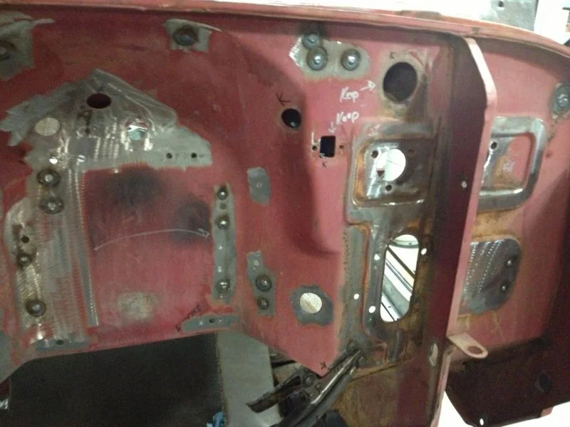

RLMS said:
We are filling all the factory holes in the firewall and dash!
Justin
Why why why??? :)
