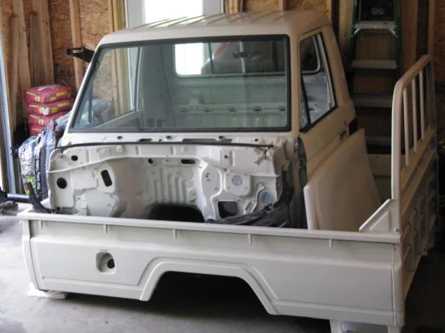

After many requests for a build thread I figured its about time to start one. This is my first build thread so bear with me a little. I'm not tooting my own horn I'm just trying to help others who want to go down a similar road.
I know there are a bunch of these trucks being built right now but I only know of one other one that is going on an 80 frame.
I'm in no rush to get mine done...as usual I have way to many irons in the fire.
Here's what I done so far.
Picked up the body in colorado...drove it back across country.
Stripped an 80 series down
Stretched the frame
Mounted the body on the frame.
I have all the driveline sitting on the shop floor...just waiting a few parts to arrive before I can mock it up.
I'm using a Cummins B3.3t/R151/splitcase.
I'm sure someone out there will argue that the cummins doesn't have enough power and the r151 is a weak tranny...but for the price I paid :flipoff2:. I have other options if this combo doesn't turn out the way I want.
For what its worth..the body sits on the frame pretty nicely. The back cab mounts almost line up with the mounts on the 80 frame. It provides a very good starting point
Here's a few pics of the progress.
Let me know what you think.

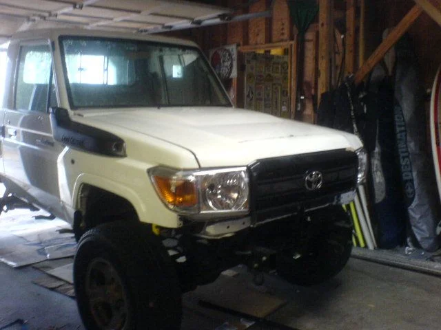

Can you post a front on picture to show how far the wheels stick out with the wider 80 series axles? I am doing the same exact build on a 62 frame, but have access to an 80 frame and drive train. I was led to believe that stretching the 80 series frame was more difficult as there isn't a long section that is straight. Also, was discouraged from using the 80 series running gear as the axles would be much wider? Opinions? Please post up as many details as possible. I just may change focus and put my 79 series body on an 80 series frame as the four coils and permanent 4-wheel drive are a nice option. Along with a more modern drive-train.

msgrunt...I'll see if I have some pics showing the tires...I will tell you this...its not as much as everyone thinks. The front tires don't stick out at all. The rear stick out about 1.5 inches...or a better way to look at it..the sidewall and one tread. I had the stock 80 wheels on it and the threw a set of 4runner wheels on it that were layin around. They don't stick out quite as far. They are an inch narrower. I'm not sure about the back spacing I didn't measure. You could run a narrower wheel with a bit less offset and skinny tire and I think it would stick out less than an inch. If you are really worried about it and like flares that would solve the problem.

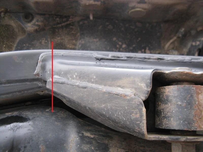

If you look at the 80 frame there is only one place that is straight that you can stretch it without a ton of work. Right in front of the rear links. You can cut it right where it straightens out and everything will line back up if you do it right. It took a long afternoon in the machine shop and I was done.

For others that may follow I took some pictures of where the 80 series frame is straight and I have to tell you, there isn't a lot of "straight" section of frame to extend, unless you cut back into the lower control arm mount. I guess you could cut further back into the control arm bracket as long as it is reinforced in the end. Swamprunner, where did they cut your frame? It doesn't look like they went into the control arm mount. I'm going to post this on the 80's forum to see if anyone there has extended an 80 frame
The second picture really shows where the taper starts and it looks like the frame only gets straight an inch or so into the lower control arm mount.
I cut it right at the front weld...basically that forward line on your first picture. Everything behind that line is straight and you only need the rear to be straight. The cut is right at the start of the angle so the extension piece lines up fine. I will try to get some pictures this week to better illustrate how it was done.
