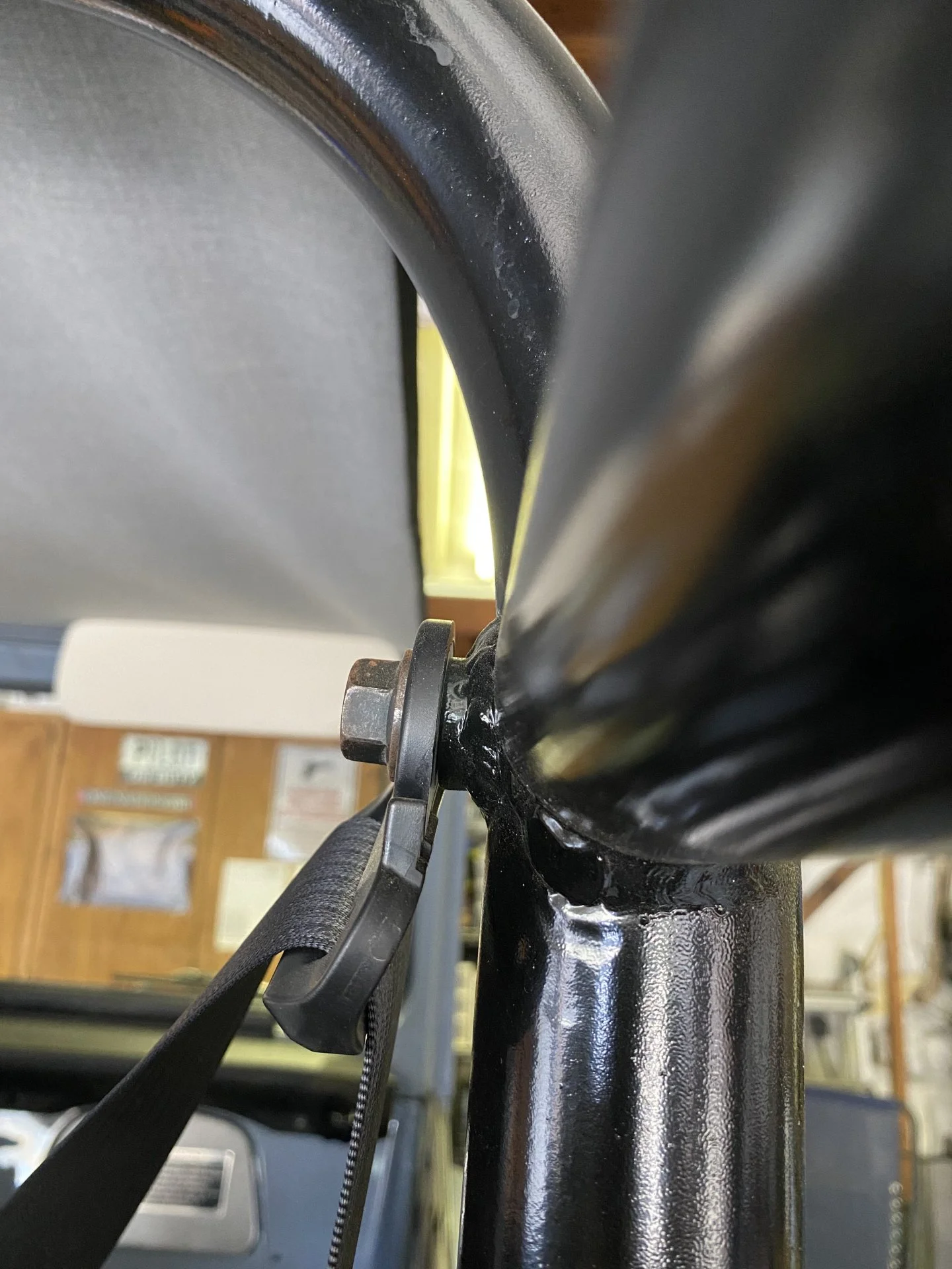

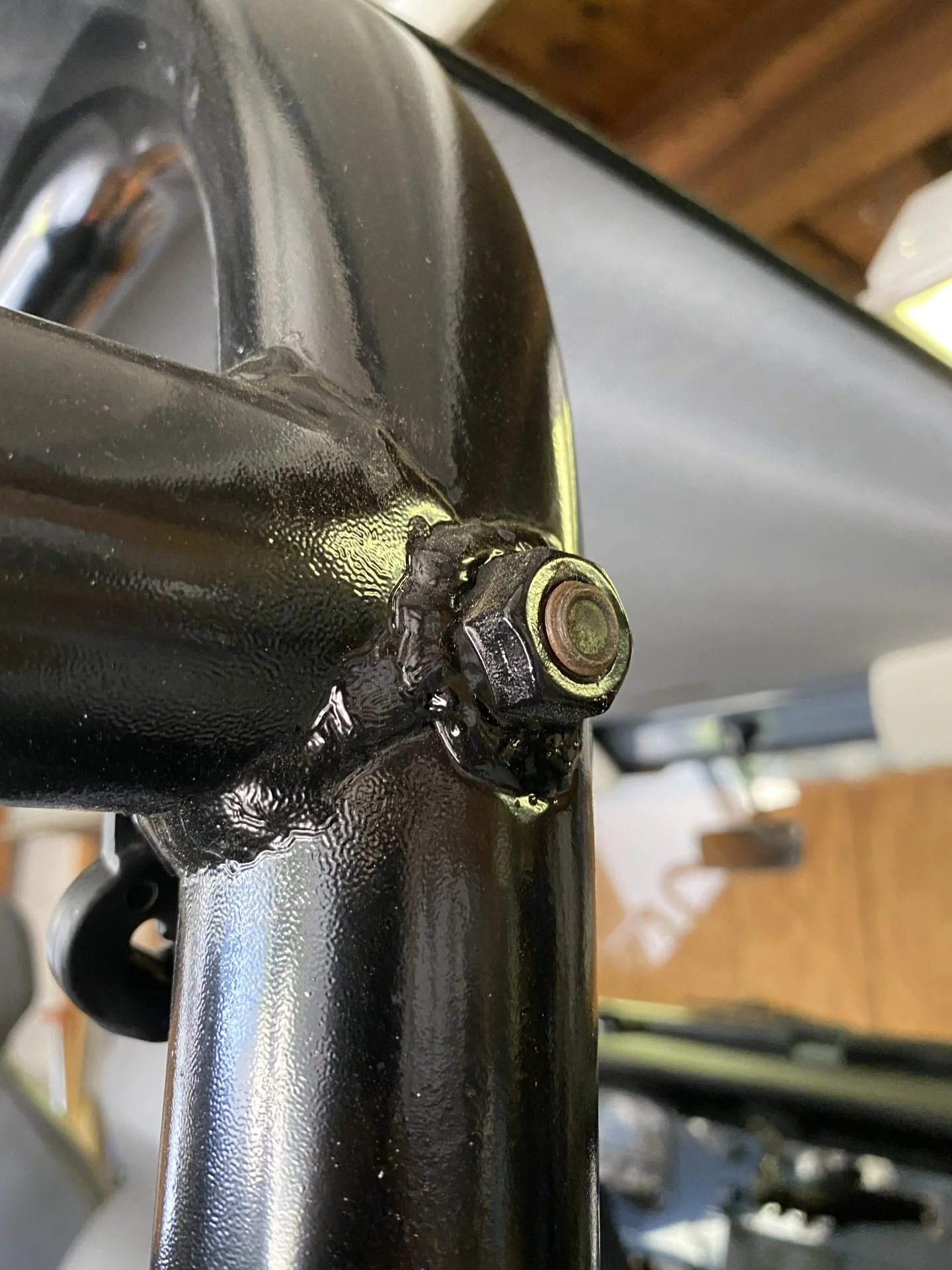

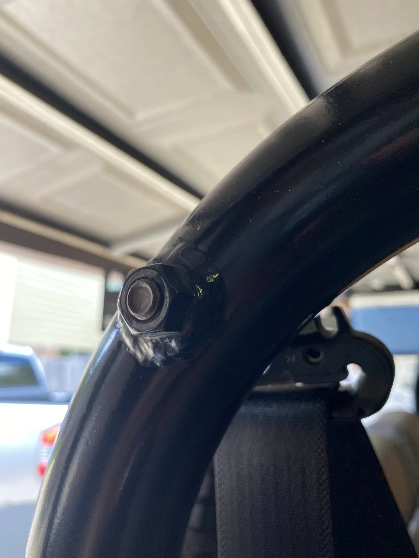

I welded up a DOM cage because the OEM cage is basically a joke. Once welded up I drilled out where I wanted the belts to attach and sleeved it. I then put a Grade 8 bolt with nut in and welded the nut to the cage. I won’t be home for a couple days but I’d be happy to take a couple closeup pictures for you.

Sorry for the delay. Absolutely swamped with life’s happenings right now. Anyways, I hope these closeups help.
