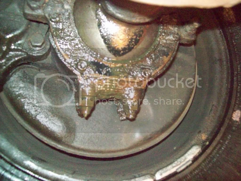

Ok, I just repacked a Bj60 knuckle and I'm learning some new things...
Also, my front end is clicking and popping...
So check this out, as I feel it's one of the top killers of a Toyota axle... Follow the process!

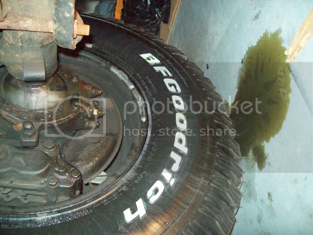

Alright, we all know most trucks had a hard life from previous lazy ass owners... I'm cleaning one up now that has grease fittings all over it... I guess the PO though you grease the piss out of the front axle rather than replace the swipe seals and axle seals...
So, the axle shaft seal goes... And now diff OIL is being introduced to the knuckles and mixing with the grease. It is in effect lowering the protective properties of the grease.
So you're washing the Birfs with a oil/ grease mix.
Any load and wear on them is magnified b/c a much thinner protection is being used on them. Also makes it harder for the swipe seals to do their job... And you have a leaking axle
Don't short out on this. A re-seal and re-pack are in order at the very least!

It's called "Birf Soup" welcome to the game!
