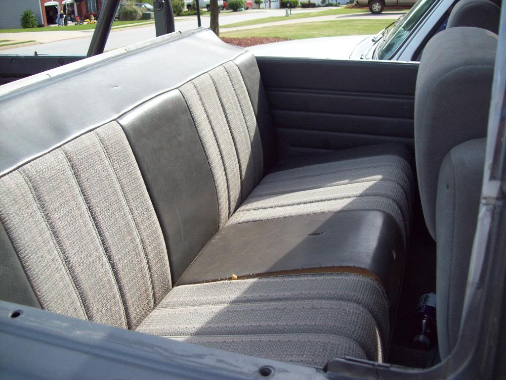

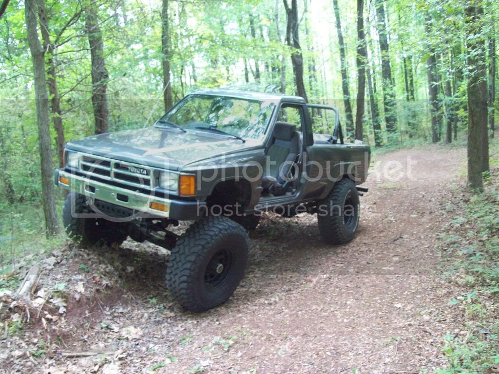

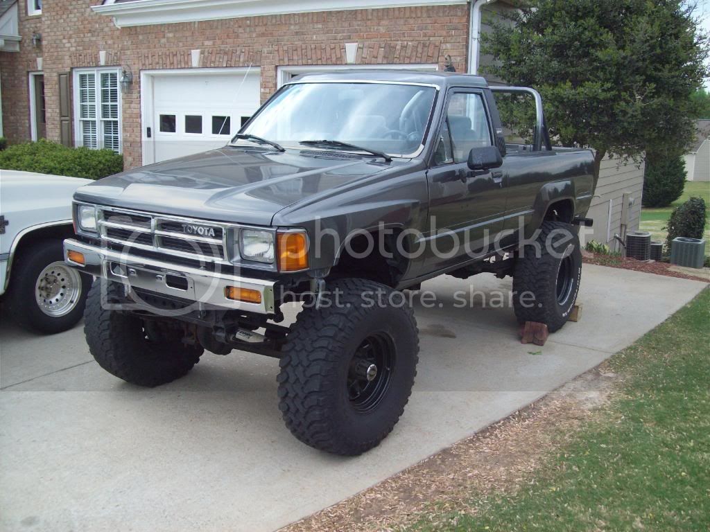

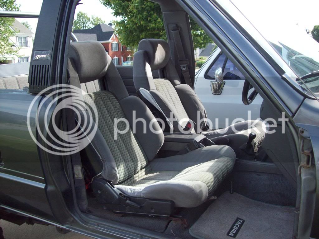

sounds good man i should make a build thread first new Engine then Ebrake then quick release doors now birf anyways here is some pics of my ride only have pics with the top and doors off but here she is
