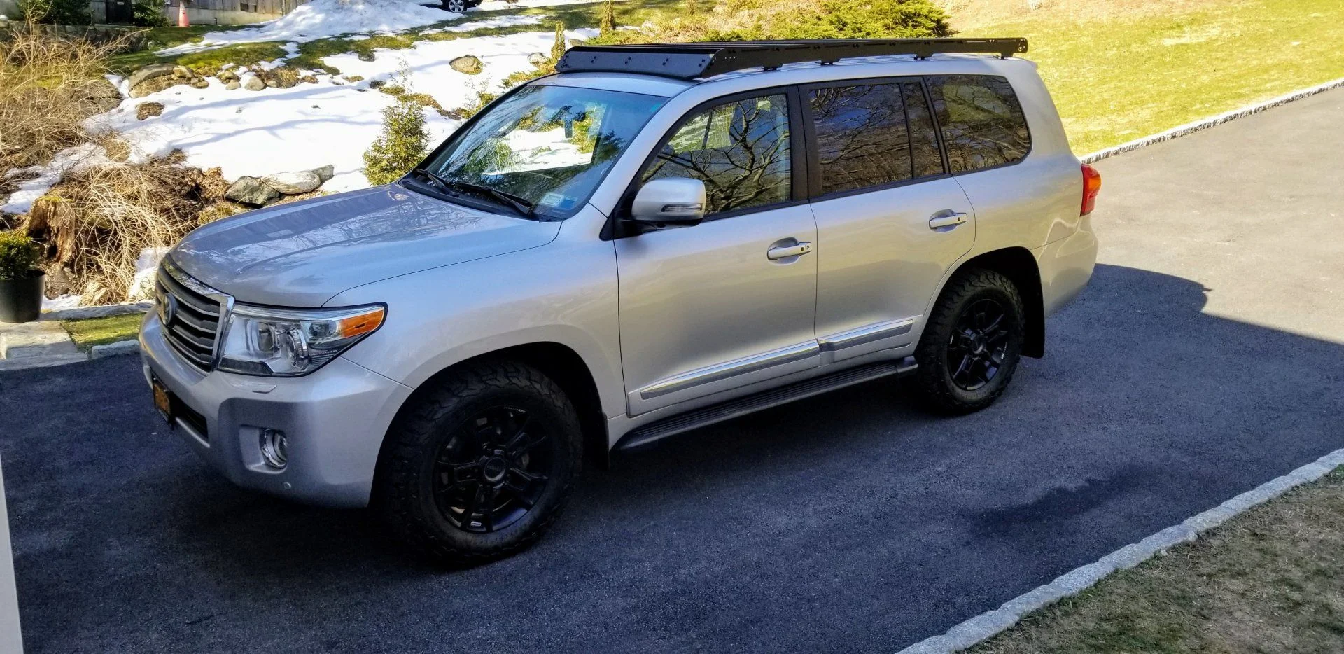

Recently installed my prinsu - love it.
Installed myself and took my time - Here are some tips:
Watch the Prinsu Design Studio youtube on a 100 series install as a preview
Used permatex #2 instead of silicone
Remove factory bolts by hand, alternating the loosening of bolts on each tower after 3-5 turns.
Do not install on the ground - install siderails first on the truck with mounting bolts semi tightened - use same method of alternating bolts when tightening
Then install crossbars leaving out the ones that cover the mounting feet
When you install the crossbars it will pull on the siderails
Make sure rails are square, then torque down. I started with the middle tower/driverside, then opposite side one tower over and repeated torque down in an x-pattern. Not sure if this made a difference, but it worked out for me in terms of everything level
Install remaining crossbars
Take pictures
Washed the truck yesterday and saw no leaks

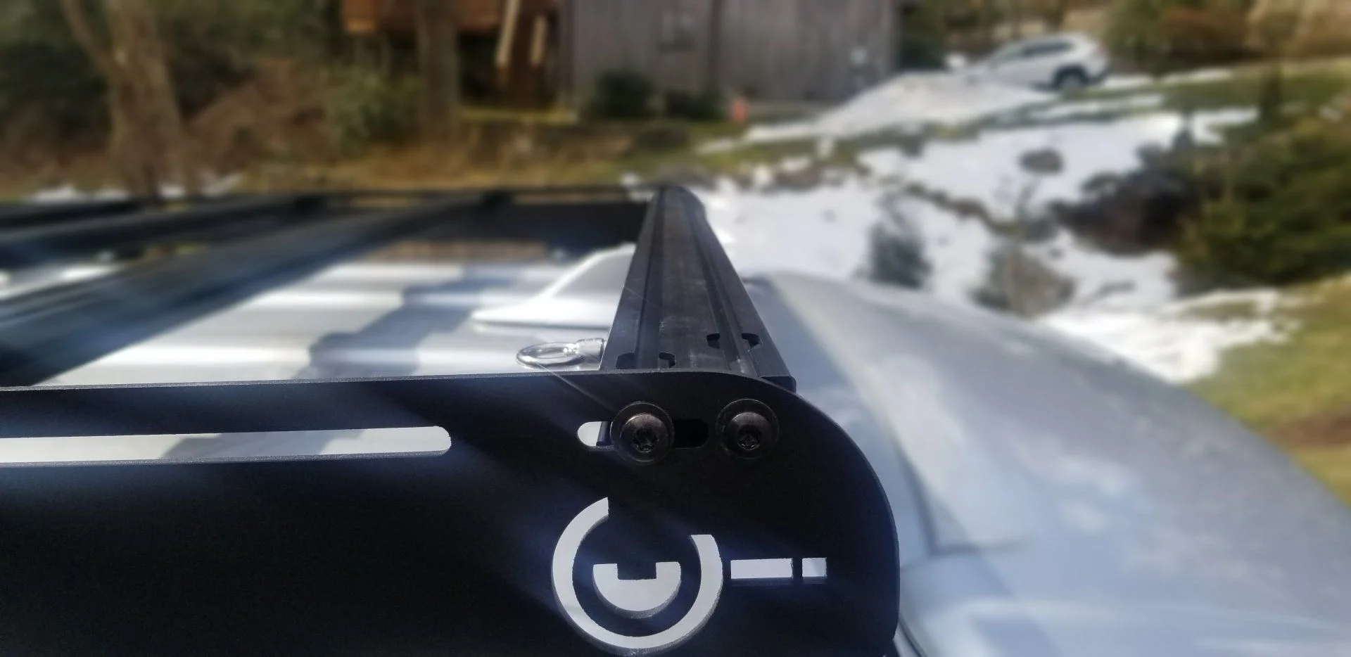

did you have to use the rear-most eyelet to avoid hitting the shark fin? or is your rear crossbar taller than the shark fin?
I used the last pre-drilled hole and the adjacent slot, which places the last cross bar behind the fin, but the bar would still clear the fin even if it was on top of it. I'm guessing a 1/4" of room. This may vary based on the way you torque it down - not 100% sure... but again, all clear for my 2014
Thanks to the advice on this thread, I was able to install a Prinsu rack on my 2014 LC200 with no issues. If you are planning on getting a Prinsu, you MUST follow the procedure for removing the factory roof rack bolts or you are going to be in a world of hurt.

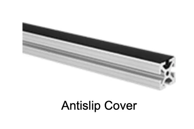

If you hear whistling or prefer a more "finished" look, get some T-slot channel cover from McMaster-Carr. I use the "non-slip" stuff as it has a slight ribbing for grip and seems to cut down on wind noise due to the imperfect surface (i.e. the golf ball dimple effect).

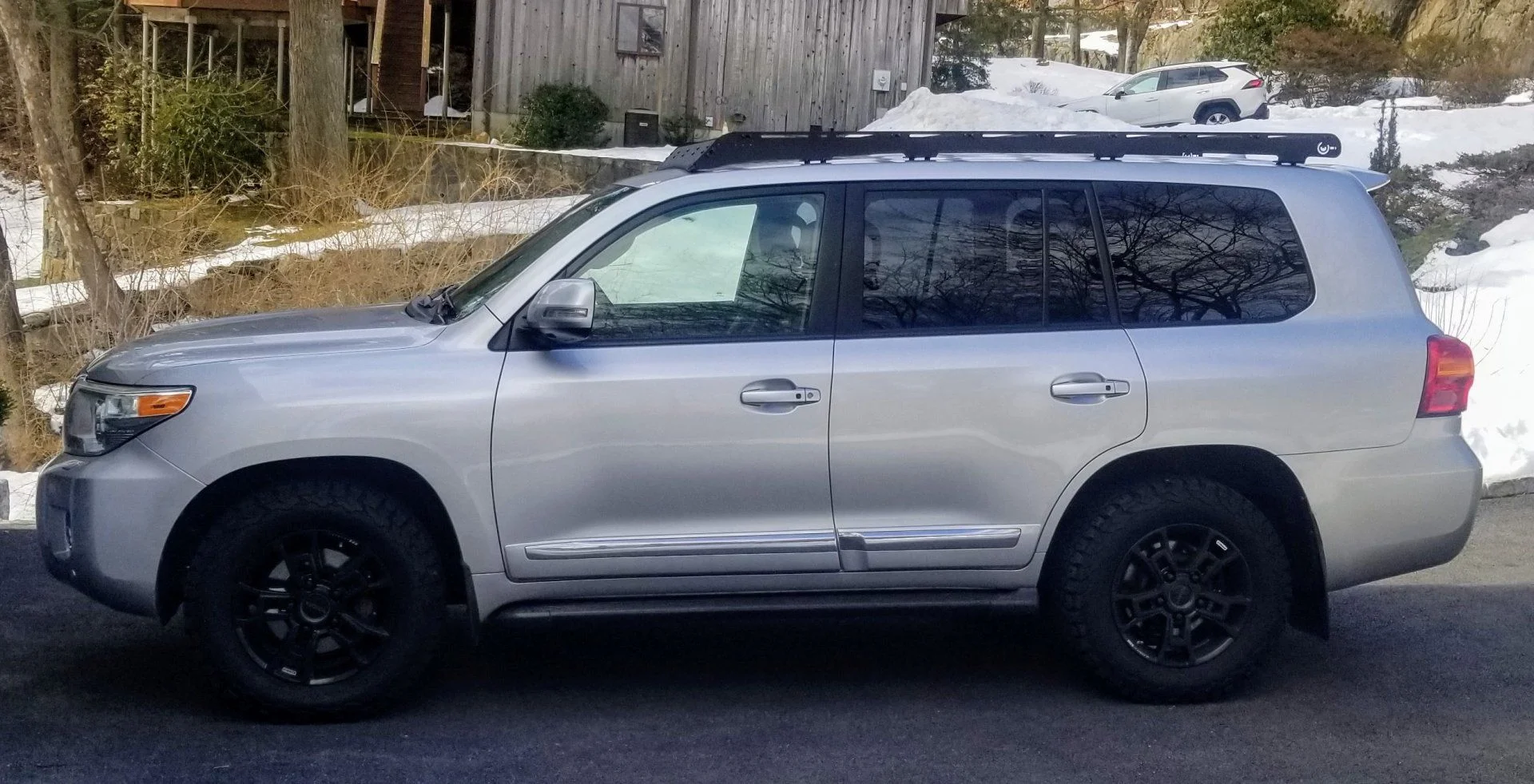

My "sharkfin" clears easily, but as others have mentioned - you can just mount a bar vertically there if yours is too close.

Finally got around to installing my Prinsu on my 2019. To answer my own previous question, surfboards work great on this rack without any additional crossbar risers. I ended up using some DaKine aero rack pads that rise about 1.3/4" off of the crossbars. I also chose the wind deflector that has the cut out for the light bar that gives you an additional inch or so of clearance in case you have a board with a lot of rocker on it. My first cross bar is in the first spot on the rack however I am thinking I may slide it back one notch to see if it cuts down on the noise a little. Just thought I would share because I couldn't really get a solid answer about this when I was considering buying the rack. Prinsu didn't even know. One thing that was kind of a bummer with this rack is that I ordered mine about 20 hours before they started one of their sales. They refused to refund me the 10% discount of the sale price or give me 75% of the discount savings in accessories. Kind of lame as most companies will often give a grace period on a sale. They did offer to cancel my order & I could repurchase at the discounted cost but the rep advised me that since the sale had started they had a bunch of orders & I would then be at the back of a long line. Just kind of left a bad impression with me on a vendor that I just purchased over 1k of stuff from.

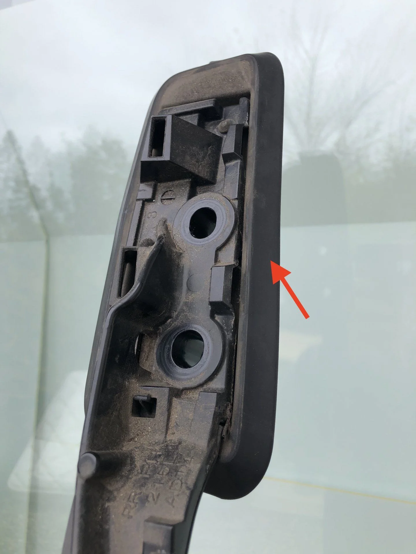

Apologies if I missed it, but I can not seem to find it. Does anyone know the part number for the oem nut plate for the roof rack? I have to replace a couple after the body shop mangled mine I just found out....
That sucks ... don’t forget the yellow seal things that stick up from the holes , not sure if they come with the nut plates . Body shop probably used a impacted gun , as others have repeated loosen bolts by hand evenly .
It sure does. This was a Toyota owned shop, the work was nearly 5k for a scrape on the rear wheel arch. I will not let them touch my vehicle again.
If anyone knows the PN for the nut plate I surely would be appreciative.

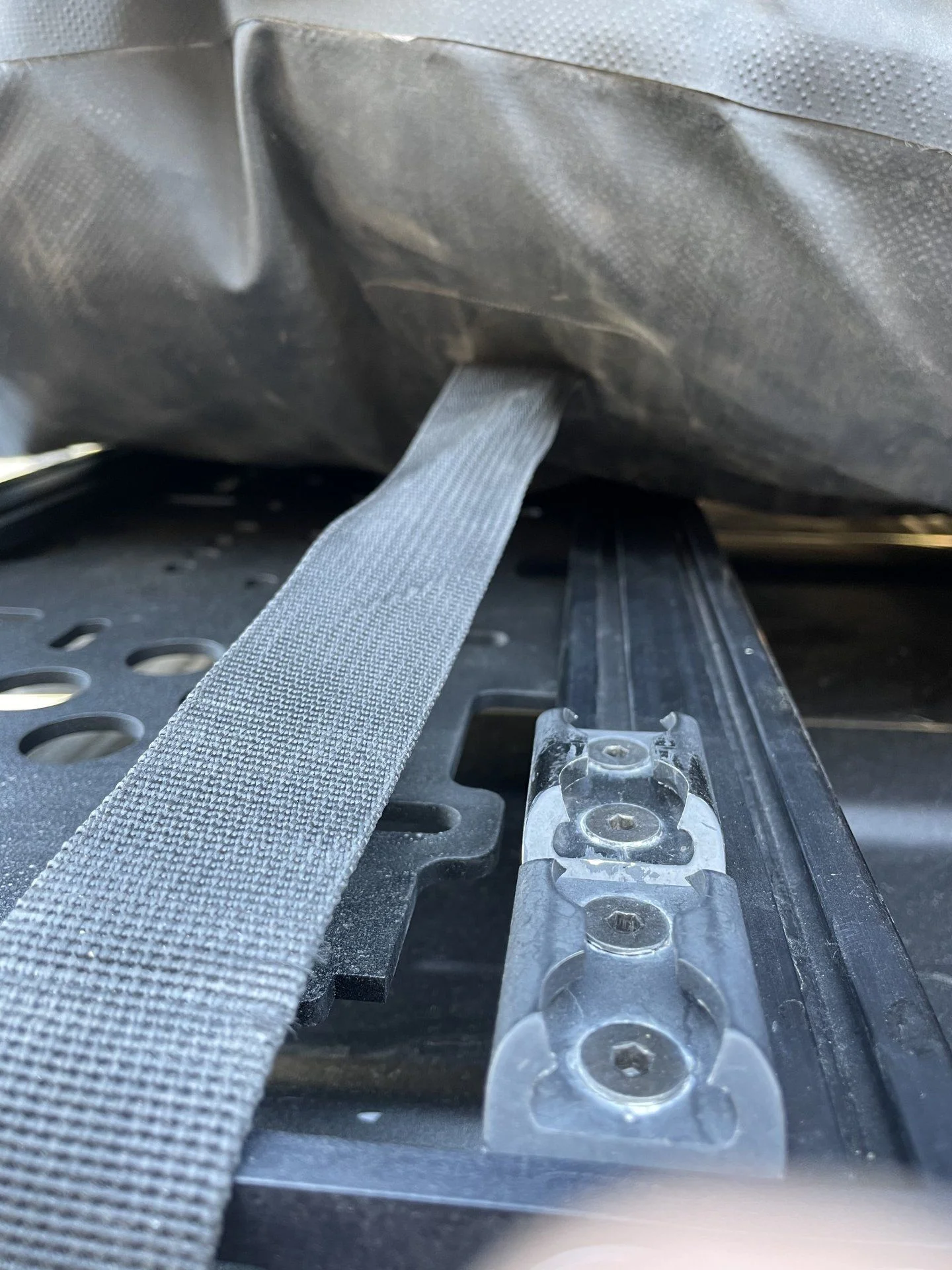

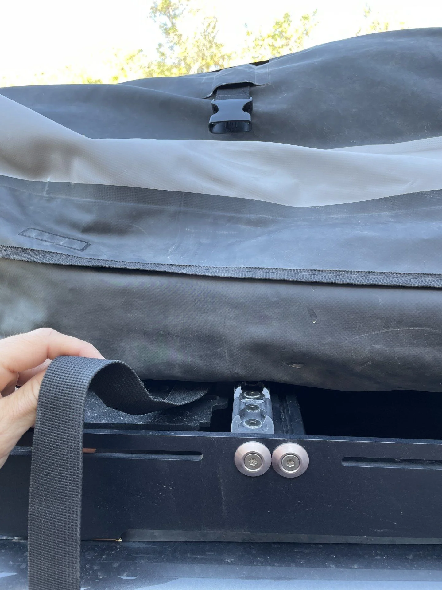

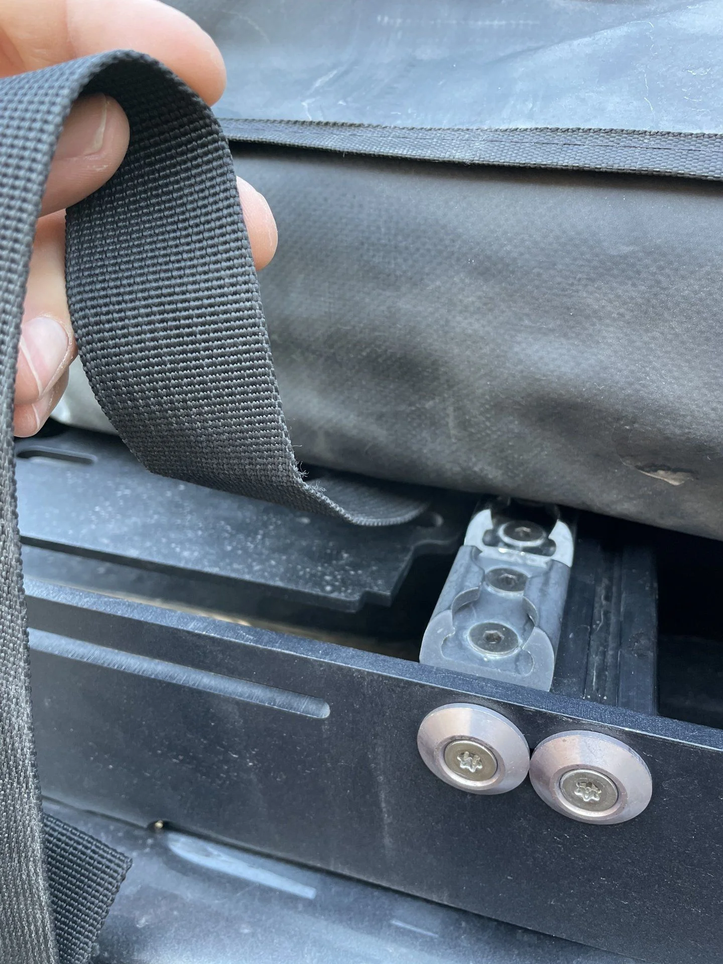

Can anyone recommend a solution here? I have a Rhino Rack rooftop bag. I need a way to secure these 1.5” side straps to my Prinsu. Straps aren’t long enough to run them down and under the side rails. The quick release o-ring style tie downs won’t fit the plastic buckles. These straps run parallel to the crossbars, again not long enough to twist under then above them to clip to top of the bag. Is there another anchor style that I can bolt into the t-slot?
My first thought was a footman loop attached to the flat part of a rack but I'm guessing that also wouldn't work with the buckle? That said... you could just remove the footman loop each time you take the bag off.
Can you remove the entire strap from the bag and replace with something that has hardware that's easier to use? Something like an e-track strap would be pretty clean or at that point just use a 1 inch strap with the mounting points that you already have? Perhaps poke around here -- Strapworks - Straps, Webbing, Tie-Downs, Buckles & More - https://www.strapworks.com.
@FDMD Can’t you clip an anchor into your airline track system?
Bonberland Single Stud Fitting with D Shape Stainless Steel Ring for L Track/Airline Track-10Packs Amazon product ASIN B07FG26WW9
I can’t speak to the buckles you have, but most of the time plastic buckles come off the strap (unless they are sewn in).
Could you add supplementary cam buckle straps or a cargo net over the bag to hold it in place?
Your load panel looks wrong (too short). Are you sure that's the right size?
I was wondering. I ordered these a couple years back and just took them out of the box this weekend as I fine tune how I load the rack. I don't recall there being different widths available back then, but yes, these are not wide enough. I just looked on the website now and I see they offer different sizes. Frustrating. That order also included a cargo basket kit and the included crossbar they sent with it was also the wrong width. They did replace that right away. They don't list the dimensions, so I'm not sure which vehicle this load panel is intended to fit. I reached out to CBI, hopefully they'll honor a straight exchange since these are new and unused.
I’m pretty sure mine are 48.5” and they reach all the way to the slots of the side rails.
