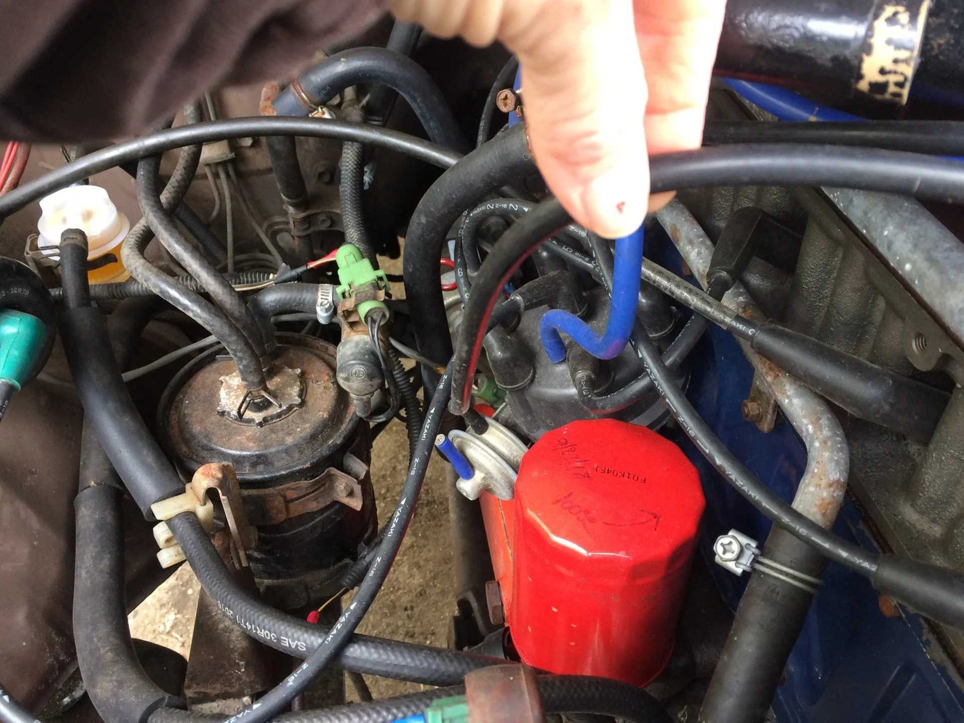

Where would I find the vapor vent pipe?? No idea where to even look. Pictures are always the best😀
I looked through here but it’s your footwork now because it dawns on me I’m not the one having issues. ;) .... This is your second bible to the fsm to always find parts diagrams then cross reference to Toyota parts deal for prices.
I find I can only search the site through my phone I get some sort of block via my desk top. If your truck is pre-85 adjust the year.
Pics will help. Also, use search to see what others have done regarding charcoal venting and desmog... plenty of pics and detailed how-tos. Check out my desmog thread... that’s, “my desmog thread” not my desmog thread... it isn’t mine... hth

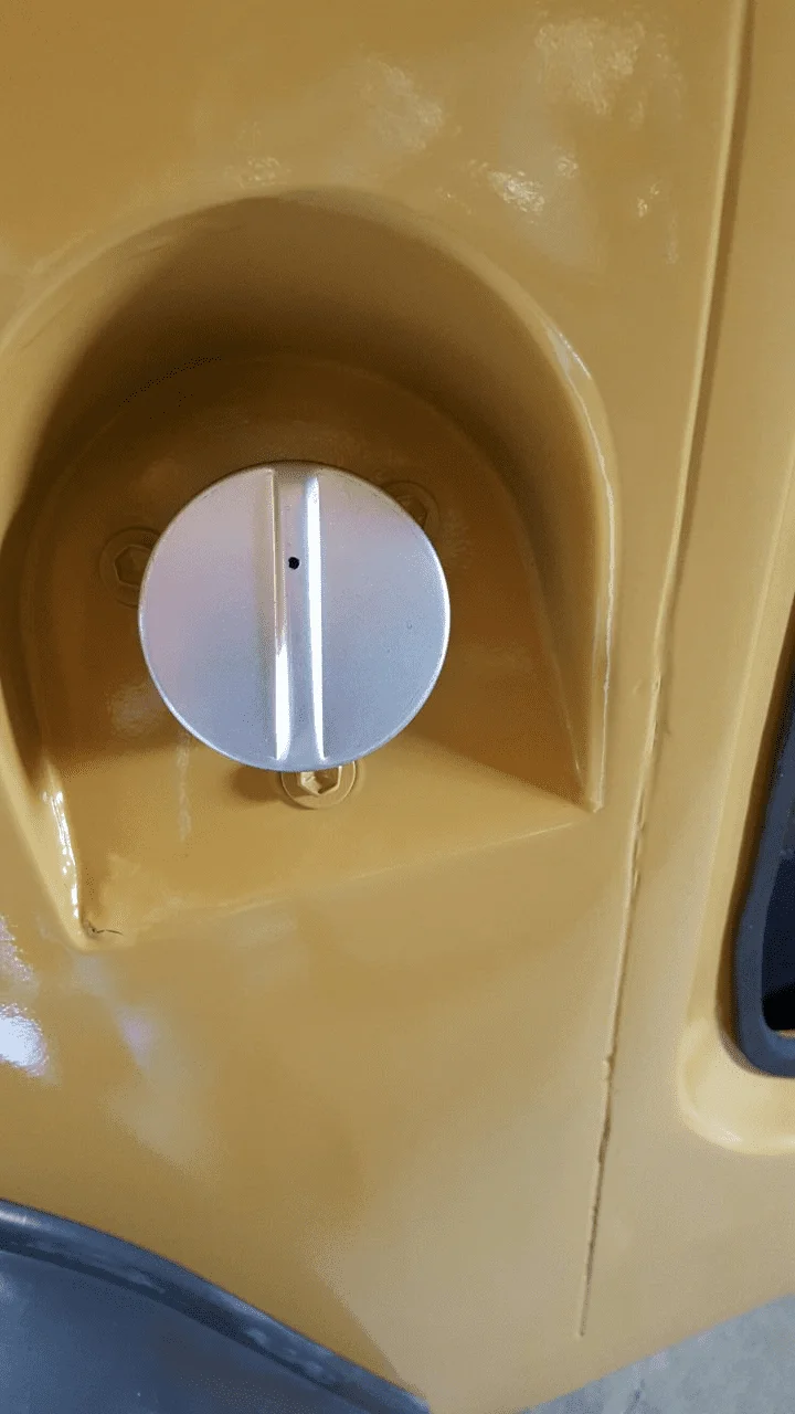

I went to a vented gas cap. bought from Napa. followed a link somewhere on here
Others drill a small pilot hole on your fuel fill lid As an option.
If you switch to the OE Toyota vented cap like I did, you might have some trouble getting the screw tabs to hold against the filler body. For some reason it doesn't hold as securely on my 84.
that sounds like the easiest solution. Was is a stant? did you get the part number from a thread or just have them look it up?
If you get a vented gas cap. Be sure to pack the empty space between the filler door and cap with a big rag if driving on dusty dirt roads. That little compartment gets filled with dirt after driving on dusty roads and the gas cap vent can suck in the dirt.
