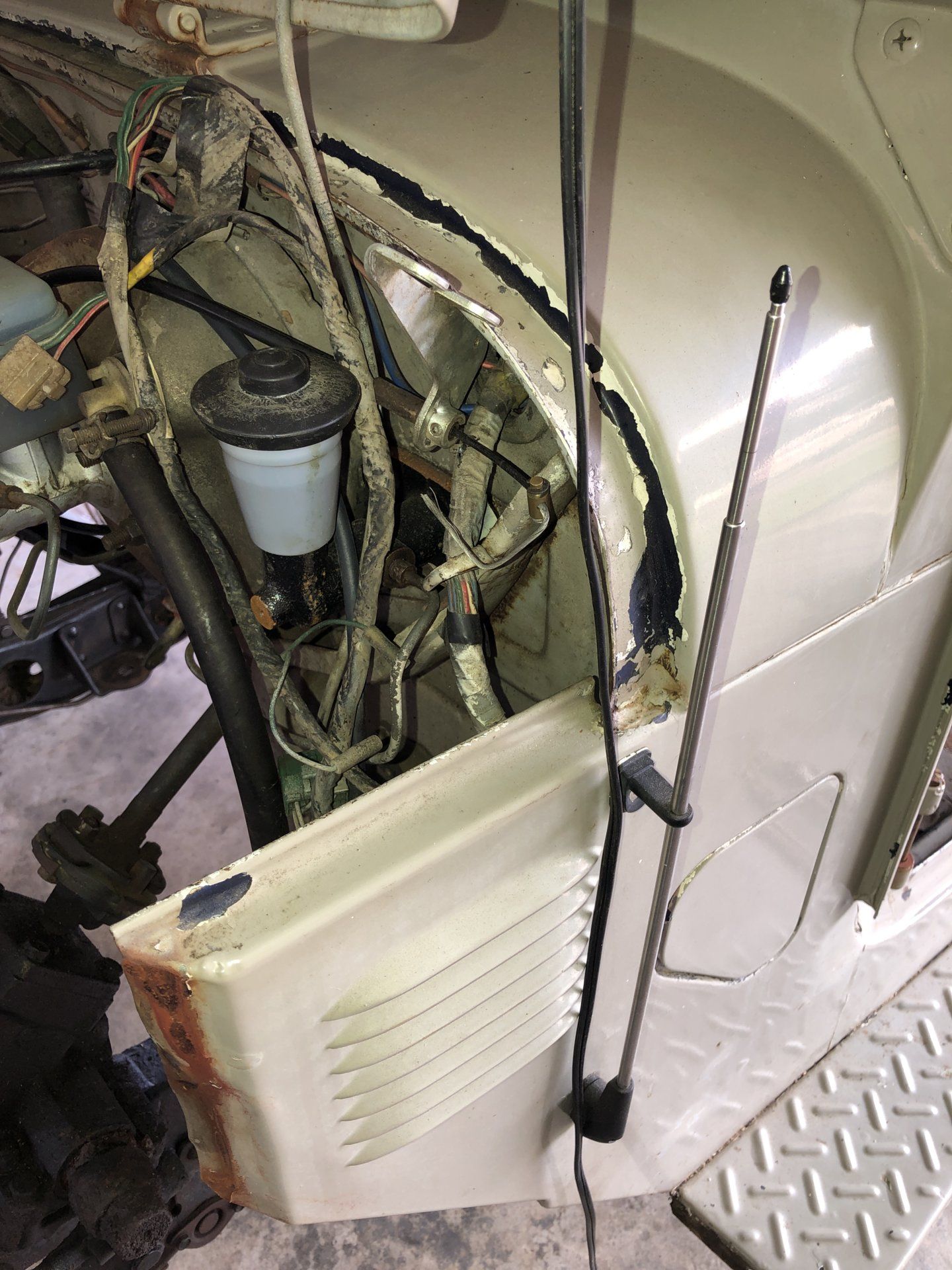

I have no idea what the original color was, and the paint isn’t “bad”, however it has a lot of rust trapped beneath it.
I currently have the engine/transmission out and going to clean up the underside.
What would y’all suggest on paint and any ideas on original color?
If you like the new color keep it.
The places where rust is bubbling up. Take a paint scraper and chip the paint back to where the paint is solid. Treat the rust and oil it up and peel out.
Looks like it was white.
Dang, that was definitely not the color I was thinking. I was thinking a baby blue-ish, just from the floorboard and door sill. But you’ve got the experience so that works for me! What would you suggest on the paint, as far as a scrub and oil down?

Look on the inside of your glove box walls and inside the door of your fuel door for the color there. I see the blue now.
What year is it?
You have plenty of paint there. I think I would do a buff and shine on it first to get the paint right then I would go back and work the rust spots with Converter and BLO/Fluid Film.

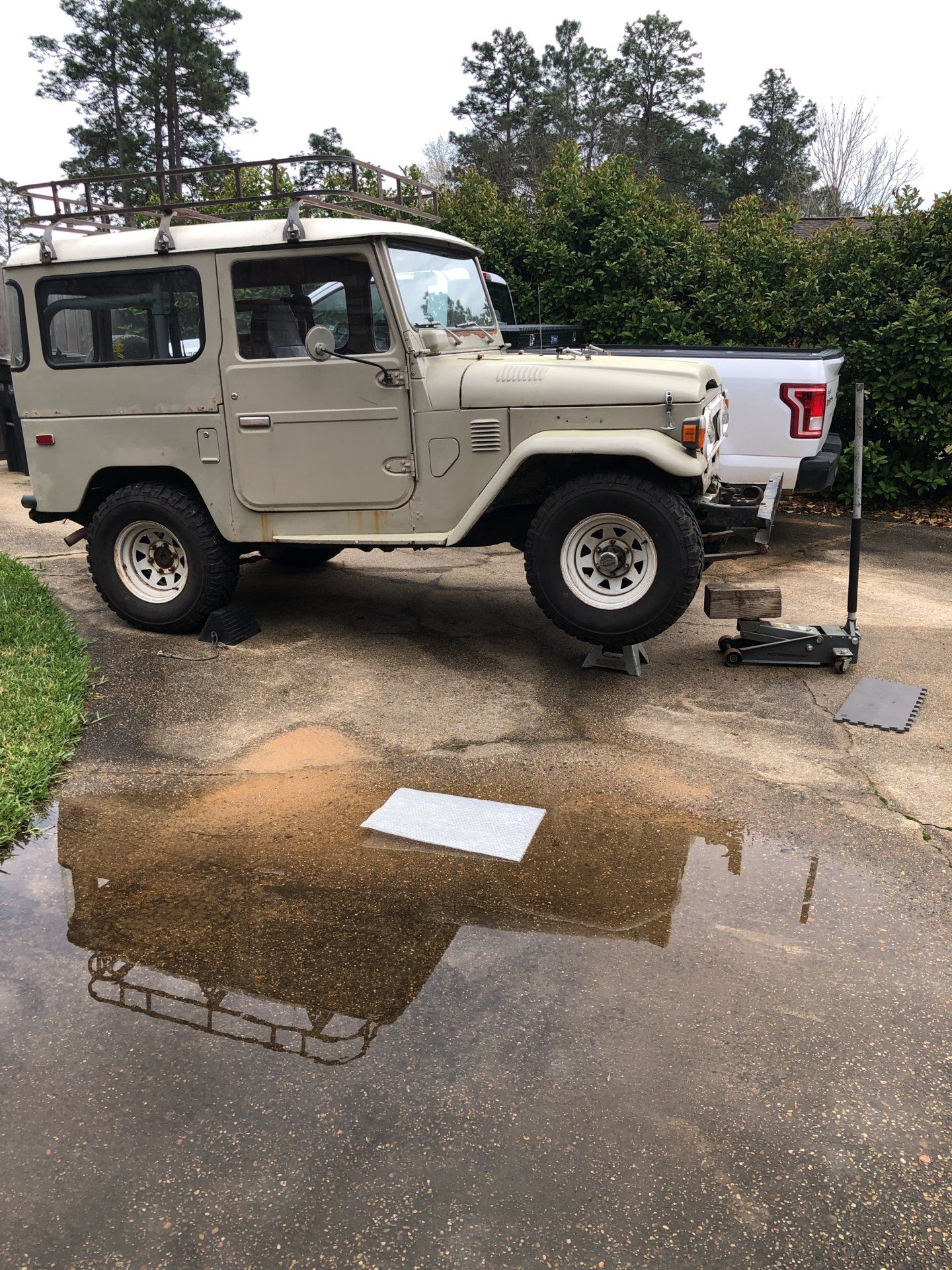

It’s a 05/1975. My dad bought it in ‘98 in Jackson, MS. It had just been painted, or appeared that way. He used it in the logging woods for a solid 10 years and beat the hell out of it. He parked it under the barn in ‘08 and I pulled it out in 2016 and started bringing it back to life.

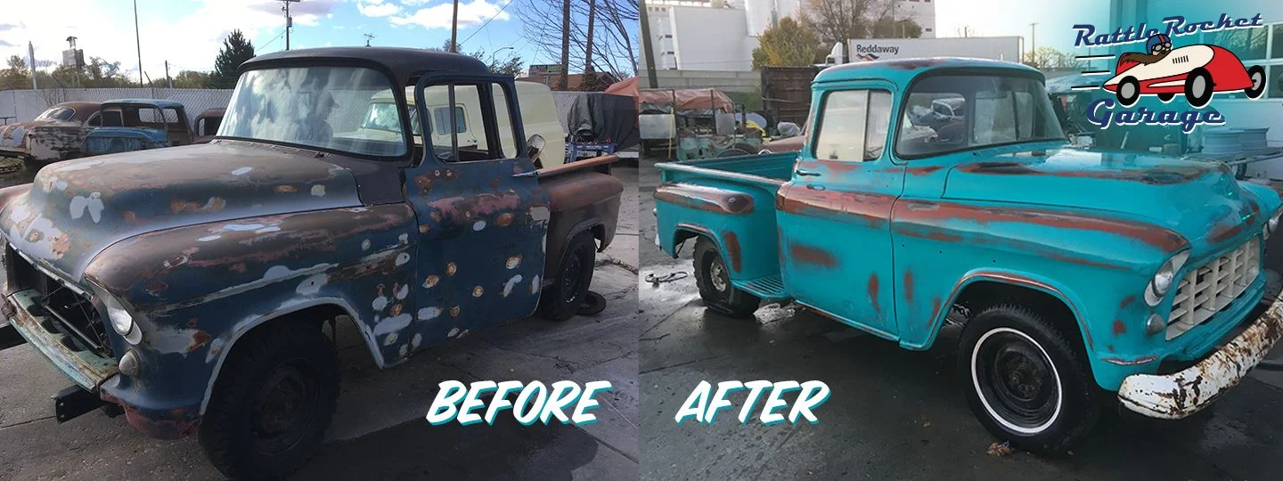

Thanks for all the info. My truck was too far gone (IMO) so now it's got shiny new paint. My resto buddy that I had help me replace quarters and wheel wells, sill, etc... does a good faux "patina paint job". He shoots primer, single stage paint, sands it back to imitate natural weathering and induces oxidation with an acid mixture he made up. Then he cleans it and does pretty much the same BLO preservation treatment to the whole thing. Sometimes he uses wax. (he hates when people clear coat patina'ed cars. I do too).
My buddy's work (forgive the non-Toyota truck):
The body panels were all mismatched with the bed and cab.
Beyond looking weird out of the gate, clear coats require a chemical bond to function. That means they need to be applied before the paint is cured. Clear coating old paint (even in good condition) results in cloudy de-lamitation after not very long. It simply won't stick. Then you are stuck removing it, and probably just janked-up your sexy patina that was the way God intended. Now you're going to hell.
My friend charges the same (or a little less) for a "patina paint job" as a regular one, and although I LOVE the look of an old truck, I feel like I can usually tell when they are faked. Maybe it's because I work in Photoshop all day, and I pay very close attention to realism and following that to fake things that don't exist in camera. If we had gone down that road we would probably not be friends anymore. I would have been VERY particular about the faux aging. With a standard paint job, the outcome is pretty well defined.

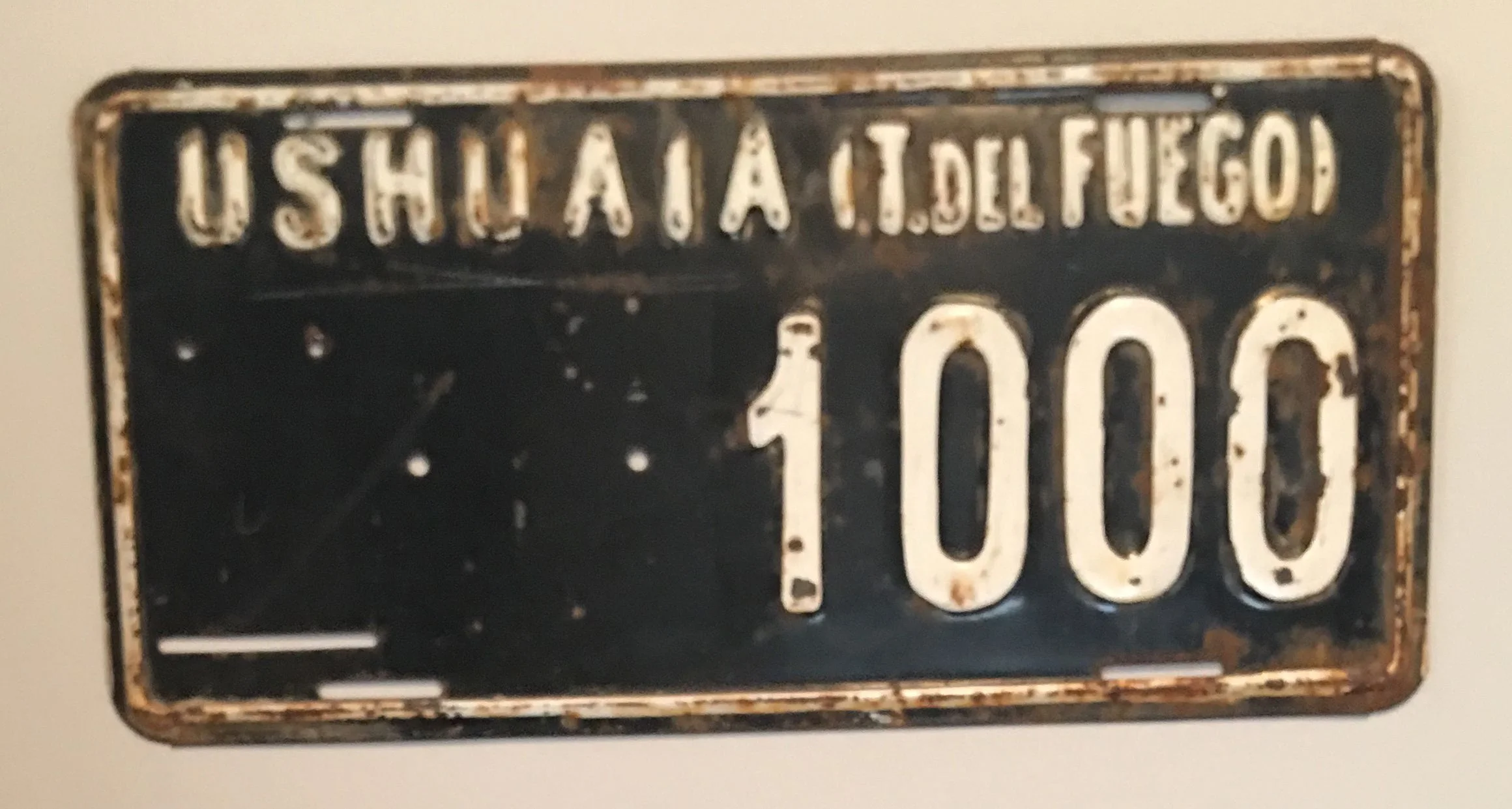

I DO however have a vintage front license plate I will be applying the 89nOlder preservation guide to before I mount it.
Just need to find a vintage patina'ed font plate holder to match. :) Great thread.
