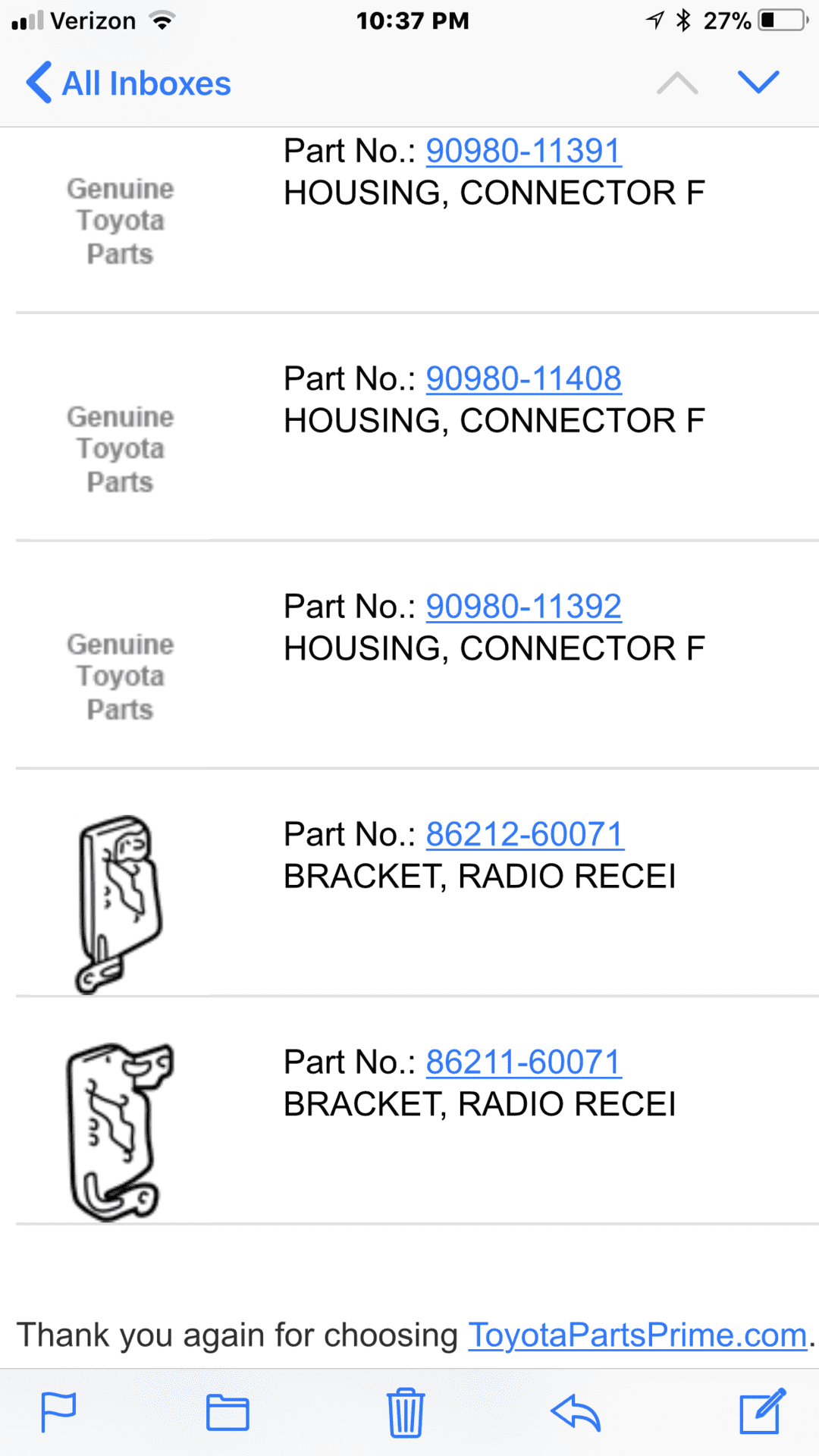

Which brackets are you talking about? Can you include the part numbers for the thread? I have a 2002 LC and I had to use some new brackets and I listed the part numbers for my model.
I am calling the dealer for brackets tomorrow so I am not sure what PN I will end up with. Most likely the ones you listed. I was trying to say that the oem brackets on the factory nav won't work on an aftermarket receiver.

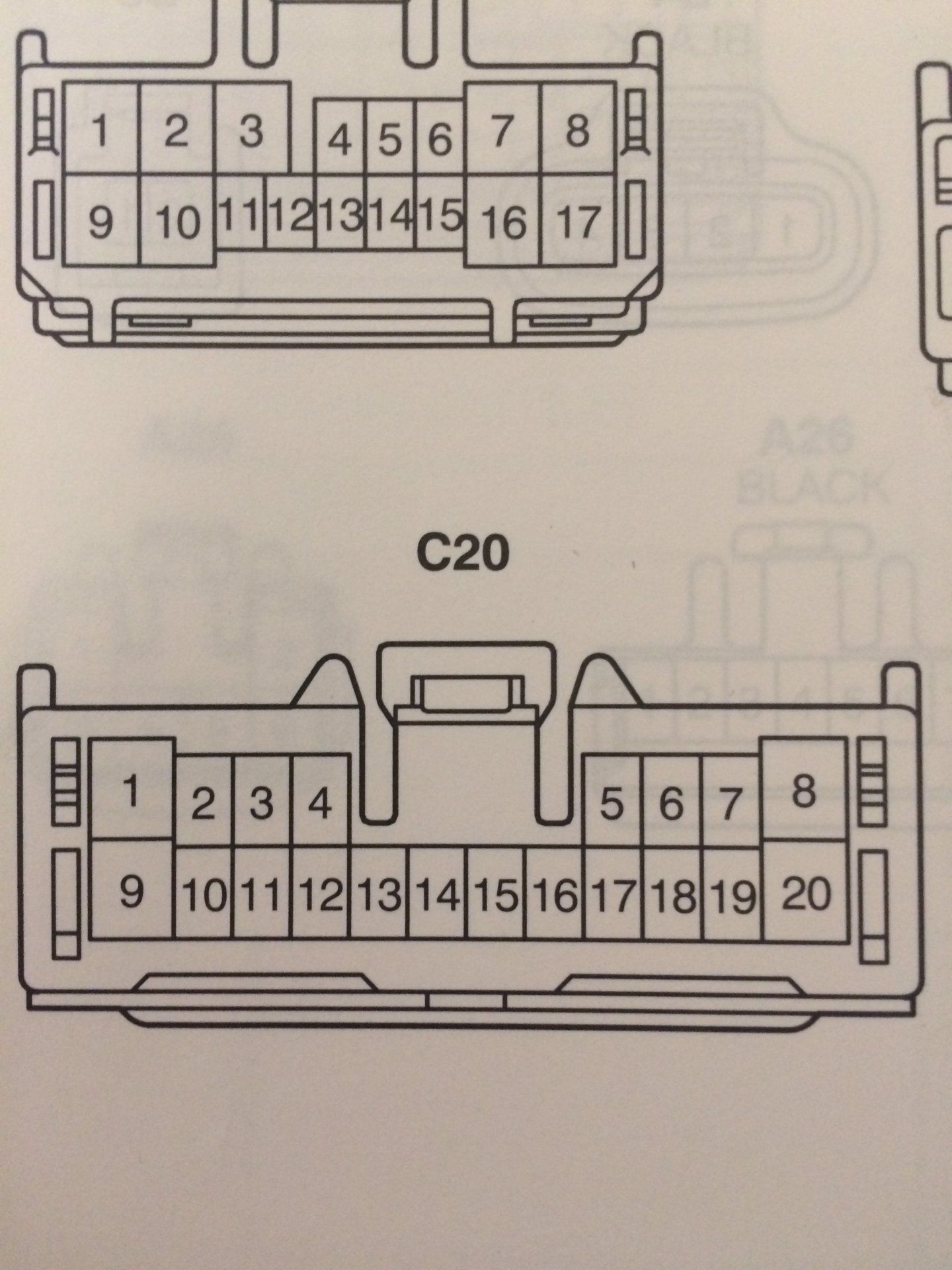

I am sure they are the same. I have included some shots of the electrical manual. The electrical manual shows the connector end whereas your manual is showing the ECU end so they are mirrored. The electrical manual includes schematics. I will be online most of the morning and I can post anything from the manual this AM if it helps.
Looks like I'll mostly have to just use the updated spreadsheet that you posted a picture of in lieu of having the wiring manual as the service manual isn't nearly as complete. Could you possibly post the "E" terminal? I can't find that one in the service manual. Also, when you wrote E8 twice in a couple of boxes, was that to designate you did a three way there?
"E" is C20. It is the plug that runs to the 3 knob controller. I did have to do 2- 3 way connections I also tied into the Dimmer circuit for my new stereo. I don't remember if I chronicled that or not. Don't forget these photos are from the connector end.
"E" is C20. It is the plug that runs to the 3 knob controller. I did have to do 2- 3 way connections I also tied into the Dimmer circuit for my new stereo. I don't remember if I chronicled that or not. Don't forget these photos are from the connector end.View attachment 1584621
I think "E" C20 is what came out of the Clock/Rear Heater/Antenna control on the bottom of the old Nav unit, thanks for the picture of that, I think I should be good to start cutting now. Fingers crossed.
