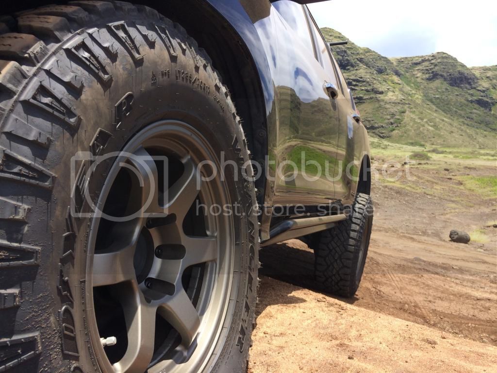

Man this is great! I was actually looking to get these prado rocker panels but it seemed like too much work... so I ended up just hacking my stock side steps instead. As for the sliders - they should bolt right up but you probably want to order the 4runner trail fitment. Good luck and happy modding!

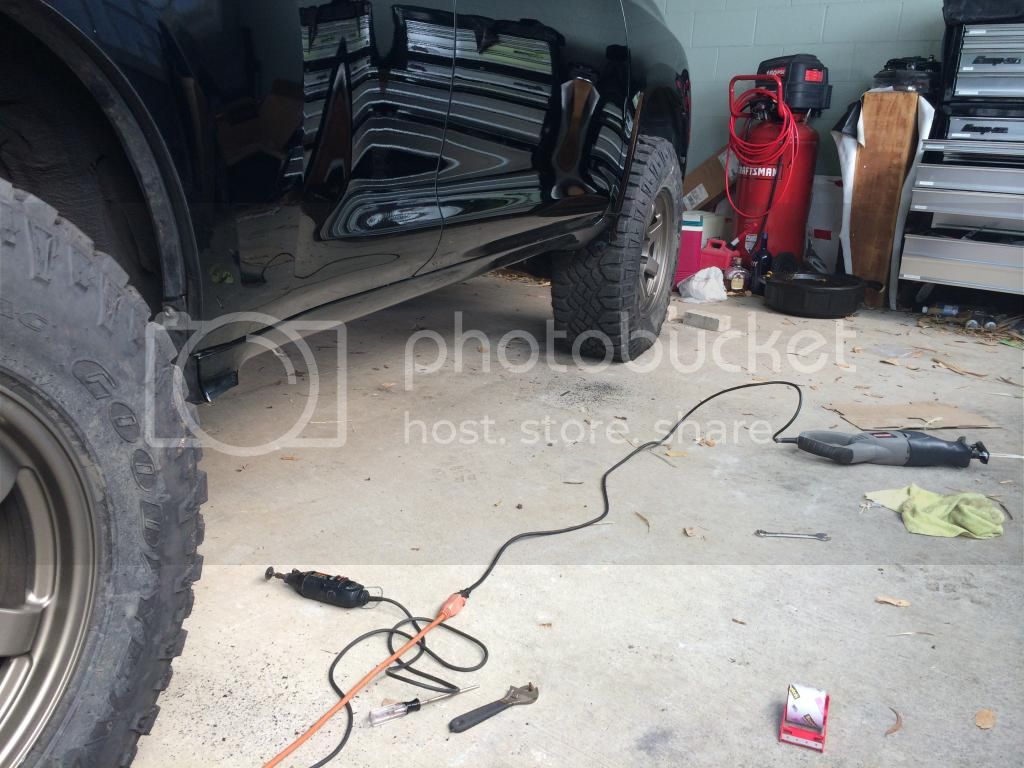

With the side steps removed it just didn't look right:

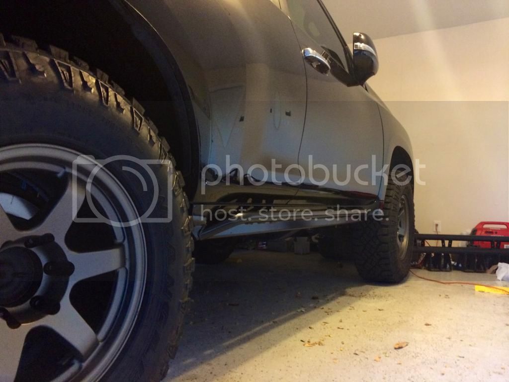

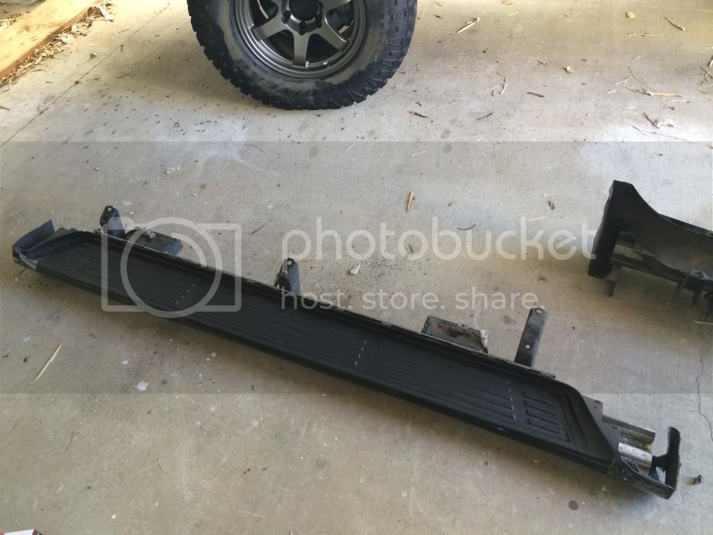

So I cut the upper portion out of the stock side step and remounted it.
Then added some bolt on sliders from Rocky Road Outfitters (make sure you order for 4runner trail)
