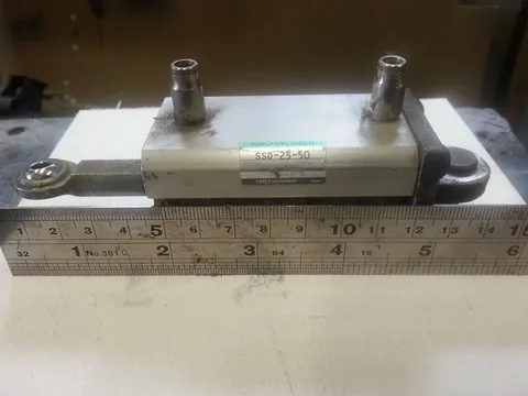

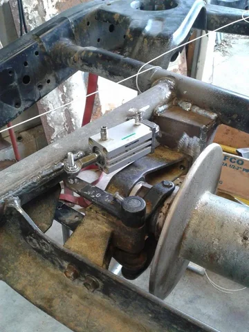

Same as hydraulic... apply air and it pushes straightaway... if it's not aligned it will push against the faces and as soon as the dogs line up it pops into place.
The ARB mini compressor has a storage tank in it so will have a head of pressure. http://store.arbusa.com/ARB-On-Board-High-Performance-12-Volt-Air-Compressor-CKSA12-P3574.aspx
I will be running it thru a "switch" which will apply pressure into whatever port I select and vent the other side. My old hydraulic system was only one way and relied on a spring to lock it.. This way I can power it out or in.This one also has the option of being spring loaded inside. Either a push or a pull. I have set it up to pull in to lock the dogs so if I loose air the freespool will be in the engaged position. Also set it up so the actuator rod is inside the ram during normal operation so it doesn't get damaged or corroded.
hydraulic would bend the linkage, i was hoping that it was more "build up mild pressure till cogs aligned idea.
I hear what you are saying...My hydraulic setup was a clutch master / slave cylinder .. Uses arm pressure ! lol.
It doesn't seem to do any harm... meshes nicely.. With a good solid clunk...
I normally get my navi to pull the rope and set the freespool before we start driving the winch hard...
Or slowly drive the winch until it clunks if I am on my own....
I am going to use the same idea when my E Locker motor craps out... Its only a matter of time for that one hehehe

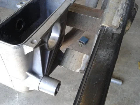

New home for the Warn 8074 !
Any know what this boss was for? The newer 8274's don't have it.
Looks like it was used as an earthing point and there is not one on the motor.
I might use it as an extra mount point and tap a new thread into the motor body for the earth wire... Like all my other electric winches I have owned.

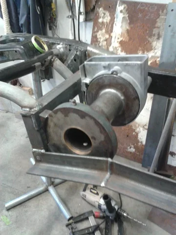

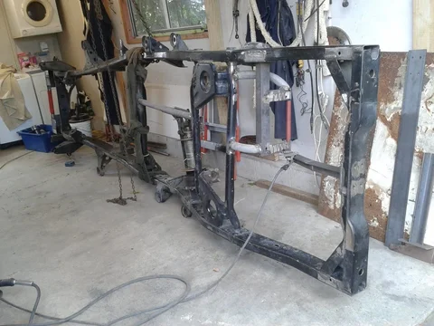

Ok bit more progress has been made. I have done some more work on the chassis, welded in some mount plates for the side bars and also the rear cage.
Spent saturday pulling out the motor and trans... Did have an oopps and dropped the trans off its jack.. Busted off the vacuum actuator. I have a spare so all is good...Next is pull the running gear. Then I can start doing some articulation trials to see if the new brake calipers hit the chassis....Before I finalise the mount bracket. Then there's the winch rope runs to check out. Mock up the exhaust system brackets and also toy with the rear radiator pipe runs... So it will start evolving some more over our southern hemisphere winter. Once completed I will throw a coat of paint on the chassis and start putting her back together. Oh and upgrade the brake booster to an 80 series one I scored last year.

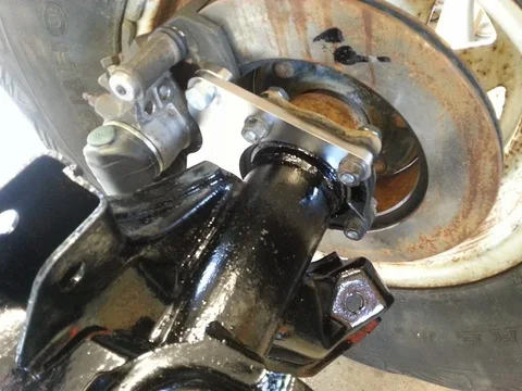

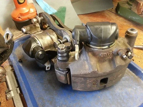

I have completed the rear brake caliper swap and installed the Subaru Leone calipers. Only job to do is the handbrake cable. This will be completed when the cab is back on the chassis.
The chassis has had all the welding done to it and is now etch primed ready for a coat of black.

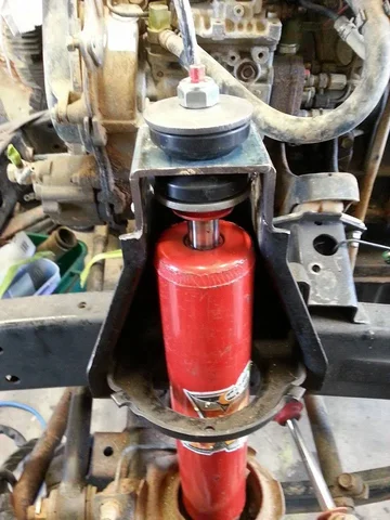

I ended up upgrading the shocks to some EFS Extremes which resulted in changing the mount locations. Particularly the rear.
The rope runs for the rear winch have been installed.

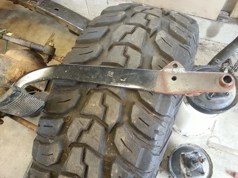

Also while everything was apart, the brake booster and master was upgraded to an 80 series non ABS unit. Fitted straight in however the rod to the pedal is short about 15mm.... Easiest fix was to add a tab to the brake pedal and re drill a hole for the fork. (photo's will explain) Here in NZ you can't weld the rod but you can weld the pedal. (Cert rules to keep it road legal)
The rear axle assy has been painted and I am just working on the front.
Oh I almost forgot.... The exhaust has been replaced with a 3" system front to back.
Wastegate actuator has been changed for a Turbosmart unit and setup for 20 psi.
Torque converter is currently in the shop getting a birthday, lower the stall a bit and tighten up the clearances.
Rather than type and type... Here are the photo's.
Any questions ? Ask away.

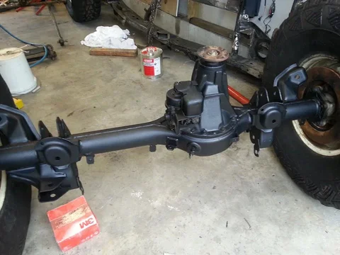

Rear axle assy all completed and painted.
Subaru Calipers

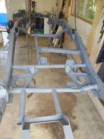

Chassis etch primed

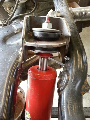

Rear shock with new top location.
Front shock with new top location

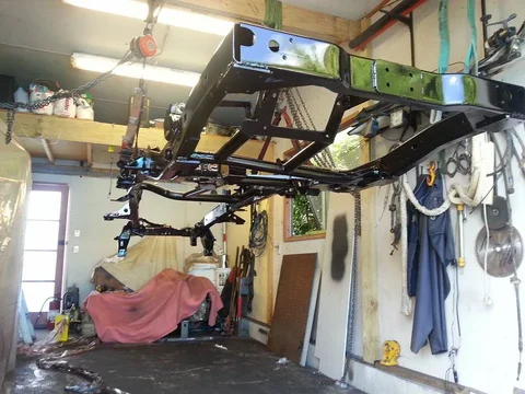

Chassis has been painted twice now !.. First time the top coat reacted with the primer and it went all soft. So it was off to the blasters and blasted and primed with 2 pot primer... And I have put a couple of coats of 2 pot black over her.... So now its time to start putting it back together.
Also finished off the rear caliper swap.. Just the handbrake cables to play with once the cab is back on.
