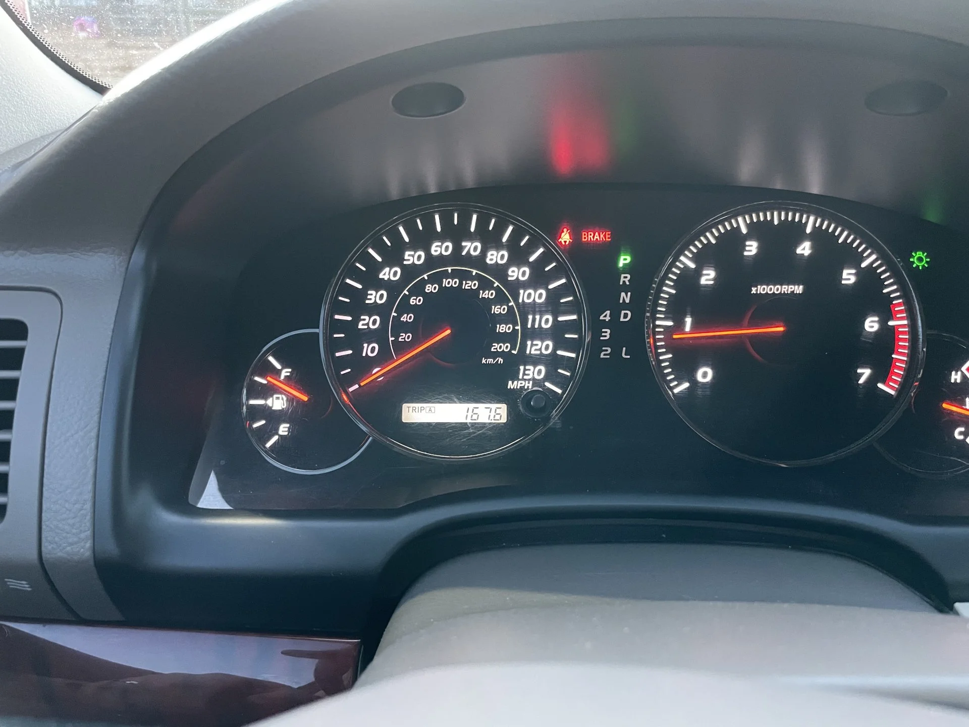

I ran it to empty to get a better idea how the gauge reads and to verify no issues with the evap system. So far no codes have been thrown so that’s good!
I was calculating range based on 15 mpg and it’s a good thing I didn’t go longer before filling up.
That calcs out to 13.28 mpg

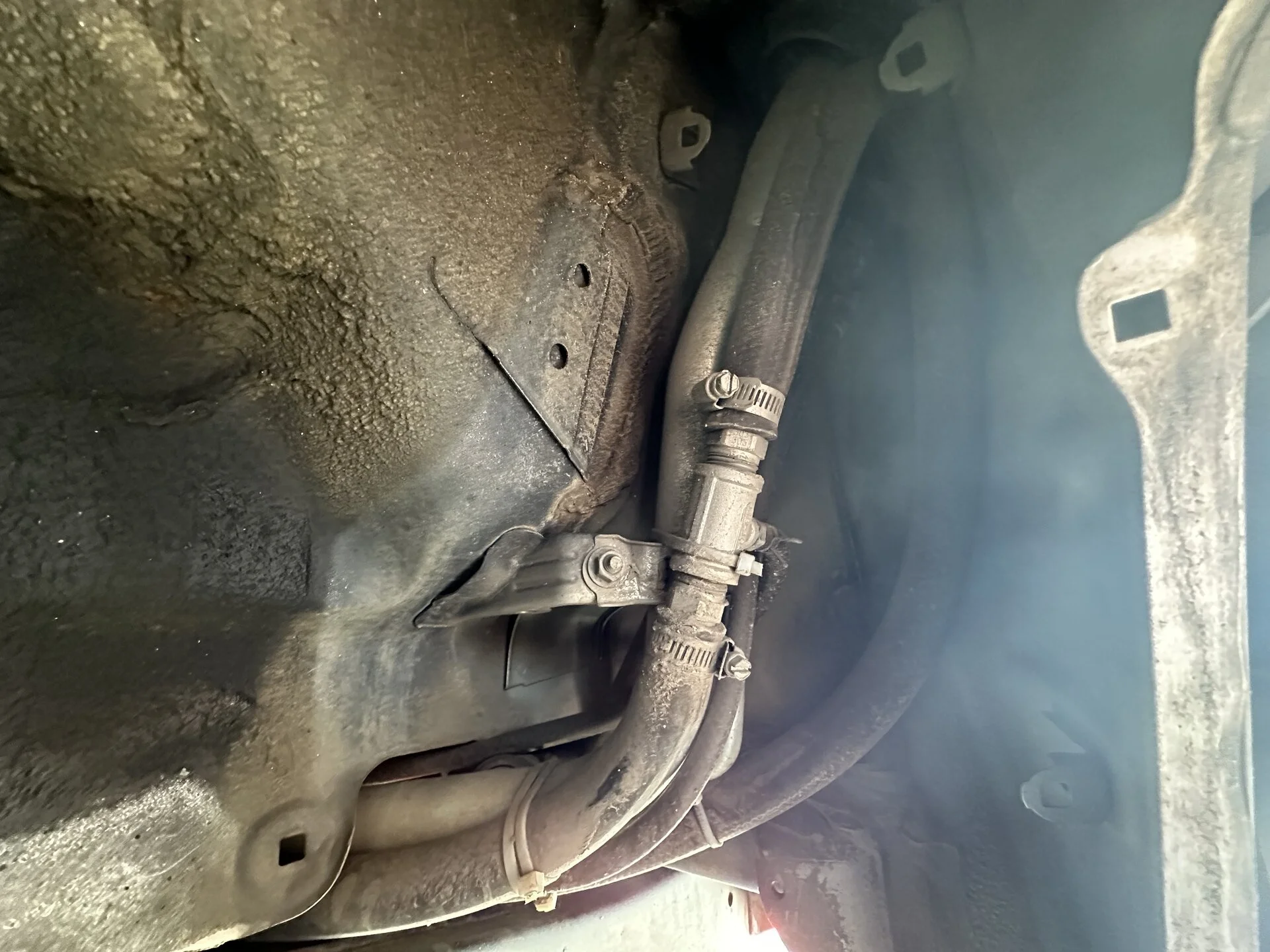

Good question. I am still working through a couple details with the evap system relocation and I’m not happy with the filler hose issue so I’m trying to figure out how to adapt the prado filler hose to the GX tank. That said everything is functioning as it should. No check engine lights, no issues filling (aside from the cost).

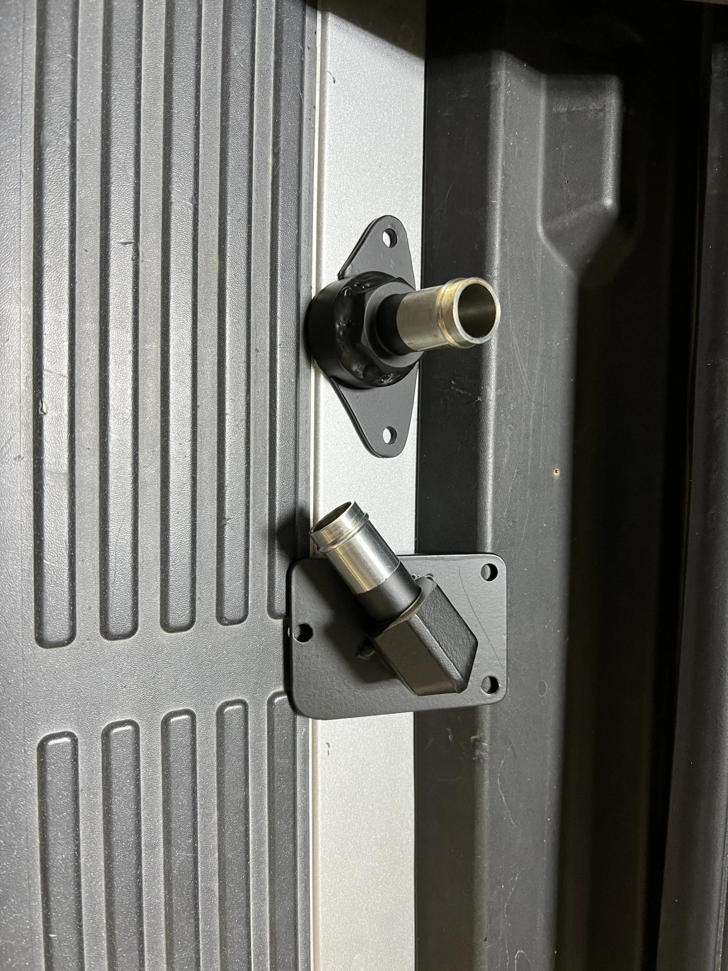

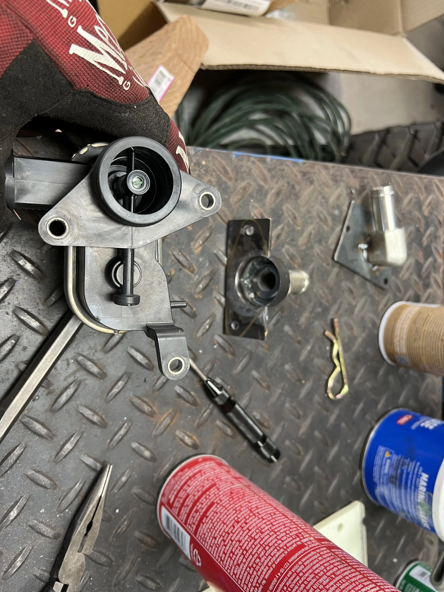

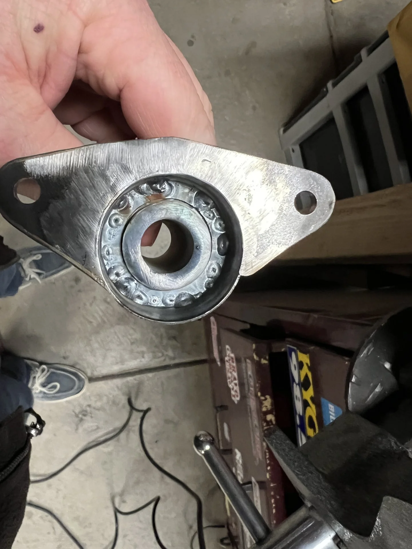

I have been negligent about updating my latest progress. I got the charcoal canister permanently mounted which required remote mounting the vacuum pump/ vent valve portion.

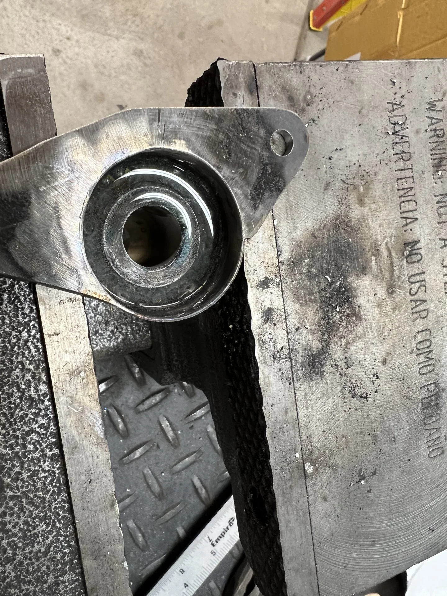

the pump seals to the charcoal canister with a slip/ o-ring fitting, the pump being the male side and the canister being the female. So the new fitting is a 1.5” I.d. Tube cap with a 3/4“ hose barb welded to it.

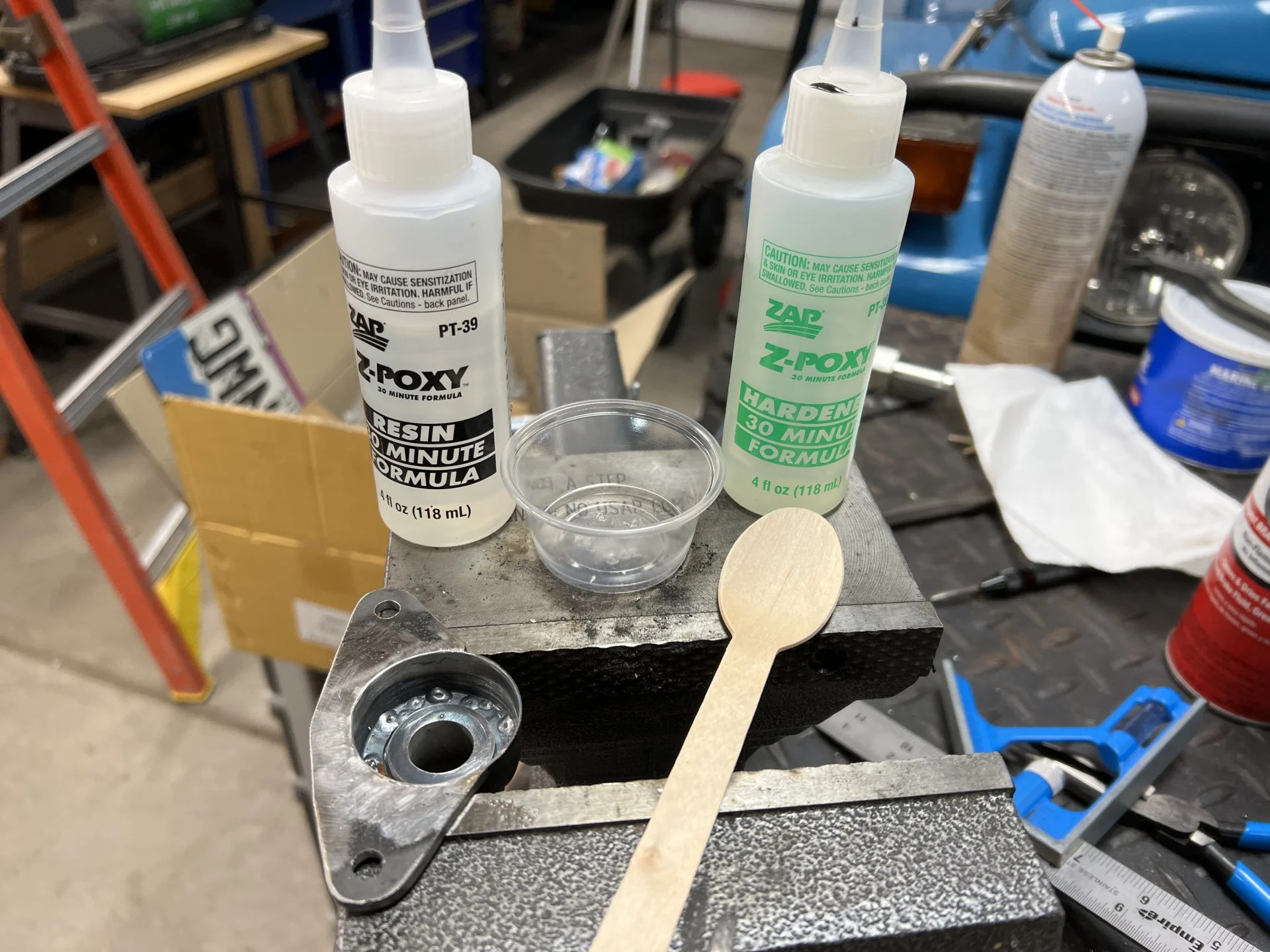

I ordered the tube cap from McMaster and it was pretty thin metal, so when I welded the heavy hose barb to it I had a few burn through. So in order to ensure it was airtight I poured some epoxy into it.
The charcoal canister is a bit easier, just a flat piece of 1/8“ plate with a 90deg 3/4 hose barb welded to it. I welded it from the underside and then ground it smooth.
Here are the two completed fittings

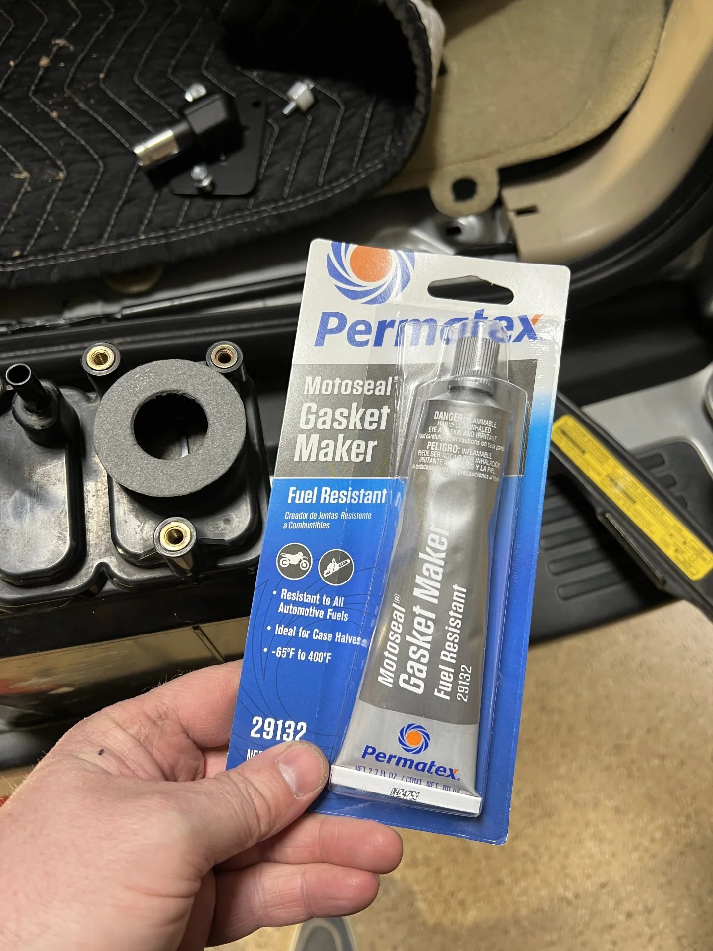

The plate seals to the charcoal canister with a gasket and sealant for good measure

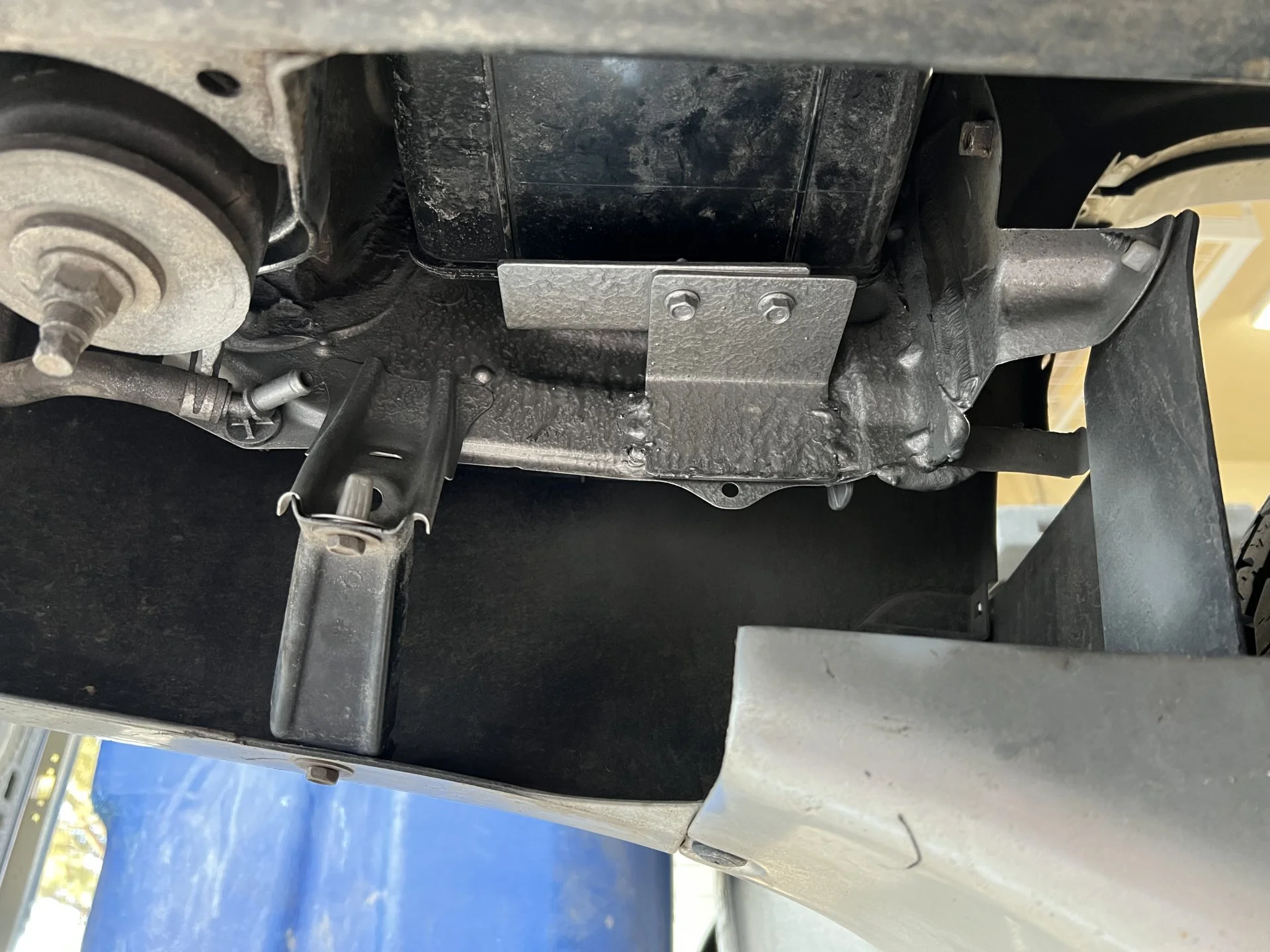

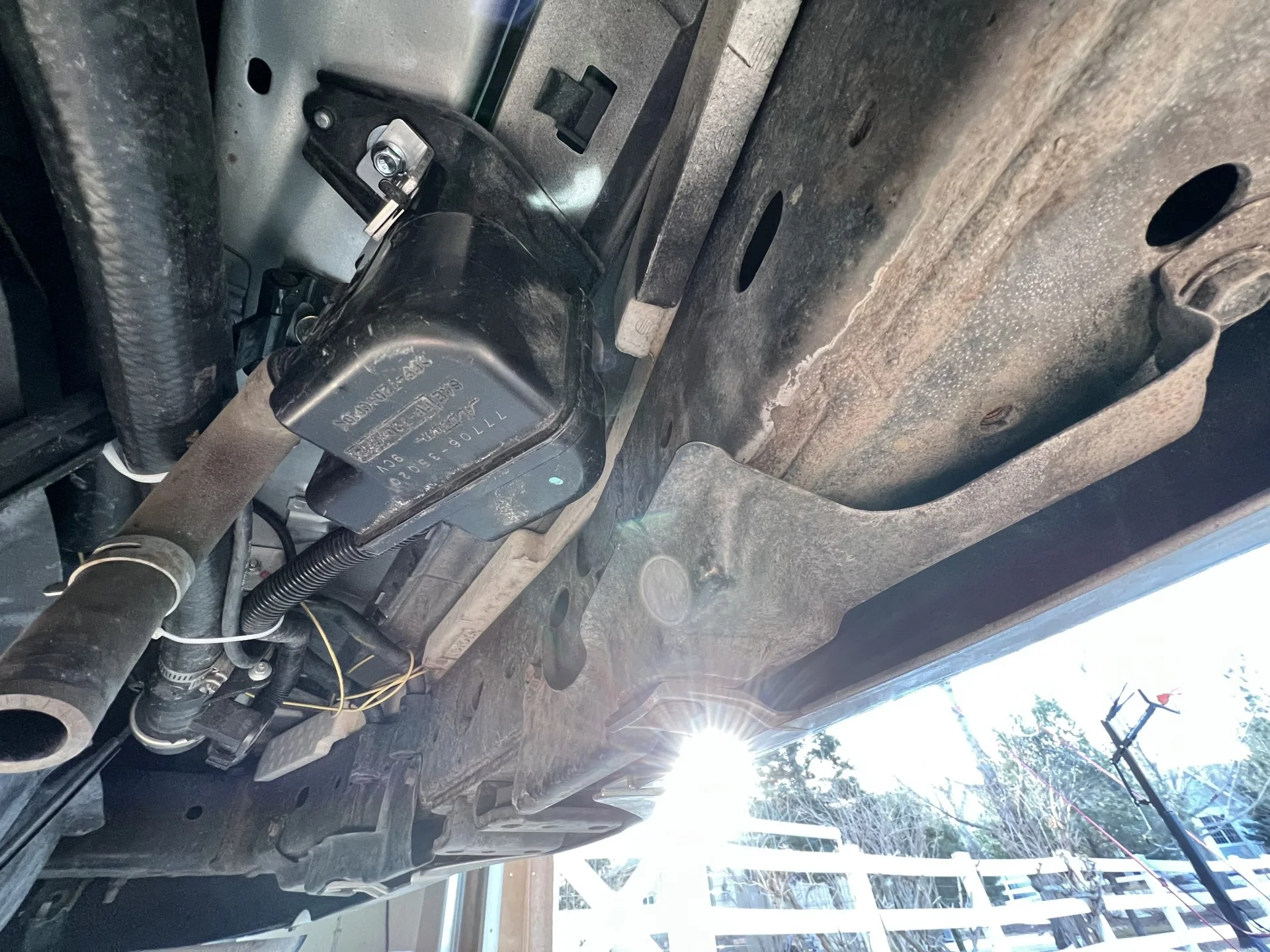

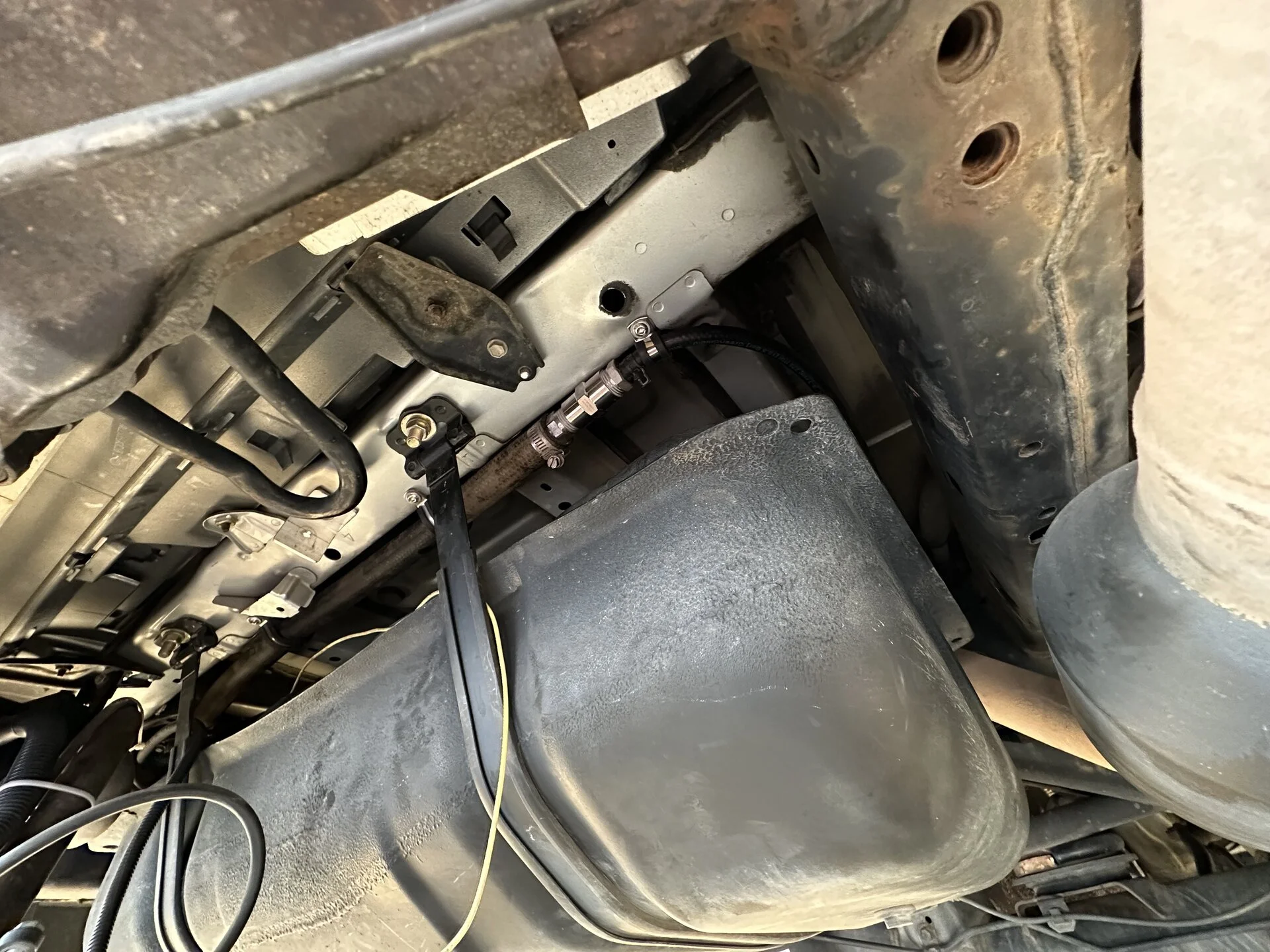

Unfortunately I had to drop the subtank to get the charcoal canister into its final position above the frame rail. Reminder that this is where the air compressor lives if you still have the air suspension so this won’t work if you haven’t converted to coils.

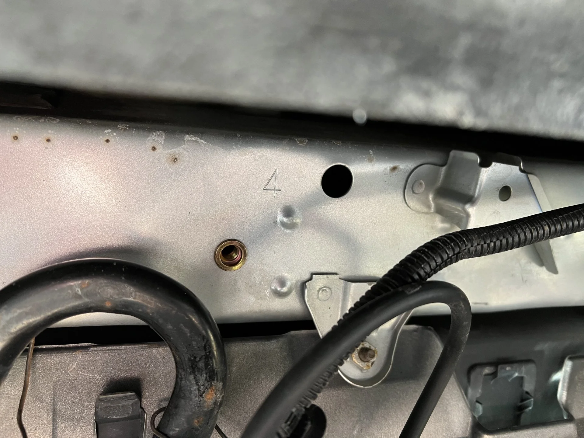

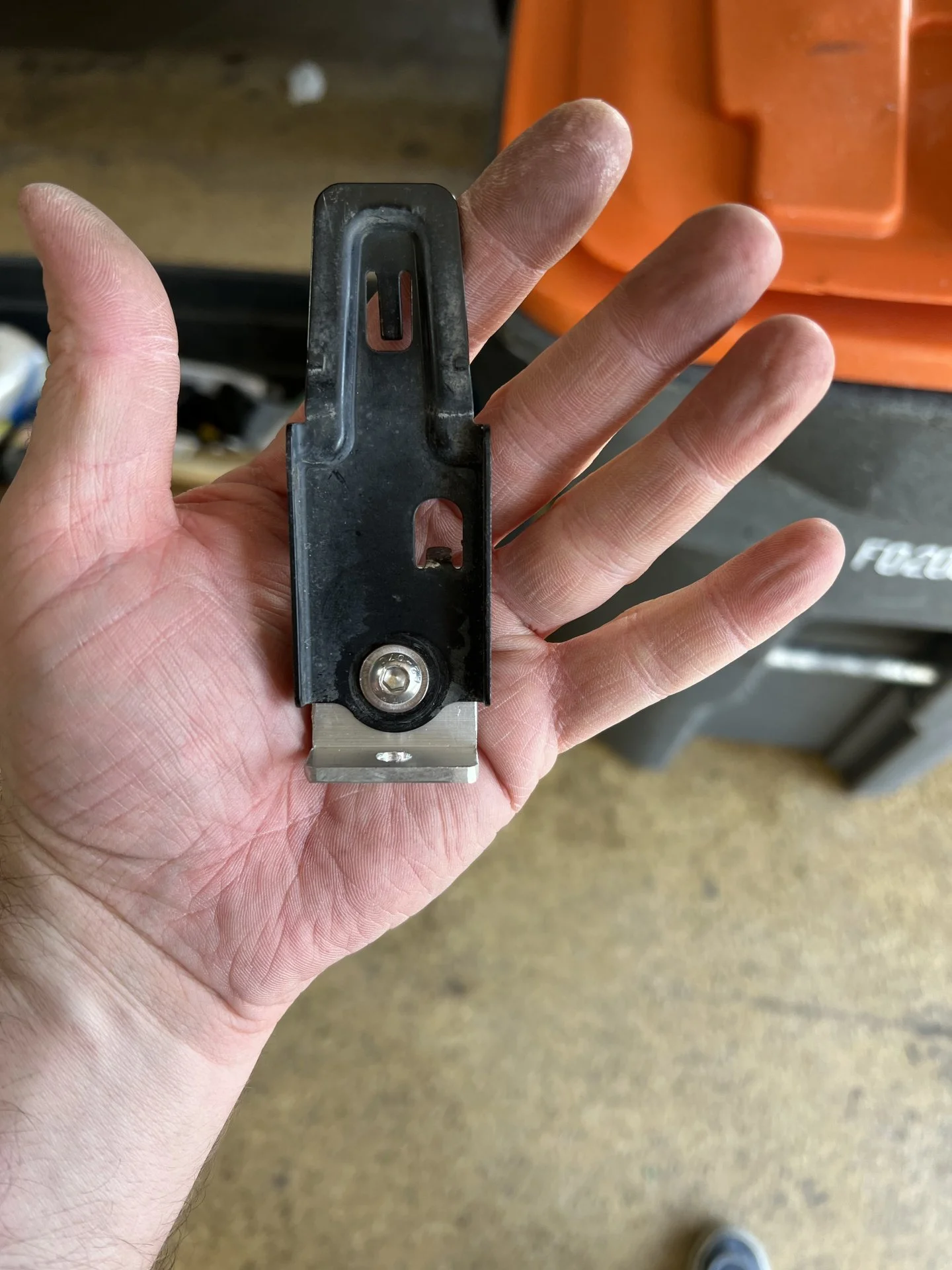

very hard to photograph but the front of the canister mounts with a piece of aluminum angle bolted through the floor with a nut welded on the interior side of the floor.
the rear mounts with a piece of steel angle that’s bolted to the rear of the canister, and that bolts to a piece of angle that is welded to the body.
There is very little room so not a lot of options.

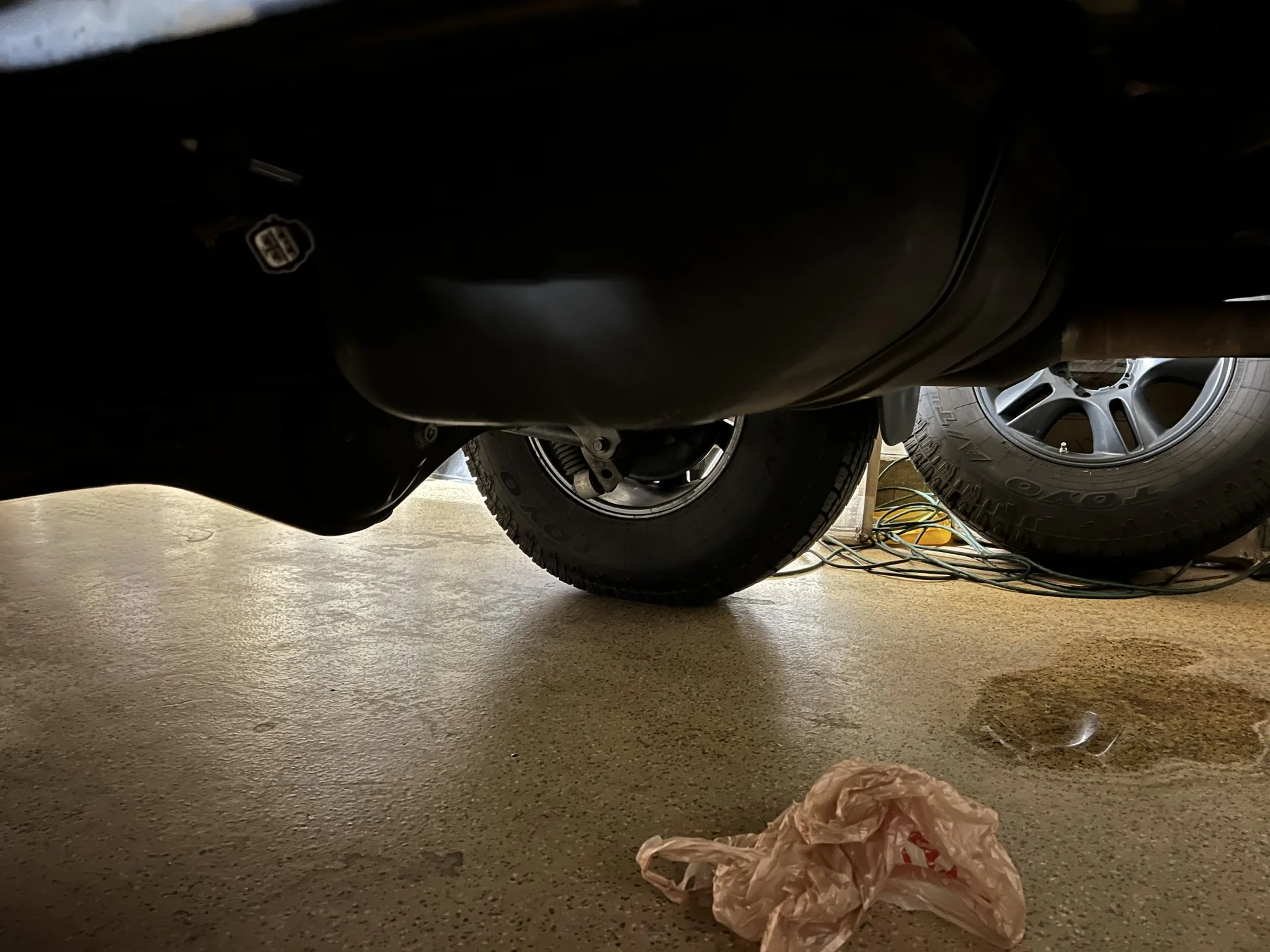

I did a hunting trip and now I'm back looking at this again. Simply not enough fuel to drive a lot, and carrying jerry cans sucks. But I also think this might hang down too much for the kind of 4x4ing I run into around here, a lot of cross ditches and such where I'm dragging the rear end a little.

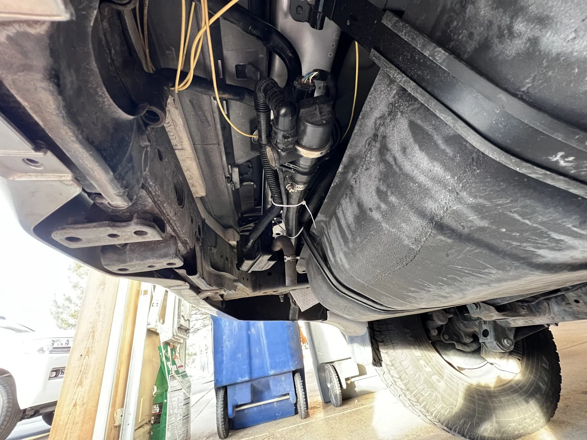

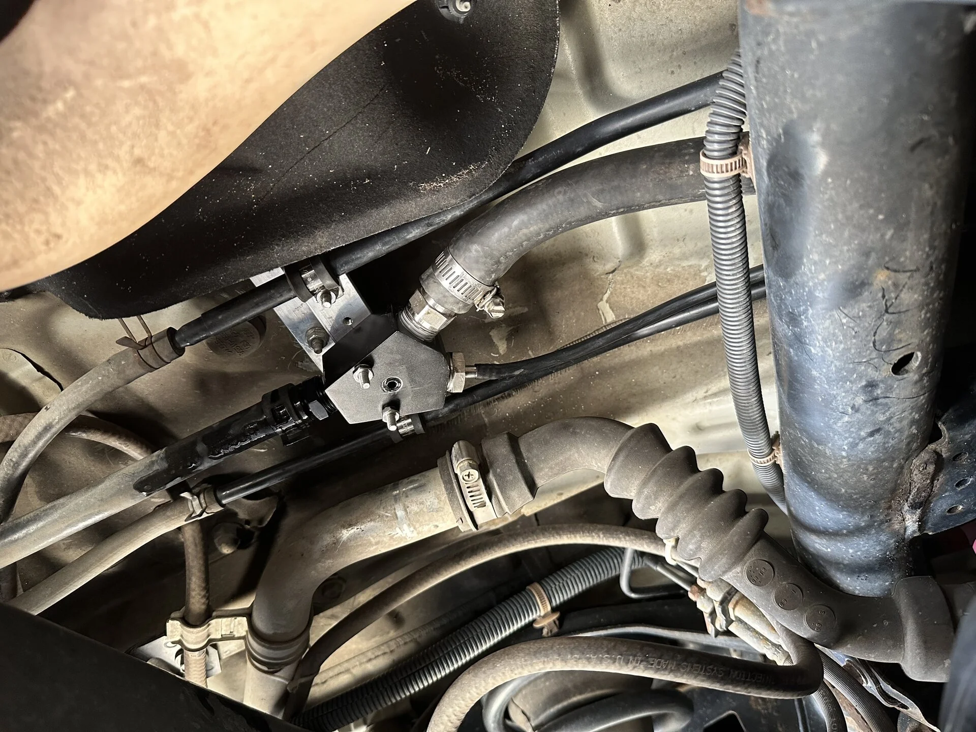

I am a bit late with this update but I re-plumbed the evap several weeks ago to run in series and vent from the sub tank. So far it appears this is the way I should have done it to begin with. With the old setup I was still getting some gas smells in the garage which tells me that fuel was getting into the charcoal canister and a couple times it filled the canister to the point that fuel was leaking out of the vent up by the fuel filler.
Old setup with main and subtank vents teed and into canister. The filler vent from the main tank was tied to the return on the sub tank.
New plumbing with main tank vent and filler vent both tying into subtank return. I used a NPT fuel tee with thread in hose barbs which cleaned up the plumbing quite a bit.
I ran the evap vent from the sub tank the long way around the subtank trying to emulate the 3 sides and down routing that a rock crawler uses for fuel tank venting which is supposed to prevent leaking from off camber or roll over.
