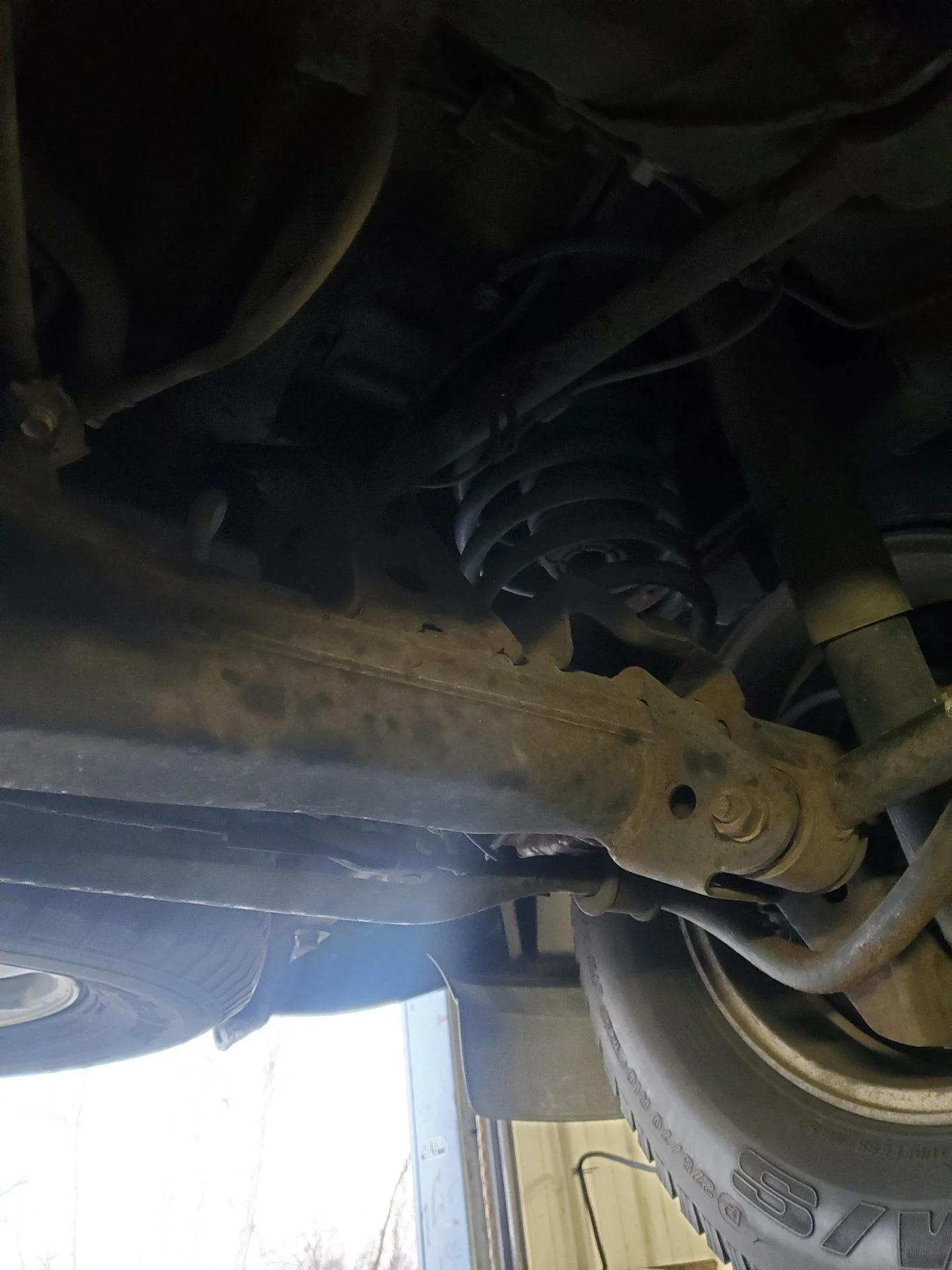

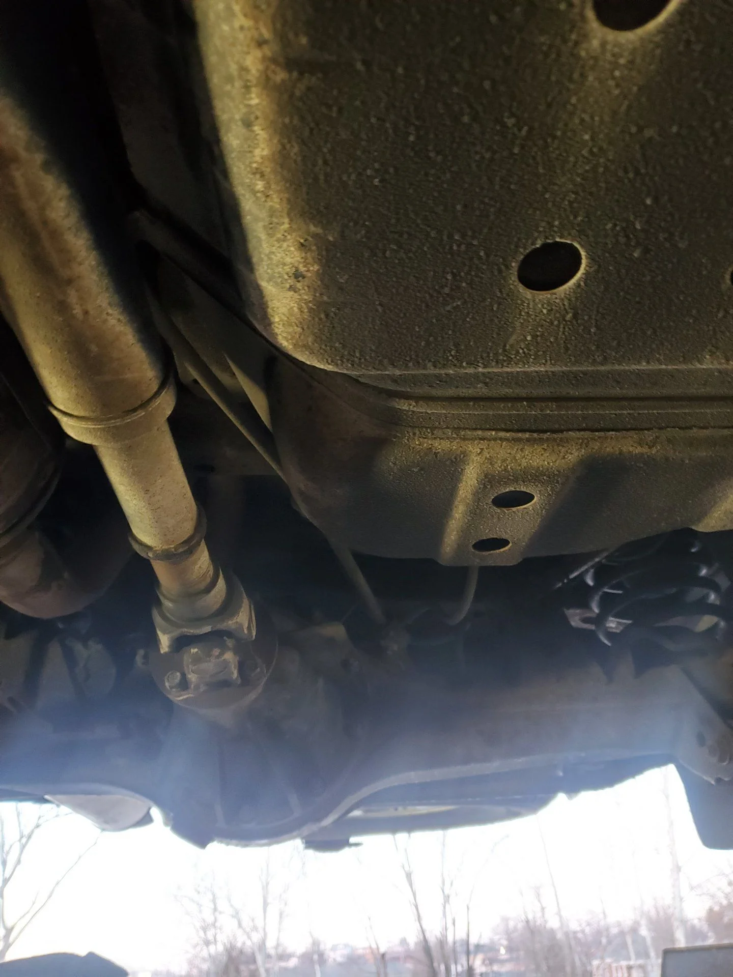

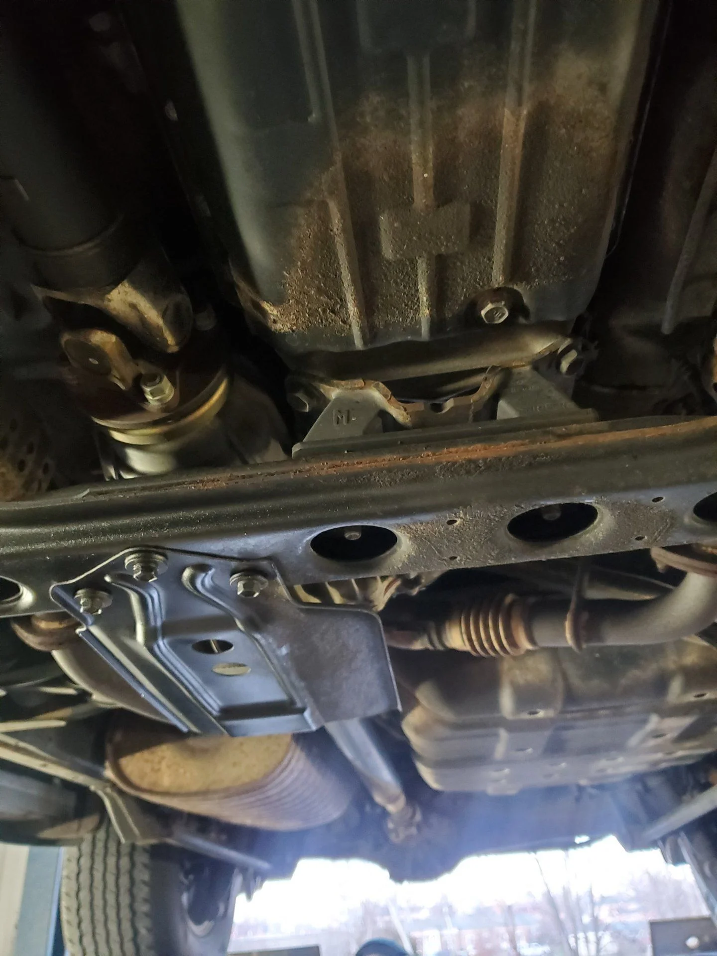

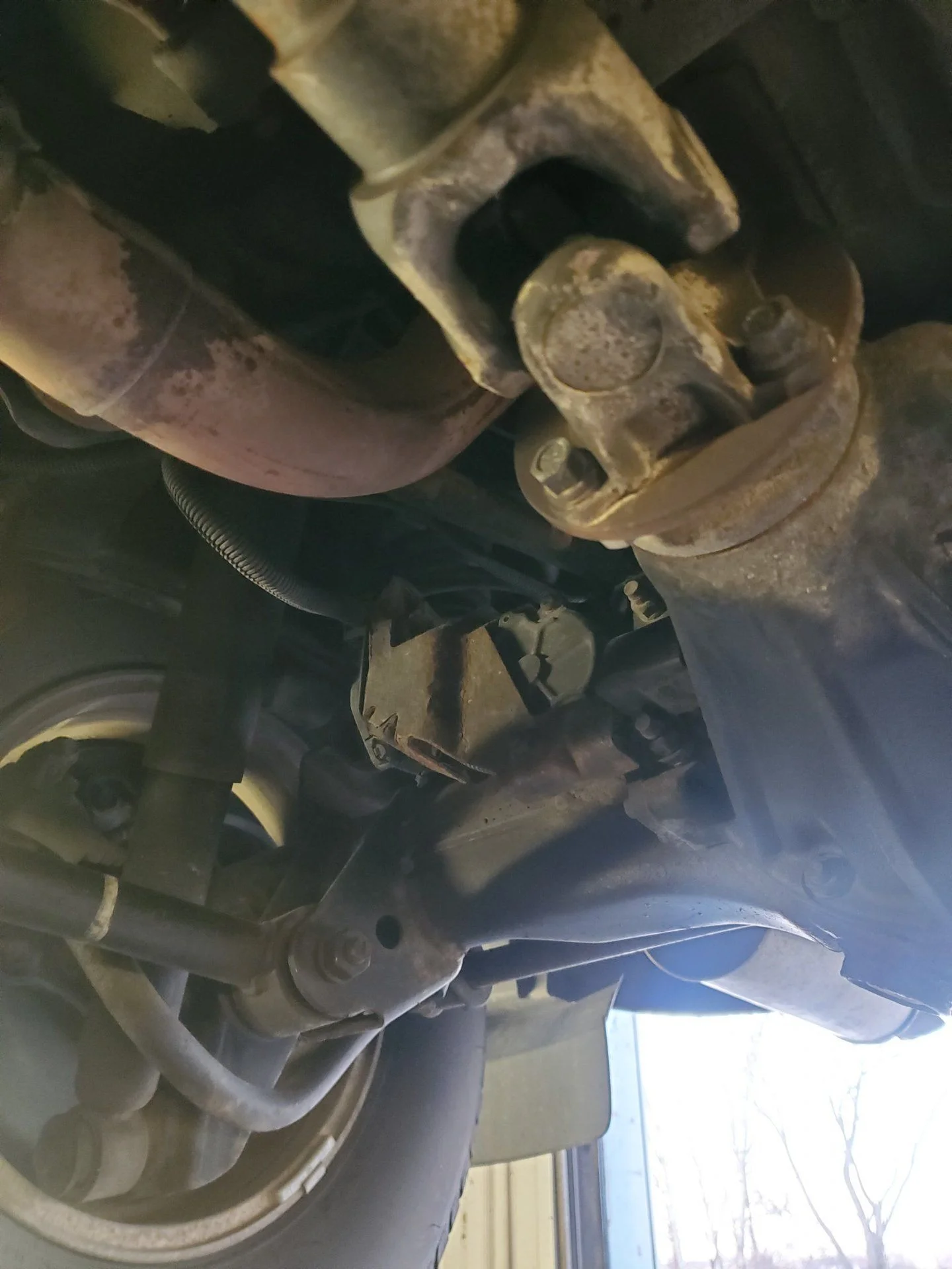

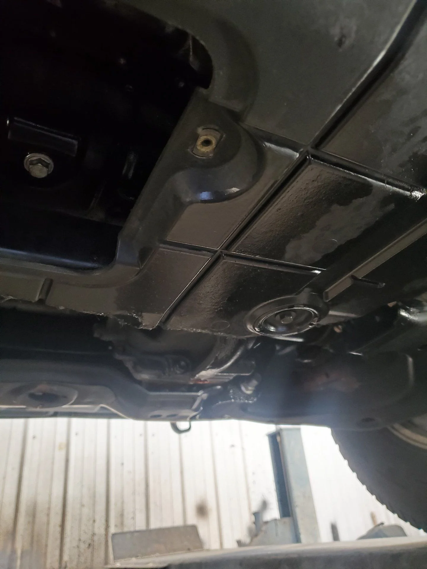

Also attaching underside pictures if folks have thoughts on that -- I'm used to rust in NY but don't have much experience with MO/lower Midwest vehicles in terms of rust. Seems like MO is on the border of the rust belt...

Factory locked rear 98-99 have weaker front ends. 2 pinion vs 4 pinion. Looks like a pretty good leak front passenger corner. Could be many things. Most typical is power steering hoses old and brittle sealing I cut off an inch and use hose clamps seams to slow it down a lot. Worst case a rack or cv’s needing replaced.
Looks very rust free for a mid missouri truck. Must be low miles or it lived much further south than Jeff City.

Thanks all. It’s a mostly MO truck: it was in Joplin for its first four years, two years in SC, then Montana for a few years then back to MO since 09, in Columbia mostly until recently.

I have customers from MN and NY. I have to take deep breaths and prep them for additional cost based on broken bolts. from the pictures provided I don't see that being the case.
The years in Montana and SC make since, looks cleaner rust wise than most I look at in the area. I specialize in 80 and 100 series cruiser. Gray Industries Cruisers.
even as far south as Joplin has more temperate climate with less exposure then typical KS/MO. if you pass let me know contact info. Not looking for another, but like what I've seen so far.
