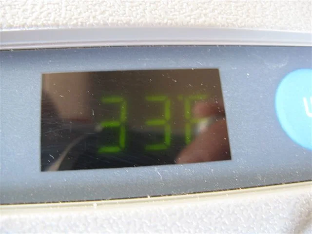

Fridge - Waeco CF-50

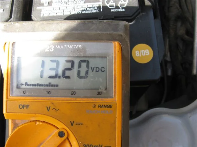

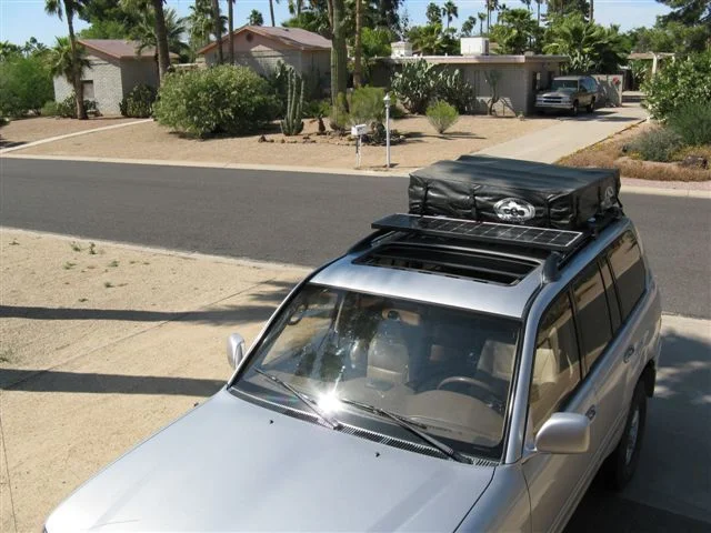

Solar - Siemens 55 Watt panel
Battery - 2 1/2 year old Basic POS Checker Auto
Sitting for 3 days without starting
Fridge set at 33°
Inside temp during day 90°-100°
Battery voltage 13.2 volts
I was going to wait for a week or more but the numbers say it all. The set-up will keep the Fridge at 33° without ever starting the vehicle until the battery dies of old age.
