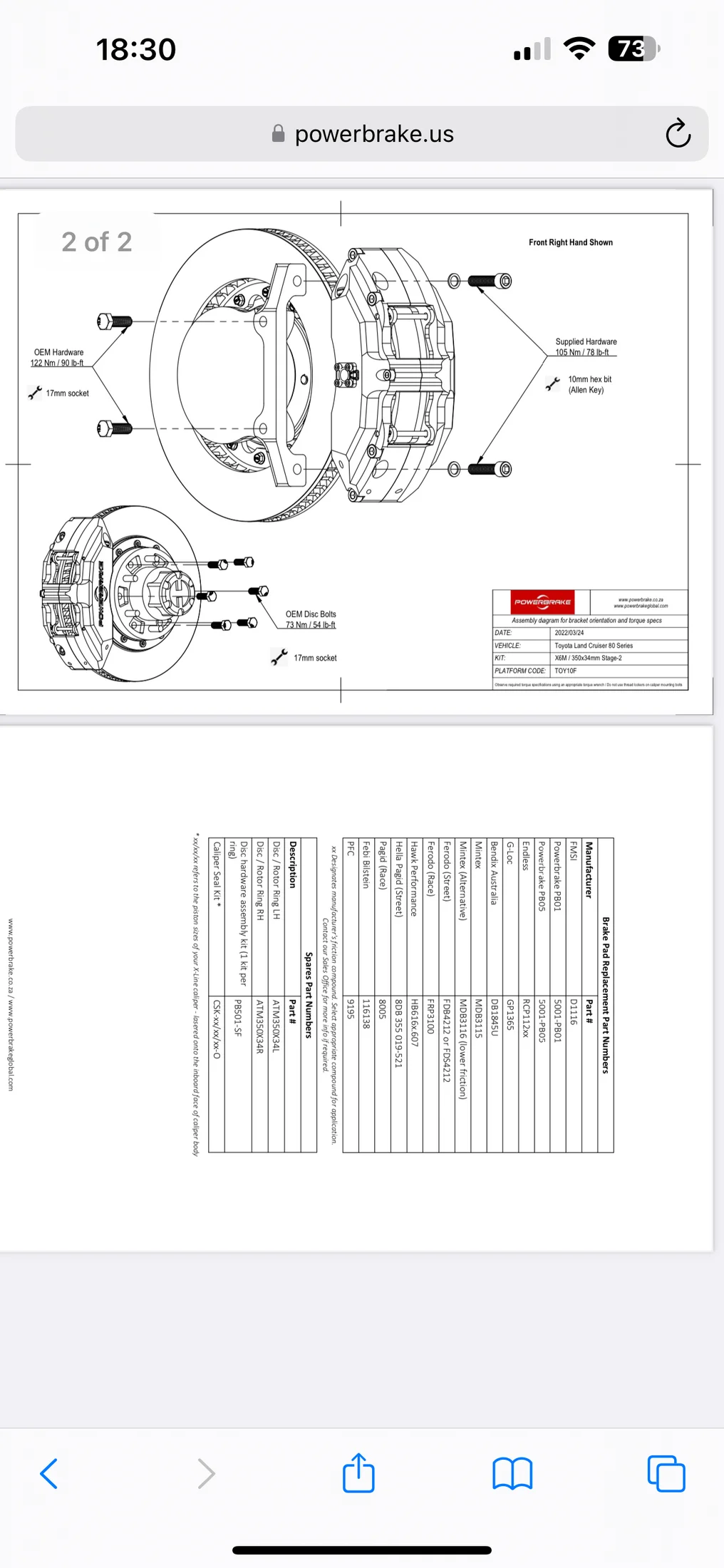

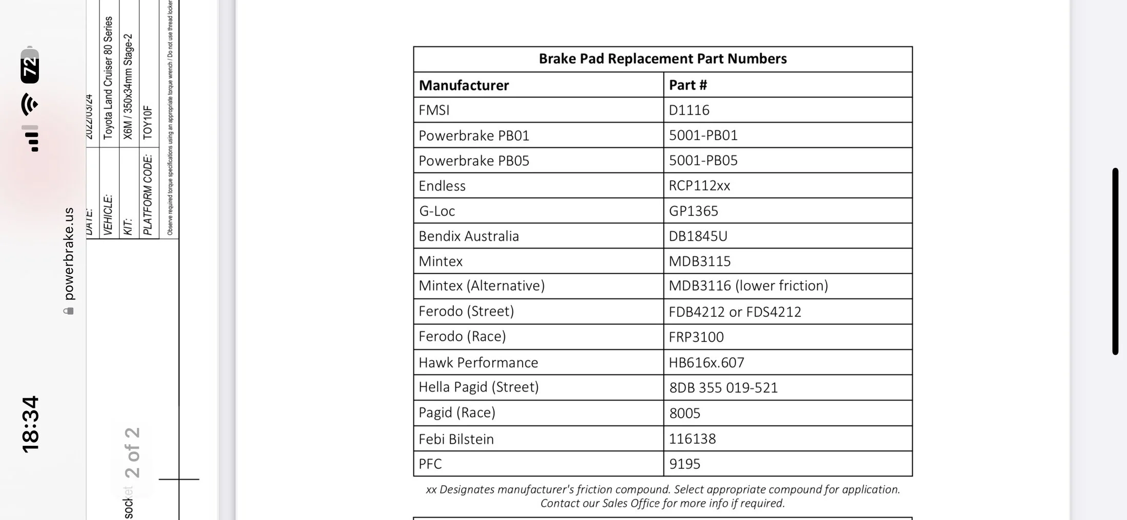

I wanna say Pagid offers pads for this application if my memory of the documents is correct
I would have to double check but I believe the literature that was included with the kit does cross reference brake pads by other manufacturers as possible replacement options.

Does anyone have the correct part # for Powerbrake pads with these? The diagram above mentions 2 options but online both of them (5001-PB01 and 5001-PB05) are stated as NOT working for the 16in kits. I also see no part # for rotors.
Is anyone able to provide?

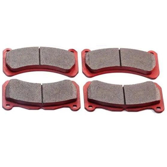

These are the pads:
I don't have the PN for the 16" rotors. I'll find out on Monday.
That diagram that was posted was before the 16" kits were offered.
