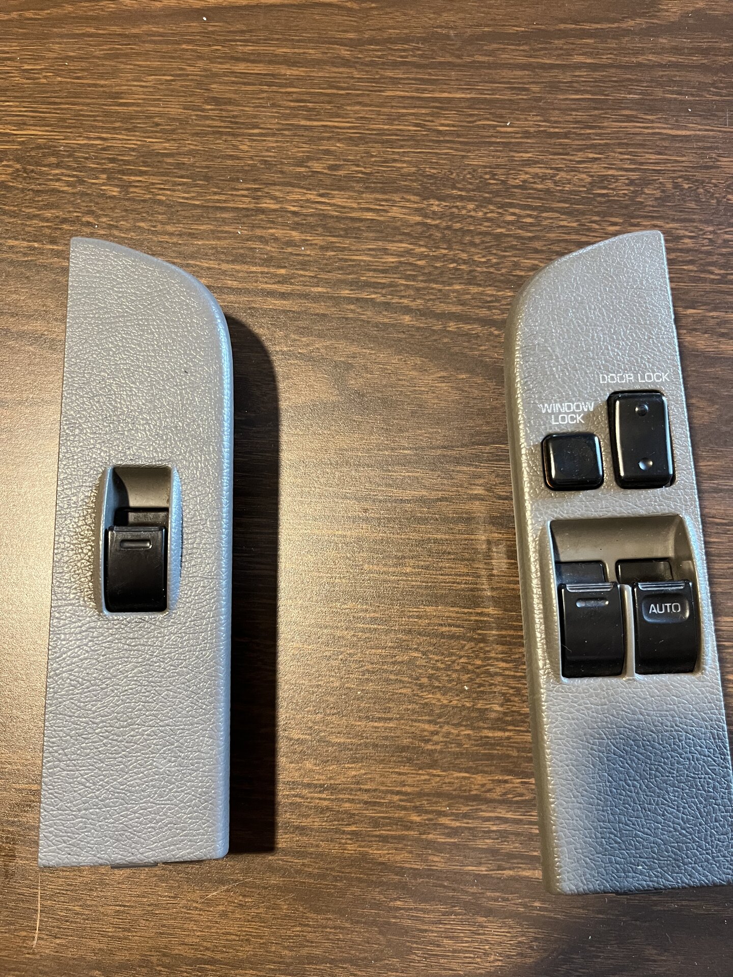

Send pic of each switch. The switches are the same for 12 vs 24V.
From a 24V HZJ73. Had these in my used parts box for awhile. Exactly the same as the ones I had in the PZJ70 I owned.
I could be keen too buy those if you want too sell and i have no luck.. they are identical too mine .. thanks
Try swapping out a switch that works as a test. Then either find a switch at the wreckers or order new switches.
I don't remember how I got them to be honest but I think it was part of a used parts package deal long ago from another mud member. I can't remember if he said that they work or not and I can't test the master switch itself. It won't work on my HZJ77 as the plug in terminals are different.
I would hate to sell off something that doesn't work but if you accept this uncertainly and still want to try, then send me a message.
