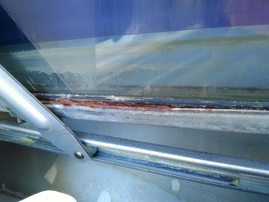

Hardest part to find seems to the bit of metal that the glass sits into that is then joined up to the window raise/lower mechanism. Every time I see a used window glass with the steel bit fitted to the bottom it's rusted where the glass was pushed into it with the rubber strip that holds it together.
Why not buy the whole assembly and be done with it? The Dorman unit I bought is plug and play and includes the regulator and motor. Unbolt the old, bolt in the new, plug it in and you’re done. Not bad for $80 or $90.
It's not the bit I'm referring to. The glass panels have a metal piece that attach to the bottom with a rubber bit to form a 'sandwich' of sorts... Here's a pic of one:
pic page
