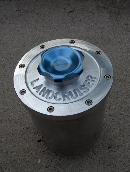

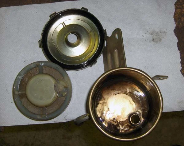

This is a long term project to fabricate a larger power steering reservoir for my 97 cruiser. It holds a quart, quite a bit more than stock. The reason I posted now is I got a bit of a surprise when I opened the stock reservoir and removed the filter at the bottom. There is a good bit of gunk under there as can be seen in the first picture with 60k miles. So when the system is flushed or changed this stuff is not removed. It might be an idea to just remove the reservoir completely off the vehicle and put your choice of cleaning fluid in and shake and drain several times. Just a heads up.

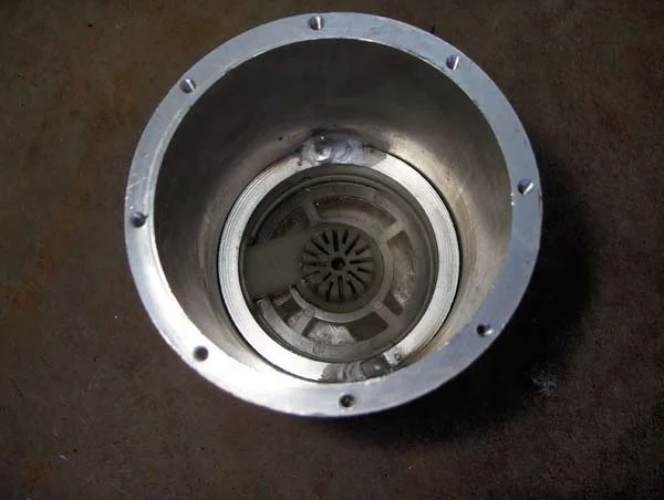

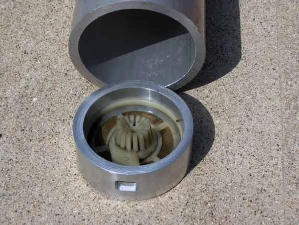

Anyway some pictures of the progress so far. One picture of an adapter I made to just reuse the stock filter in the new reservoir. Another showing the filter tacked in place. The tacks don’t matter as the whole bottom of the adapter is welded. The adapter is also drilled and tapped to hold the filter in place once the reservoir is done. I made the top so it can be removed to take the filter out for cleaning in the future.

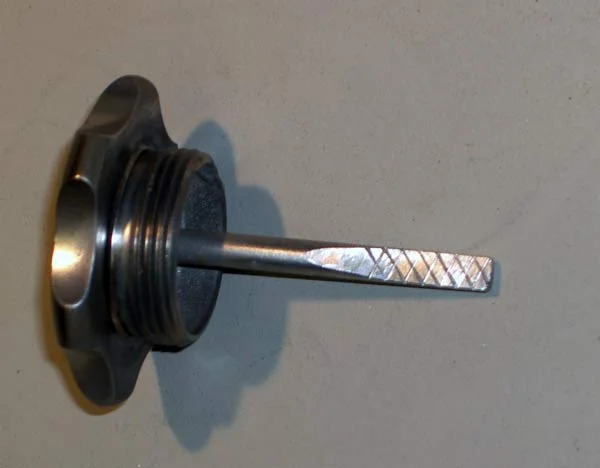

Other pictures showing the top and the dip stick I made so far.

Well being simpleminded I though how easy it would be to just make one. Then the hours turn into weeks into months and then I say - geez I should have just bought one. I really have to give Toyota credit. There are so many hidden details that go unnoticed under the lids and behind panels on these cruisers. For example, the drain tube that feeds the power steering pump sticks up about 3/16" from the bottom of the reservoir. This helps make the sludge accumulate there as opposed to just going down the drain. It makes it much harder then when fabricating because I had to machine the bottom with an extruded boss and it had to be properly oriented with there filter/sieve. The bottom of there filter/ sieve has a female end on it that fits over this extrusion on the bottom so there is much stuff that goes on behind the scenes in these projects.

I have a couple of questions that I would appreciate some thoughts on. What kind of finish do you think would look good on this when its done. I am not into bling so was thinking just a clear coat with maybe that cap a different color. It is aluminum so anodizing is an option in a few colors, or powder coat.
Also, what happened is I machined an adapter to use the stock fill cap; then changed my mind and went with the screw in cap with o-ring. Unfortunately, these things do not have a vent so I am going to drill a small vent tube in just where the filler tube meets the lid. Since the tube will have a small vent hose coming from it this hose should face the engine. Anyway before this vent was needed the top with the engraving could be oriented in any direction since the bolt holes are even. Now I have to decide what direction I want the engraving to read; from the front of the engine, or from the side over the fender. I know, just a little thing, but you know how it goes. What do you think.

Bill,
it's great, I would do the lettering facing forward as well.
