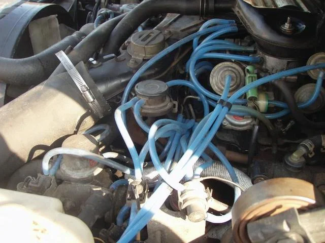

From Cruiserhunter, "Ok so here is my contribution to the forum. This community has helped me more times than I can count and I'm sure that will be true for a long, long time.
Much Thanks to Archie and Rob(Chitown) with out both of these people I would not have been able to do this.
So my Power Steering Pump up and started leaking all over the place. It was groaning and giving me virtually no help while driving. so after advice from the forum I attempted to rebuild the pump with a kit from Cdan. Well, that failed rather quickly with the rebuilt pump leaking almost immediately.
So I bit the ~$300 bullet and got a brand spankin new Power Steering Pump From CDan. Here is the install:
Tools:
You really don't need anything extensive. Here is what I used minus, Archie's BFH and various long pieces of iron.
