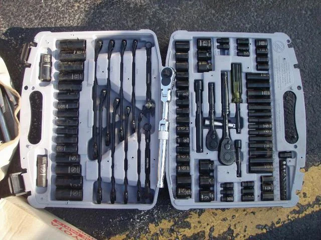

Tools:
You really don't need anything extensive. Here is what I used minus, Archie's BFH and various long pieces of iron.
TOOLS PIC

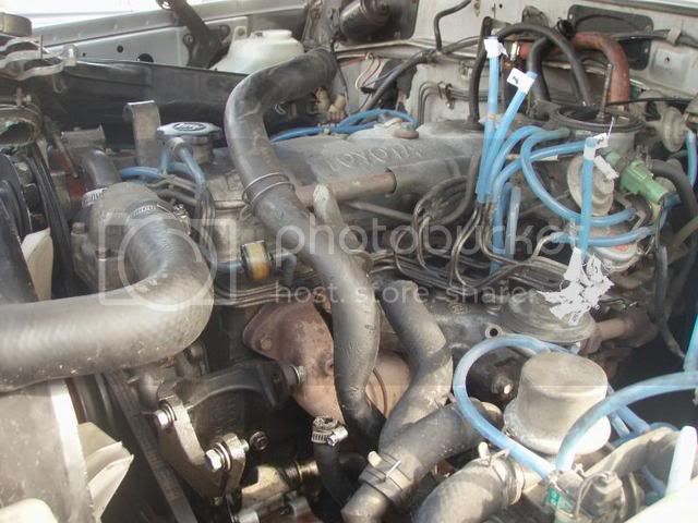

1.This is a smogged 1986 FJ60 so the first thing you have to do to get access is get all these vacuum hoses out of the way.
ENGINE SHOOT

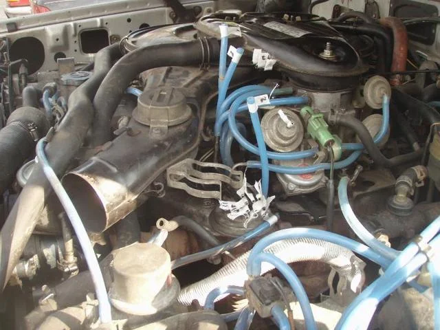

2. I numbered the hoses and the nozzles cause I did not want to screw up the lines. You don't have to do this, i just gave me piece of mind.
VACUUM LINES WITH TAPE
3.Next you need to remove your intake hose, air filter assembly (10mm bolt on carb, 12mm passenger side), and two large black vacuum hoses(Flat head :
AIR FILTER OFF, HOSES

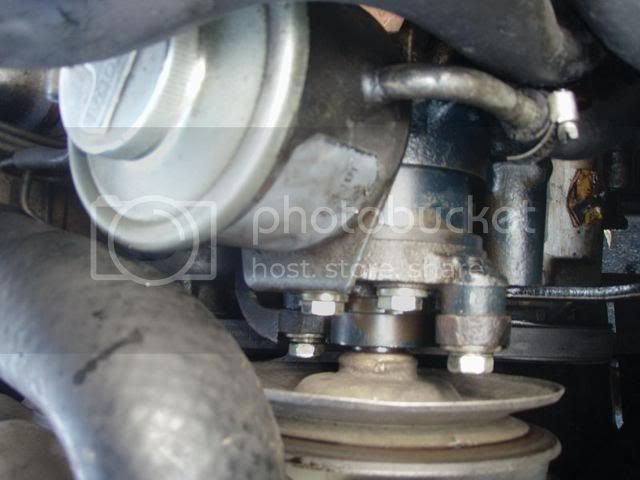

4. Now you can remove the High Pressure hose 17mm:
PRESSURE HOSE

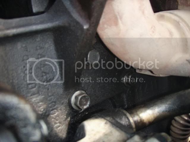

7. Now here is the hardest part of the install/reassembly. You must remove the 5 bolts that hold a bracket that holds the Power steering pump to the engine. It looks like you could just remove the bolts holding the PSP to the bracket. The front two come out easily. THe problem is the one in the back. THe bolt is too long and because the exhaust is so close you will be unable to back it out enough to pull out the PSP. You can try and get a saw in there and cut or you can try and remove the exhaust manifold, but I didn't want to try either of these. So you have to get an angled ratchet and get under there. Here is a picture of the 4 passenger side bolts. There is one in the front as well. This took the longest.
BOLT PICTURES
8. Now if you have gotten the bracket off, Congratulations. Now the PSP is sitting in your hands. To make your life infinitely easier grab that bolt that could not be backed out enough and grind it down. Get it short enough the work in that small area.
