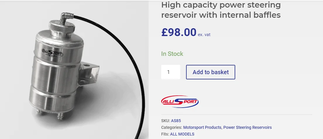

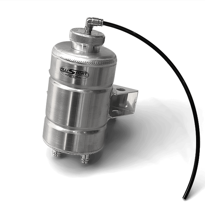

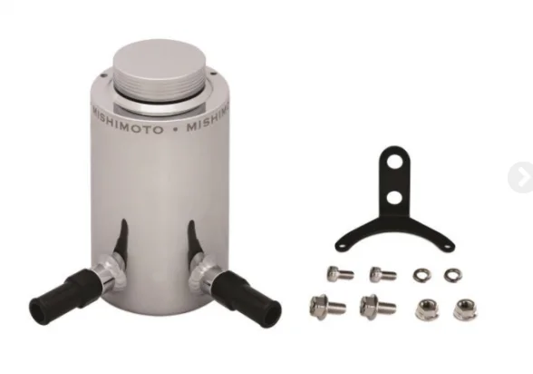

Lots of good info in this thread. Has anyone tried a PS reservoir that is larger or has a cap that is designed for severe duty use?
I'm finding that my style of off-roading in swamps and mud may need an enhanced PS reservoir. I have everything enhanced with differential breather extensions and snorkel. I'm finding I may need to use a larger reservoir that's designed for severe duty. The Nishimoto was the first product on the search.
I'm looking for suggestions.
I like the looks of this product. I could run the breather tube up and into the diff breather filter junction that's at the top center of the firewall. One of my problems is from mud being sucked into the PS reservoir.
Just thinking about alternatives for severe duty.
