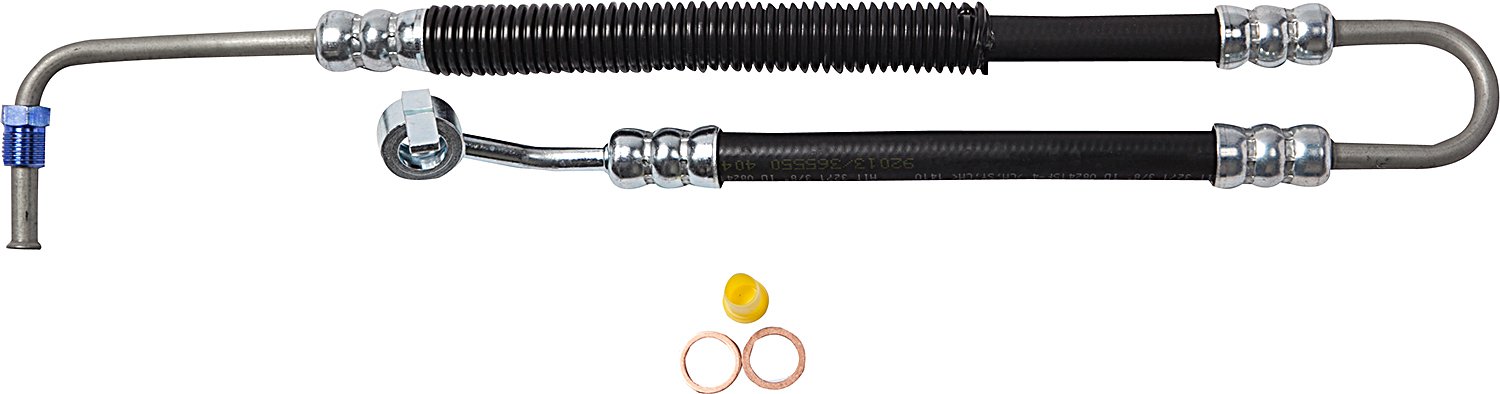

Yeah the high-pressure line does not have clamps. It's a crimp fitting that looks like this:
