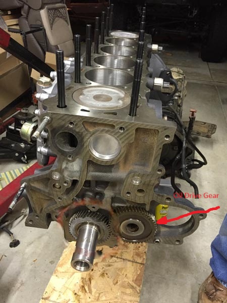

Replacing the oil gear is a significant engine tear down. The front cover needs to come off, which means the head needs to come off. Some people have managed to pull the cover without removing the head, by removing oil pans and the lower studs, but I'd worry about resealing the against the head gasket.
In addition, the oil gear rides inside a brass bushing which is pressed into the block. If that bushing gets damaged, it is not serviceable by Toyota. There are a couple aftermarket suppliers so you don't have to buy a new short block :oops:.
