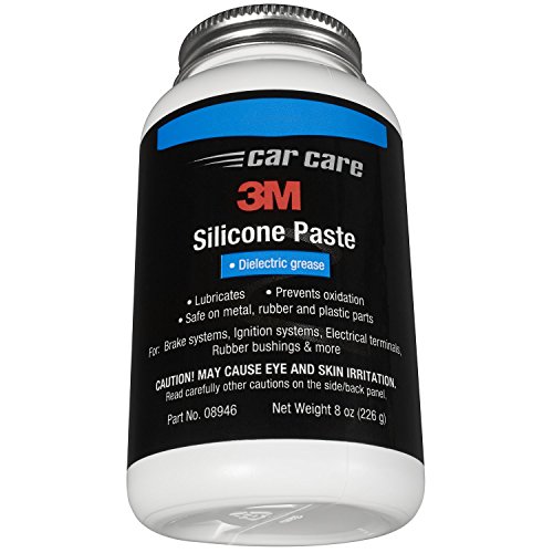

I've been using 3M silicone paste to lubricate lines before pushing hoses on. It made 3/8 go on quite easily. No subsequent leaks in my low pressure power steering hose or transmission cooler hoses.

That 3m paste that GummyCarbs posted was a game changer. I'm going to start using it on everything. EVERY. THING.
I bought one of the $30 aftermarket coolers from autozone and some extra 3/8 hose and just bypassed the old paper clip cooler. I wish I had noticed the 3M paste! I just used some of the thick Lucas power steering leak stop to lube it up. Got it on far enough to put the clamp on. Good enough for me right now. No majors leaks as of yet.
