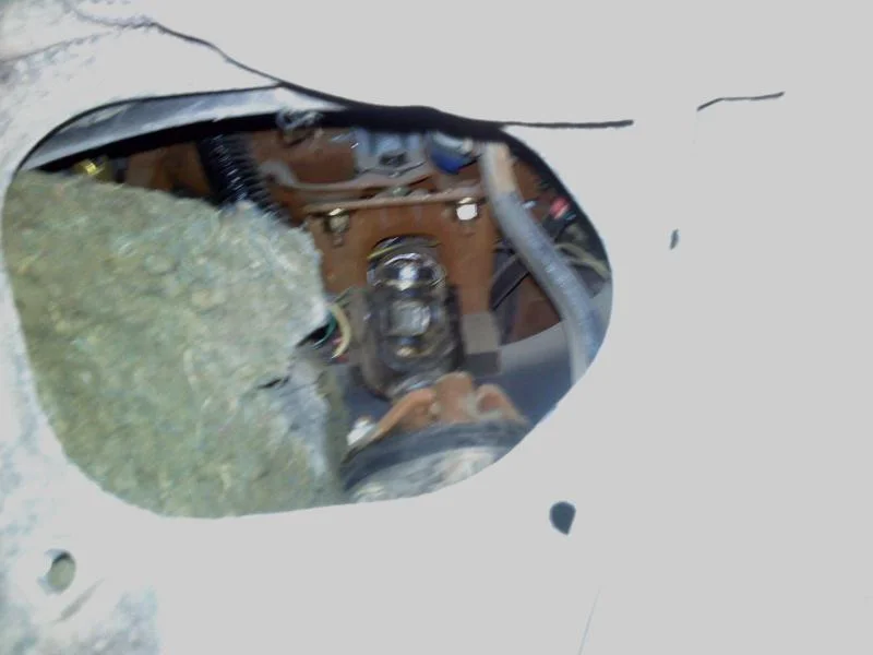

And a few more pics of the firewall opening for the intermediate shaft...

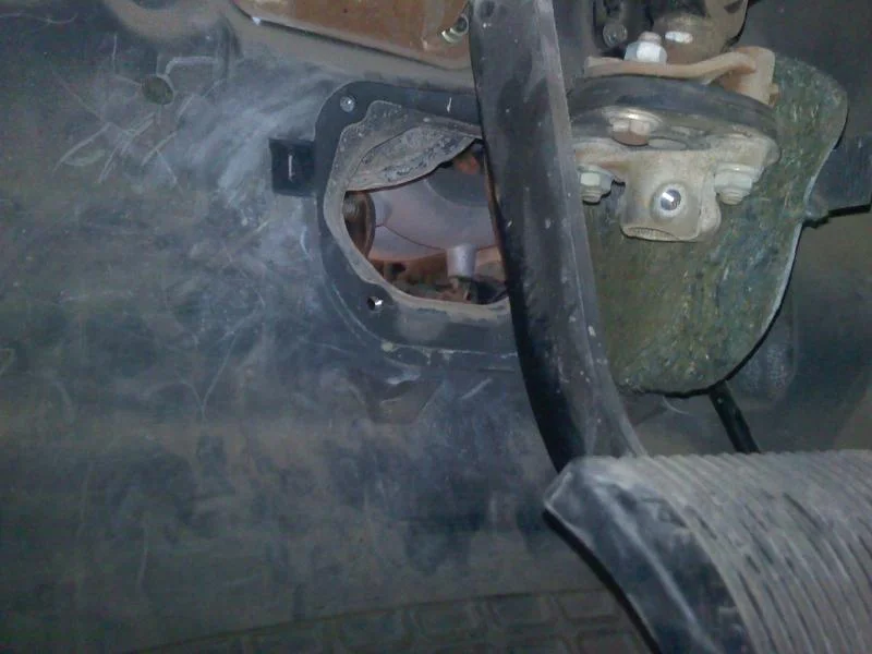

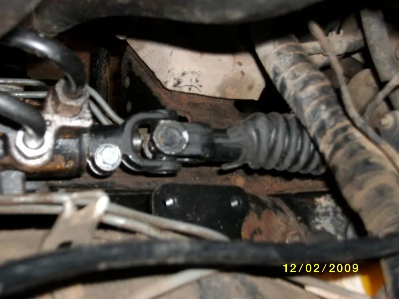

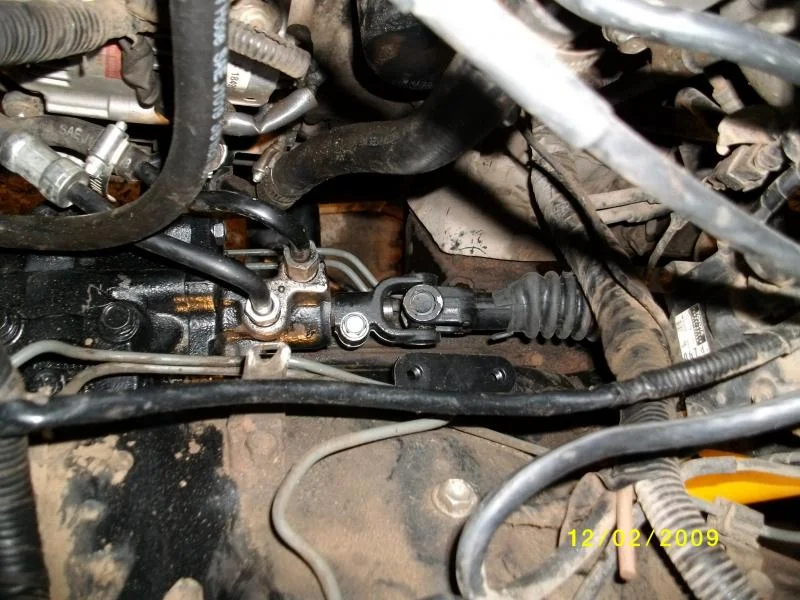

Installed the firewall seal, installed the intermediate shaft to the main shaft, then the intermediate shaft to the ujoint up by the input to the gear box. New hardware (the hardware is unique to this application--they are small bolts that actually have serrations that twist on installation--sort of like wheel bolts for the hubs--anyway, I needed three of these--I recommend replacing these and not reusing the old ones). I also ordered a cool FJ60 steering part to install on my rig--it's a medium sized rubber boot that was used on FJ60/62's. I put it over the front of the intermediate shaft and over the upper section of the ujoint. Real nice weather protector.

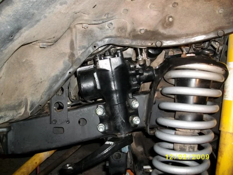

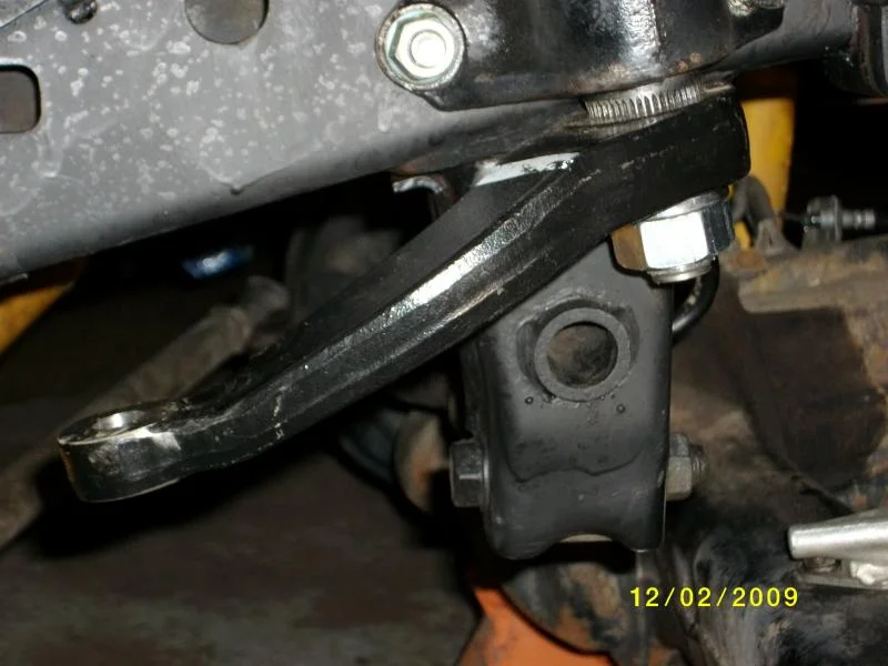

Installed the gear box to the frame: 105 ft/lbs on the nut side/17mm socket. These nuts and bolts are factory pre-coated--sort of the same color as the OEM drive shaft bolts that come pre coated. Then the pitman arm.

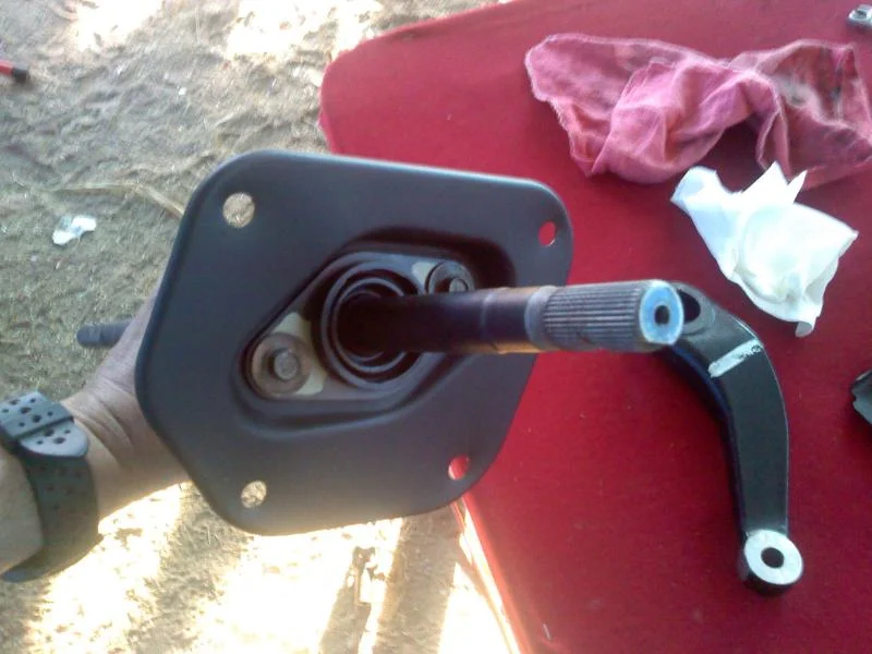

This was a bit more tricky because I had to line the match marks up, then place the box parallel to the frame (with the ujoint/shaft uninstalled). Then I did a test fitment and put the pitman arm on and with the steering wheel counted how many times from lock to lock, divided by 2 and the pitman arm should have been lined up where I had lined it up. It was which mean everything is good in terms of steering wheel/pitman arm alignment.

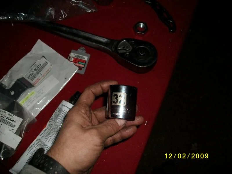

Pitman arm nut is torqued to 130 ft/lbs. I used a regular 1/2" ratchet with a 12pt 32mm socket to get it down onto the shaft and to push the arm onto the sector shaft. Once I was pretty tight (probably about 110 ft/lbs or so), I used my torque wrench for the rest of the way on. 130 ft/lbs is tough on the shoulders! :)
Then the installation of the high pressure line and the return line, put the shield back on and she is good to go for some fluid now. I'll be doing the fluid/bleed once I get the whole front end back together with the manual hubs.
In any event, hopefully will last another 220K miles!! Check another project off the list. Now, off to test the sucker this spring...
